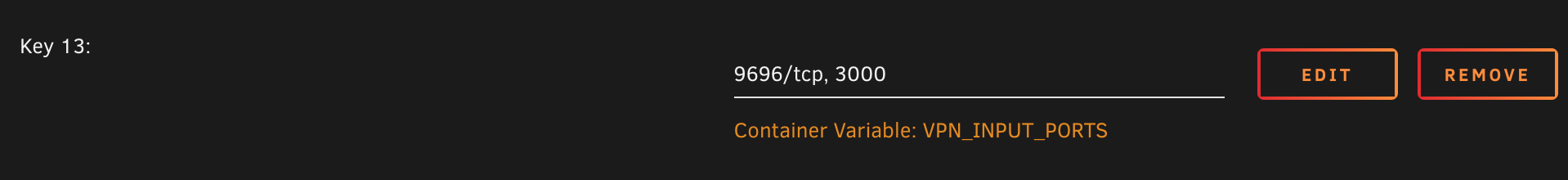

  7. I changed from UDP to TCP. For Key 13, do I need to put "9696" or "9696/tcp"? Okay, so I tried setting Prowlarr's WebUI value to a few different things but none of them worked... "http://localhost:9696" - "localhost refused to connect" "http://localhost:[PORT:9696]" - "about:blank#blocked" "http://[localhost]:[PORT:9696]" - "about:blank#blocked" Or when I just type in my servers IP plus the port in my browser's URL ("http://192.168.1.3:9696/"), I get a "took too long to respond" error.

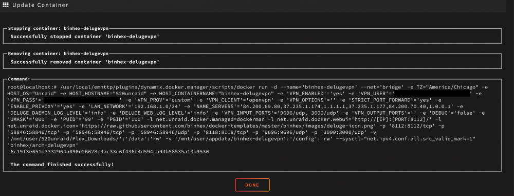

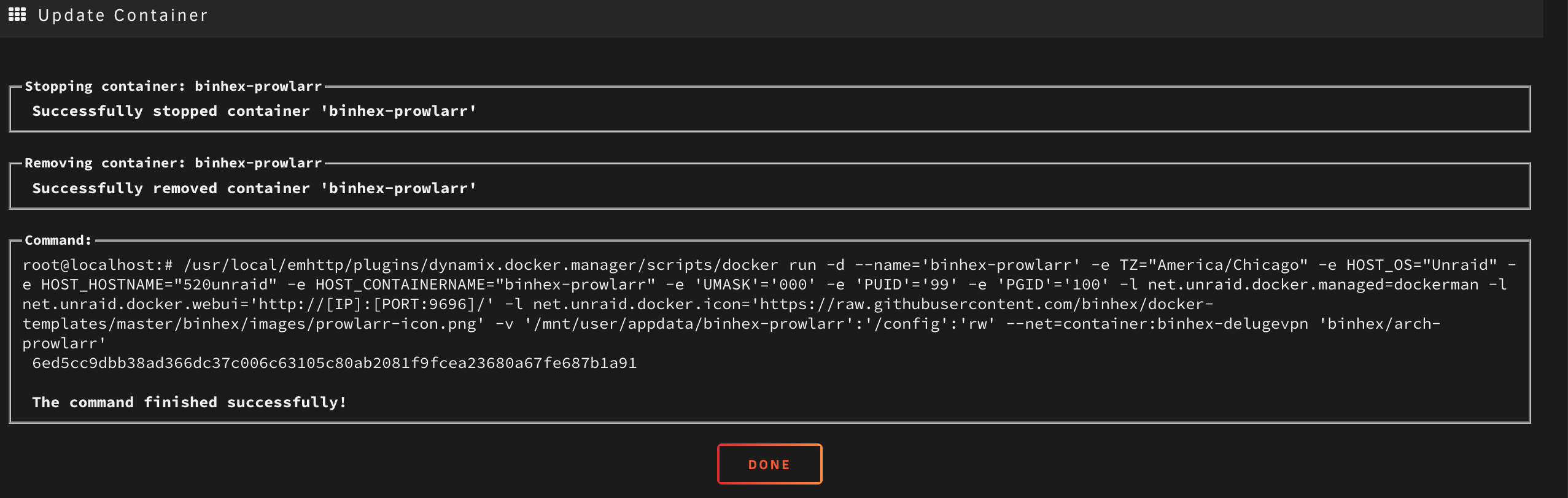

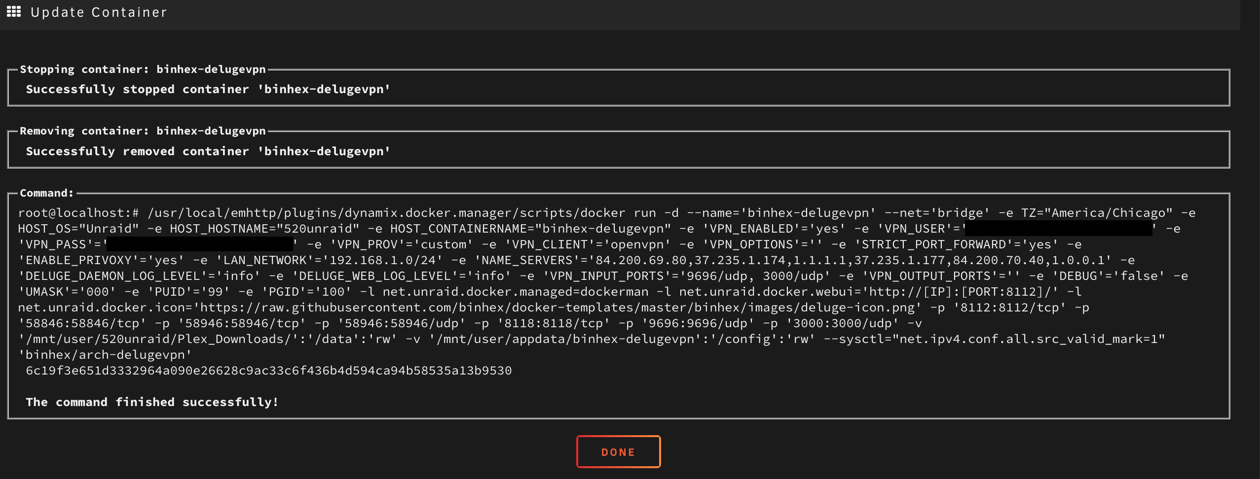

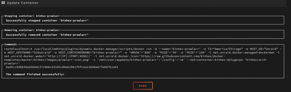

  9. Here's the docker run command. I found the same issue with other VPN containers (OpenVPN) and with trying to route other apps (Firefox) - the WebUI works when the net is bridged but doesn't work when routed through the VPN docker. Here is docker run for prowlarr Here is docker run for binhex-delugeVPN

  11. Hello. Unfortunately, I am another poor soul who is having issue accessing their "arr" (Prowlarr in this case) WebGUI after having routed it through DelugeVPN. My specific issue is when I try to open the WebGui, I get "about:blank#blocked" instead. I believe the docker is being routed properly as I can use prowlarr's console to "curl ipconfig.io" and I get the same, VPN-ed IP Address as DelugeVPN. This issue is consistent from two different PCs (on chrome), it happens on my iPhone on wifi (using Brave/chromium), and on my Pixel (using chrome on wifi and on cellular). I followed BMB's video and SIO's video as well as making sure to follow Q24 and Q25* from this FAQ (although, I didn't really understand what this portion meant: In DelugeVPN, I have: VPN enabled (I use NordVPN) my username/password enable_privoxy: yes LAN_NETWORK: 192.168.1.0/24 VPN_INPUT_Ports: 9696 (this is what Prowlarr uses) as well as an added port with container port and host port being 9696 (UDP) (and adding in NordVPN's ovpn file into the app data openvpn folder). In Prowlarr, I set: Network Type: None extra parameters: --net=container:binhex-delugevpn And I deleted the port 9696 setting. I'm not sure if my issue is a missed setting, something with Q25 that I didn't understand, or something else entirely. Any help would be very much appreciated. Thanks!
