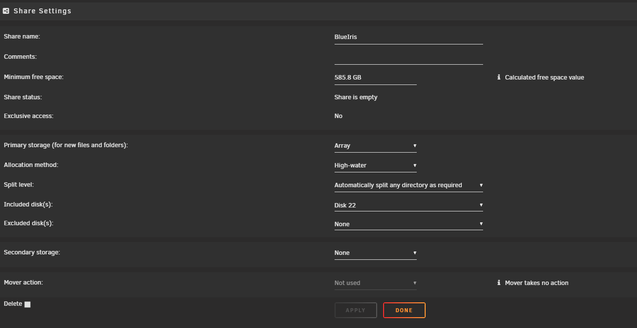

  1. Weird, when I created the share it has disk 22 only. Not sure why it created it in the wrong disk. I deleted the file on disk 7 and remade the share and it's showing correct now, thanks!
  2. Sorry, didn't think diagnostics were needed for that question. nasty-diagnostics-20240713-1551.zip
  3. I have this share setup because I bought a surveillance drive and I want BlueIris to record to. The drive is only 8TB. However, Unraid reports that the share has 11.4TB available, which makes no sense to me. Any help would be great to help me understand what is happening when I choose to include only one drive as I see all over the forums to use either include or exclude but not both. To show the size of the disk in question:
