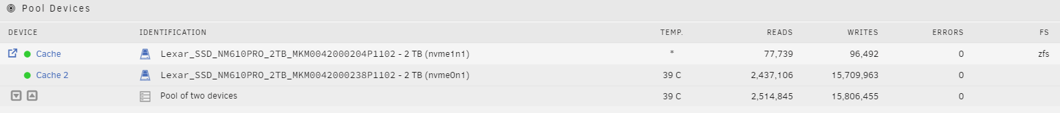

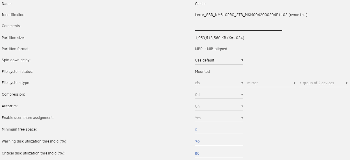

  3. Haha, good catch.... what luck to buy 2 drives at the same time with the last 5 digits of the serial matching. Okay, so I will pull the identified failed drive MKM0042000204P1102, let the server rebuild before doing anything else. I am dumbfounded that this has been an issue since 2018. Why why why.... I thought this was me specific, I am very unhappy to see this to be an OS issue.

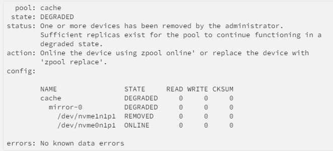

  4. Okay, long story short i hope. I have a ZFS cache pool. It has 2 nvme drives. I never noticed it, but both drives show up with the same serial number like this: I have been fighting some high IOWAIT times for a while now. Finally bit the bullet, and in the process of backing up, taking screenshots of things. I noticed that the serial numbers matched. I thought that was weird, so I went to look into the the Cache drive. And I found this: How could a drive with the same serial propagate into both drive slots? How could an array with a failed drive NOT SAY THERE IS A PROBLEM? For the record, this system has been up for over a year on this hardware. Here is the config for the mirror settings: Going forward to fix this my plan is to LEAVE the drive with serial ending in 1102, and PULL the other drive. Then let a rebuild occur after switching the drive out. Any other ideas? This is wild, that I never got a notification about a degraded drive. Or even an obvious error anywhere, I can only see the issue in the cache drive config page.

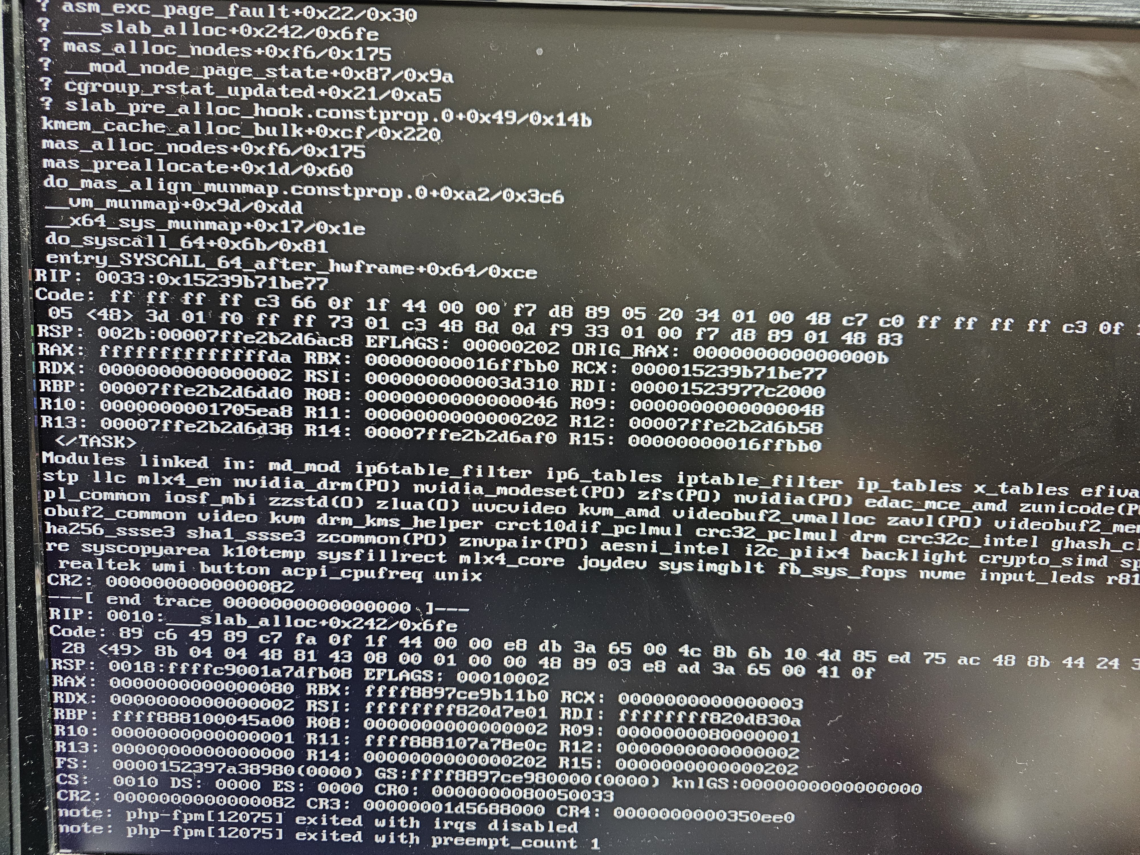

  7. My server is struggling. It died overnight after seeing a bunch of high latency events in my network. I have tested the USB stick, and it seems fine. I initially thought it was my 10GB Mellanox nic, I pulled it, but am still having issues getting the system online. Unable to get a web interface at this point. I can access the terminal from a direct attached monitor and keyboard, but I usually only get a few minutes before the call trace starts and locks me out. Update 1: Safe mode appears to be working ok. Nic card reinstalled. Everything is running. So that means its likely a plugin? Is there any way to re-enable one at a time? Ive seen some mentions of nvidia in the errors. I suspect its an issue with the nvidia driver/plugin, or my video card itself. Update 2: Spoke to soon, still crashing while in safe mode. Picture attached. Console stops working when this happens. Update 3: Decided to run memtest86. Failed. Removed 2 of 4 sticks, passed. Removed the other 2 sticks, put original 2 back in, passed, put all 4 back in, passed.... Ummm. This was a head scratcher. server-diagnostics-20231224-1401.zip

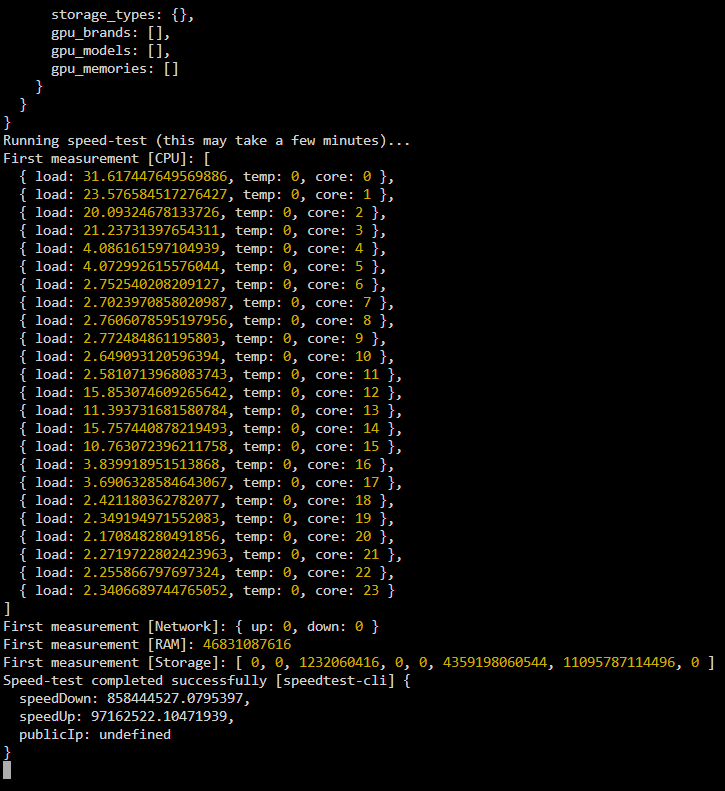

  9. Running in bridge mode is not an option. I need to specify the network segment. Is there no workaround aside from being forced to use the listed port. In all fairness, I would argue this is a template issue as its not enforcing the port change to the underlying software. Why have a webui port option if it does not work, regardless of network mode. To confirm, I am not using "bridge" mode. I am trying to use the custom br interfaces, not the host interface.
  10. Hello, Having 2 issues. 1: When I change the port, the docker does not launch with the new port number. 3001 is already used by another service. When I change it to 3005 in the WebUI field, it still launches with 3001. 2. When I add the ,gpu tag in the advanced settings, it just hangs after the speed test. No further information available. EDIT: Actually it looks like after a minute or two of running the whole dashboard dies: (regardless of GPU or not)

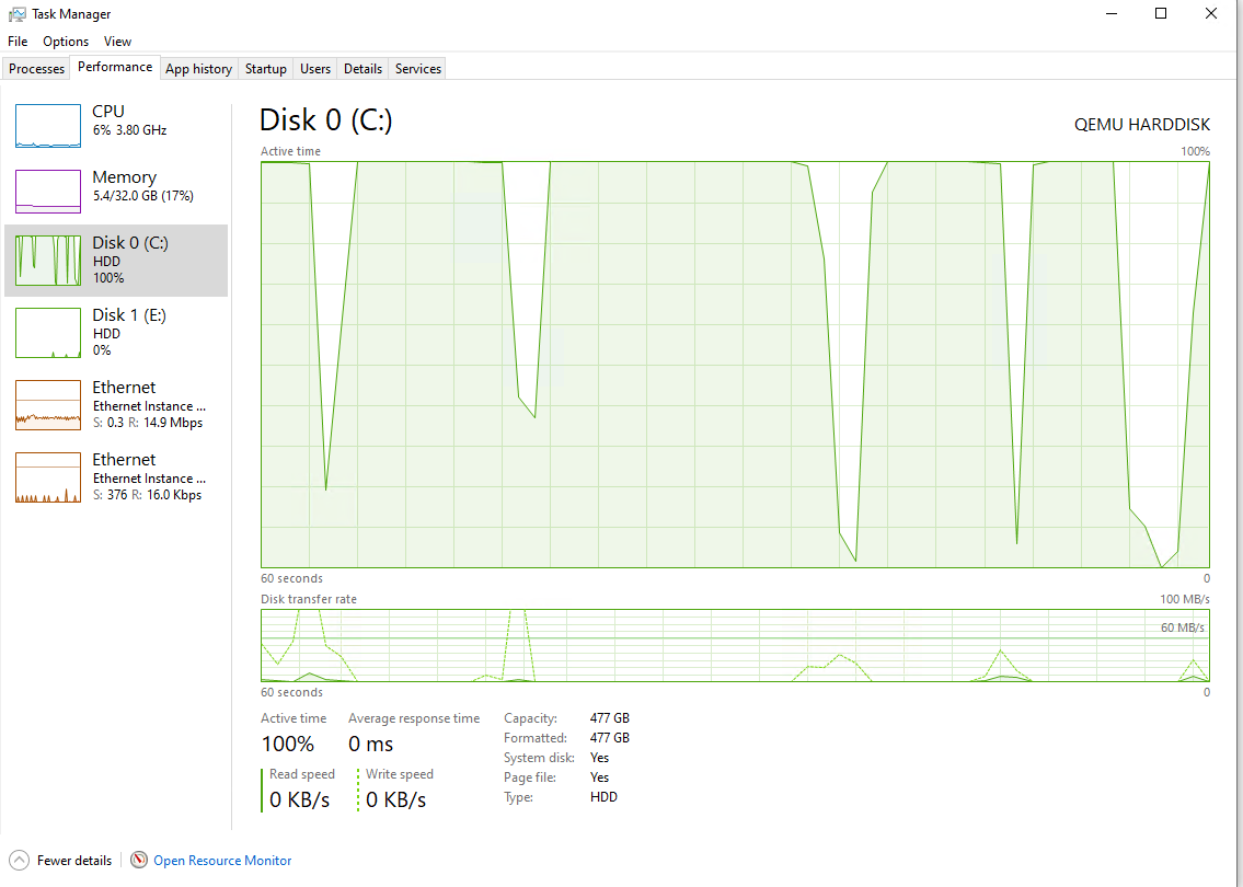

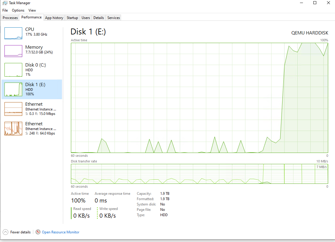

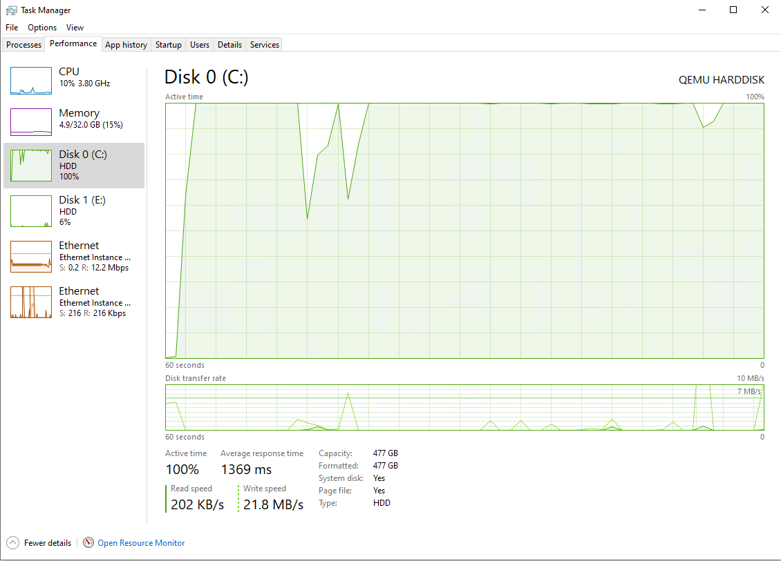

  11. I have a windows VM that has 2 SSD's passed through to it. Not the controllers, just the drives. The main OS drive can sit there and idle fine, but as soon as I start performing write operations, after about 1GB it starts freezing, locking up, pinging out. Eventually it will start to come back to life and I can see in task manager that the drive is 100% utilized. This will continue for a minute or two after the files have stopped moving where they were created, copied or extracted to. I was having this exact same issue when I was running the vm as a disk image on the cache pool and thought the ssd would fix it. I have tested both drives and they have the same behavior. They are connected to different sata controllers, X570 and Asmedia (only one drive is connected). I updated the virtio driver package and saw no change.
