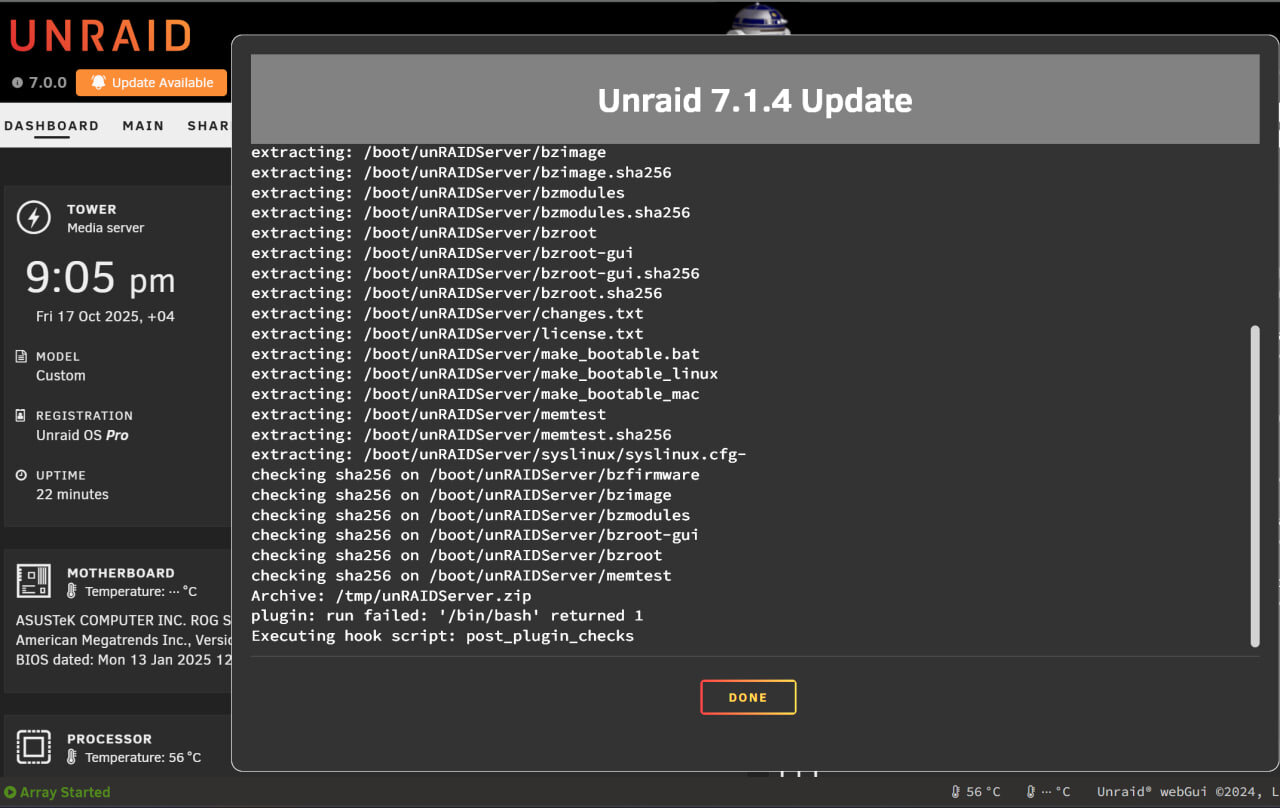

Unable to update from 7.0.0 - plugin: unRAIDServer.plg Plugin failed to install
ended up updating manually copy-posting bz* and other files. Thanks!
What if I proceed with GUI update even with the error present? Would that brick the server? Is manual upgrade going to be safe?
what if I do the non-manual update with the error?
I haven’t tried the manual update, as the manual clearly says ONLY to update manually if GUI is not available
trying again, hope it works tower-diagnostics-20251019-1609.zip

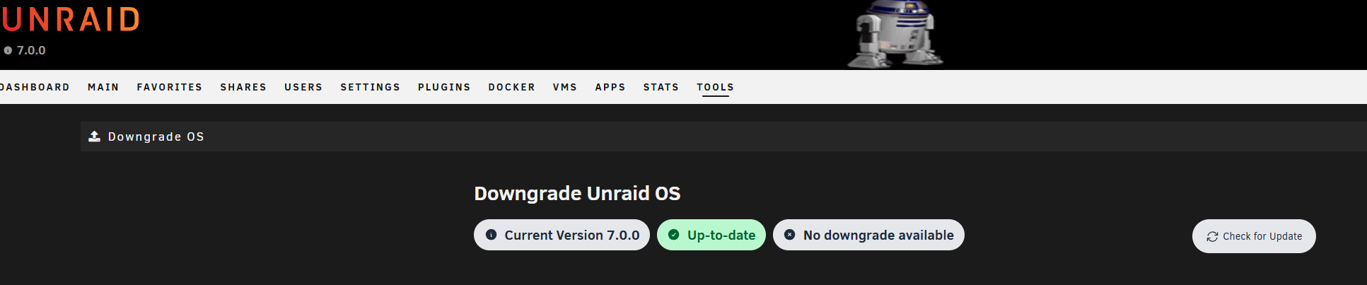

Looks like downgrade is not available for 7.0.0, plus it still allows to proceed with update, but I am scared to brick the server if I proceed.
Here you go, thanks. P.S. I have seen all other posts and tried solutions mentioned there, but it did not help.tower-diagnostics-20251019-1609.zip
Tried CHKDSK F and replaced the USB as well. Don't know what to do next, the problem still remains. Is it safe to execute the update with this error?

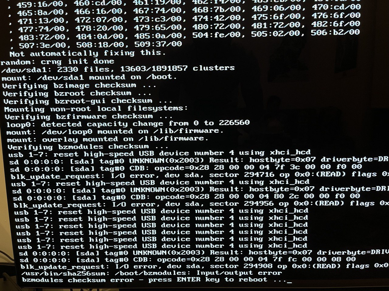

UNRAID WON'T BOOT + NVME M.2 (CACHE DRIVE) NOT SHOWN IN BIOS
Tried every USB port available. Ended up re-mounting unraid os from backup to the same USB. All works now! Many thanks! I believe I should change the flash in the future.

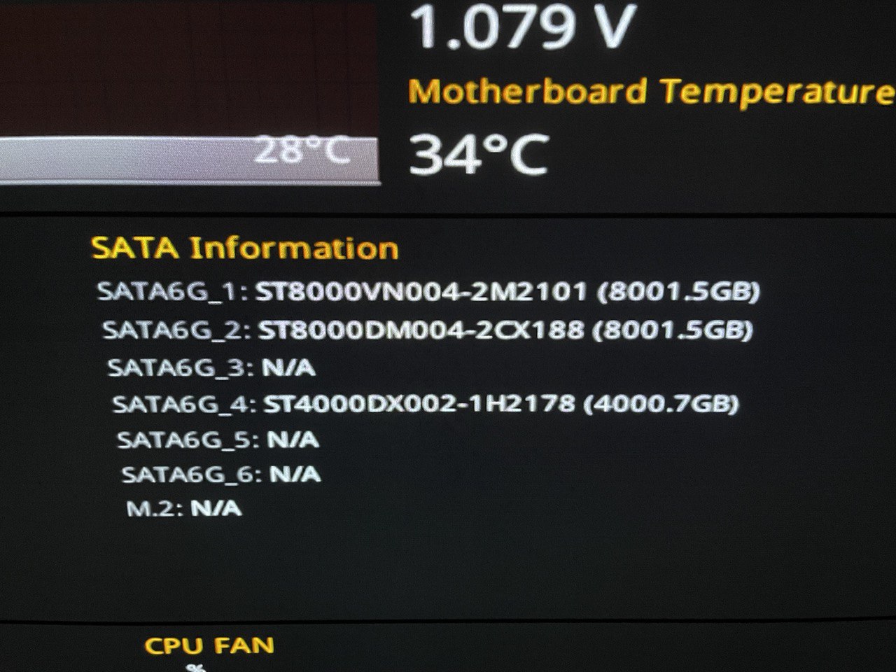

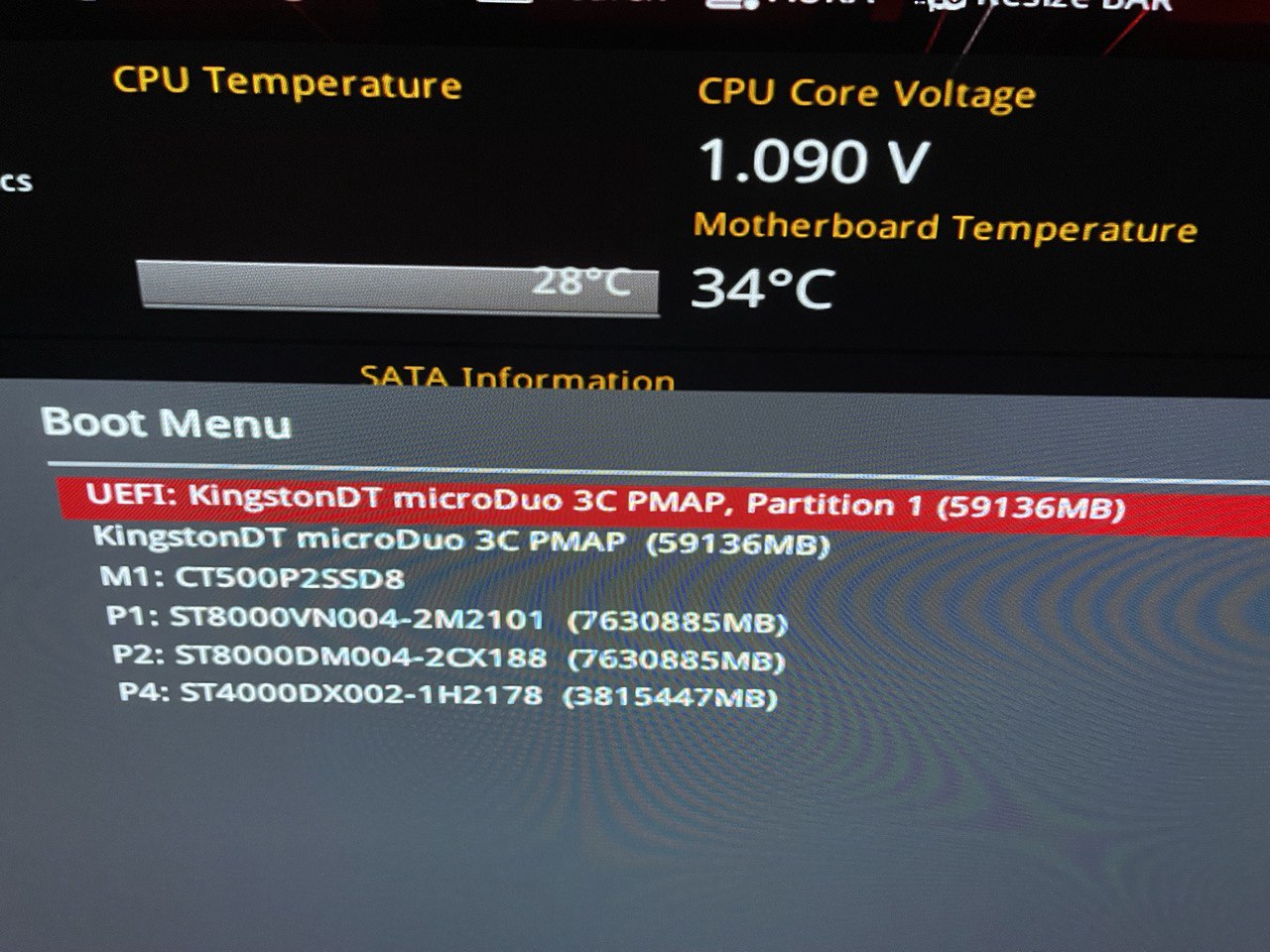

Dear All, please help! 1. Stopped the array 2. Turned off the server 3. Datached the NVME M.2 drive (used as cache) to install radiators 4. Attached the NVME drive back 5. Could not boot to unraid After going into bios I realized that m.2 drive is not shown in the SATA section anymore Tried installing another NVME drive to the same port and it would not show up in BIOS as well (checked the port/drive health) If you go to BIOS Tools, the initial NVME (cache drive) is not shown in the HDD/SDD Smart Information settings, but is shown in ASUS Secure Erase tool at the same time. Please kindly advice for any potential solution, many thanks in advance! Hardware: MB Asus ROG F450-F Gaming CPU AMD Athlon 200GE NVME Crucial CT500P2SSD8 P.S. Will I lose all my HDD data if Parity was ok at the moment it all happened?
