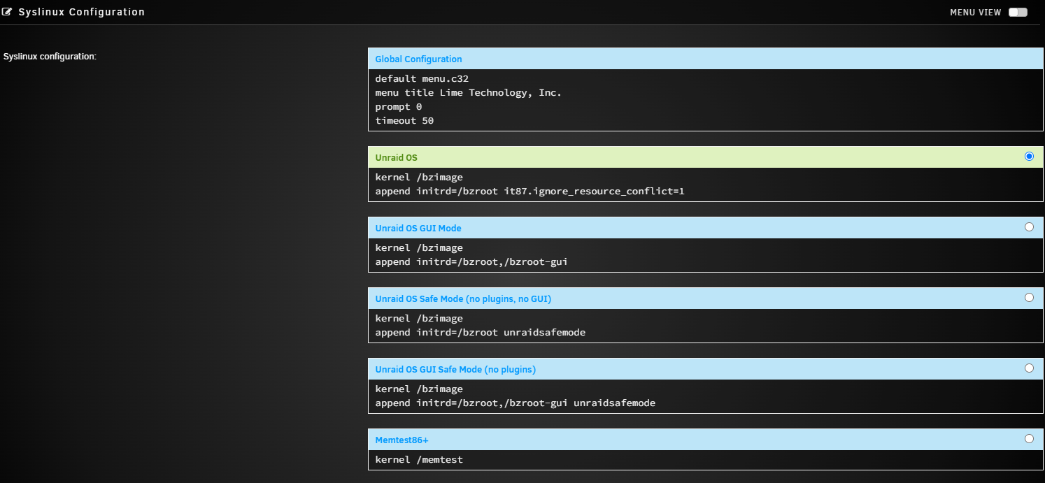

sir. when I type "modprobe it87 ignore_resource_conflict=1" in terminal my sensor is back ....... it work!! so how what I need to do ?
[Support] ich777 - AMD Vendor Reset, CoralTPU, hpsahba,...
Cause I need vim package... yes. i try only use "it87.ignore_resource_conflict=1" to boot. still no work. no show anything. after type "modprobe it87 ignore_resource_conflict=1" in terminal lsmod follow below Module Size Used by it87 61440 0 hwmon_vid 16384 1 it87 wireguard 73728 0 curve25519_x86_64 32768 1 wireguard libcurve25519_generic 49152 2 curve25519_x86_64,wireguard libchacha20poly1305 16384 1 wireguard chacha_x86_64 28672 1 libchacha20poly1305 poly1305_x86_64 28672 1 libchacha20poly1305 ip6_udp_tunnel 16384 1 wireguard udp_tunnel 20480 1 wireguard libchacha 16384 1 chacha_x86_64 ccp 32768 0 xt_CHECKSUM 16384 1 ipt_REJECT 16384 2 nf_reject_ipv4 16384 1 ipt_REJECT ip6table_mangle 16384 1 ip6table_nat 16384 1 xt_nat 16384 14 xt_tcpudp 16384 52 iptable_mangle 16384 1 vhost_net 28672 0 tun 53248 1 vhost_net vhost 40960 1 vhost_net vhost_iotlb 16384 1 vhost tap 24576 1 vhost_net veth 32768 0 xt_conntrack 16384 2 xt_MASQUERADE 16384 19 nf_conntrack_netlink 49152 0 nfnetlink 16384 2 nf_conntrack_netlink xfrm_user 36864 1 xfrm_algo 16384 1 xfrm_user xt_addrtype 16384 2 iptable_nat 16384 2 nf_nat 49152 4 ip6table_nat,xt_nat,iptable_nat,xt_MASQUERADE nf_conntrack 139264 5 xt_conntrack,nf_nat,xt_nat,nf_conntrack_netlink,xt_MASQUERADE nf_defrag_ipv6 16384 1 nf_conntrack nf_defrag_ipv4 16384 1 nf_conntrack br_netfilter 32768 0 xfs 1654784 5 md_mod 53248 5 efivarfs 16384 1 ip6table_filter 16384 1 ip6_tables 28672 3 ip6table_filter,ip6table_nat,ip6table_mangle iptable_filter 16384 2 ip_tables 28672 3 iptable_filter,iptable_nat,iptable_mangle x_tables 45056 15 ip6table_filter,xt_conntrack,iptable_filter,ip6table_nat,xt_tcpudp,xt_addrtype,xt_CHECKSUM,xt_nat,ip6_tables,ipt_REJECT,ip_tables,iptable_nat,ip6table_mangle,xt_MASQUERADE,iptable_mangle bridge 266240 1 br_netfilter stp 16384 1 bridge llc 16384 2 bridge,stp ipv6 536576 164 bridge,br_netfilter,wireguard,ip6table_mangle igc 114688 0 r8125 143360 0 i915 2441216 0 gigabyte_wmi 20480 0 wmi_bmof 16384 0 intel_wmi_thunderbolt 16384 0 iosf_mbi 16384 1 i915 drm_buddy 16384 1 i915 i2c_algo_bit 16384 1 i915 ttm 73728 1 i915 drm_display_helper 135168 1 i915 drm_kms_helper 159744 2 drm_display_helper,i915 i2c_i801 24576 0 x86_pkg_temp_thermal 16384 0 intel_powerclamp 16384 0 coretemp 16384 0 kvm_intel 258048 0 kvm 954368 1 kvm_intel crct10dif_pclmul 16384 1 crc32_pclmul 16384 0 crc32c_intel 24576 4 ghash_clmulni_intel 16384 0 aesni_intel 380928 0 crypto_simd 16384 1 aesni_intel cryptd 24576 2 crypto_simd,ghash_clmulni_intel intel_cstate 20480 0 intel_uncore 200704 0 i2c_smbus 16384 1 i2c_i801 drm 479232 6 drm_kms_helper,drm_display_helper,drm_buddy,i915,ttm joydev 24576 0 input_leds 16384 0 led_class 16384 1 input_leds ahci 45056 6 nvme 49152 2 intel_gtt 20480 1 i915 libahci 40960 1 ahci agpgart 40960 2 intel_gtt,ttm nvme_core 106496 3 nvme i2c_core 86016 7 drm_kms_helper,i2c_algo_bit,drm_display_helper,i2c_smbus,i2c_i801,i915,drm syscopyarea 16384 1 drm_kms_helper sysfillrect 16384 1 drm_kms_helper sysimgblt 16384 1 drm_kms_helper fb_sys_fops 16384 1 drm_kms_helper wmi 28672 3 intel_wmi_thunderbolt,gigabyte_wmi,wmi_bmof thermal 20480 0 fan 16384 0 tpm_crb 16384 0 tpm_tis 16384 0 video 53248 1 i915 tpm_tis_core 20480 1 tpm_tis tpm 73728 3 tpm_tis,tpm_crb,tpm_tis_core backlight 20480 4 video,drm_display_helper,i915,drm acpi_tad 16384 0 acpi_pad 24576 0 button 20480 0 unix 53248 345

Hello Sir, I try to downgrade to 6.10.3, and it work perfect. but i try again upgrade to 6.11.1 or 6.11.0 nothing to change by setting. only uninstall nerdpack and install nerd tools . no luck ....... no working . post my diagnostics, thank your help .
I know nerdpack is no longer supported. but nerd tools is new support for 6.11 series is that wrong ? is any plugin good for check my config ? any suggest?
