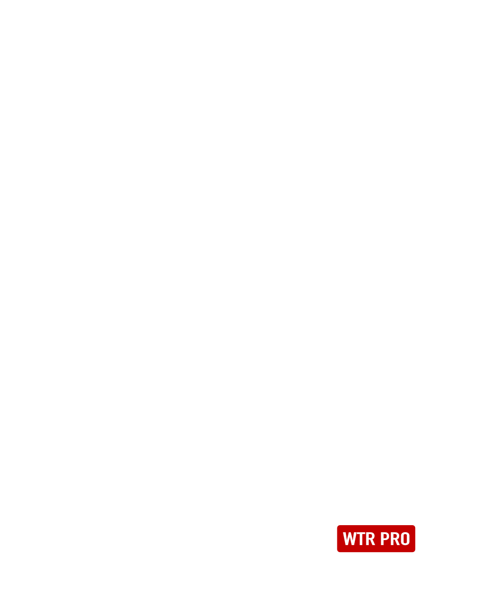

  1. While waiting for my Aoostar WTR Pro device to arrive, I decided to make the case model. Feel free to use it :)
