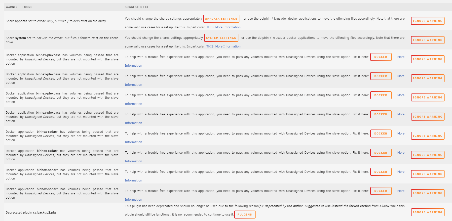

Hi there, I had Unraid running in a normal PC case for many moons without a hiccup. I decided to invest in some new hardware and bought a Supermicro 846 case along with a Supermicro mobo / new CPUs etc. It booted it up fine and all seemed well (Plex and other dockers worked etc). It's been running 24 hours and I was trying to transfer some media files over to one of the drives and transfer failed and it seems the server crashed. The symptoms were this: I could still access the Unraid backend but, if I clicked "Shares" I got the message "Share 'appdata' has been deleted" and none of my Shared folders showed up. I tried a reboot and it all came back to life again. So, I tried transferring again and it seemed to stop working again so I did a bit of Googling and installed Fix Common Problems. This reports (among a few other things) - "macvlan call traces found" (there's 16 of these entries) ?? I've also got these entries... So, I'm a bit stuck - I don't know what I should be doing? I've Googled macvlan and ipvlan and it's a bit over my head so I'm confused by what action I should be taking (if any) ? I'm running v6.12.3 of Unraid. I don't know if I've got a hardware problem or this is a software issue and (if it is) could it have caused my previous issues? If anyone could help untangle this mess and give me some advice on what I should do here it would be very much appreciated. I've tacked on my 'diagnostics' just in case it's helpful? Thanks 🙂 jtserver-diagnostics-20230805-1334.zip
