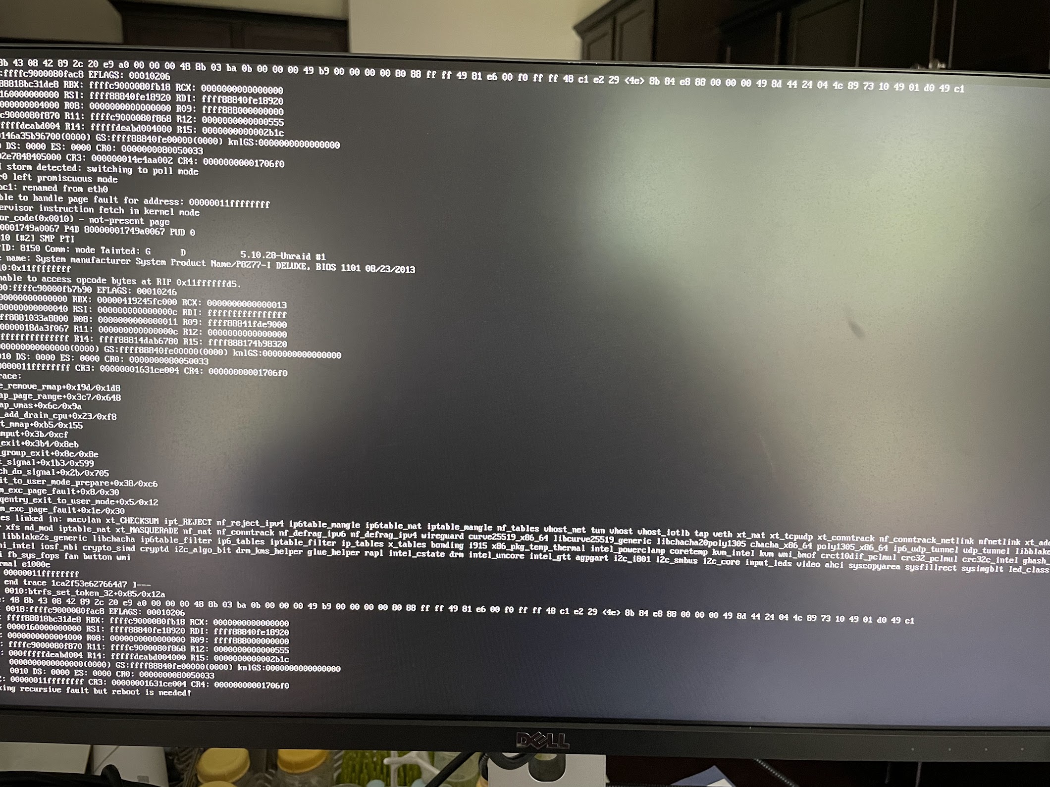

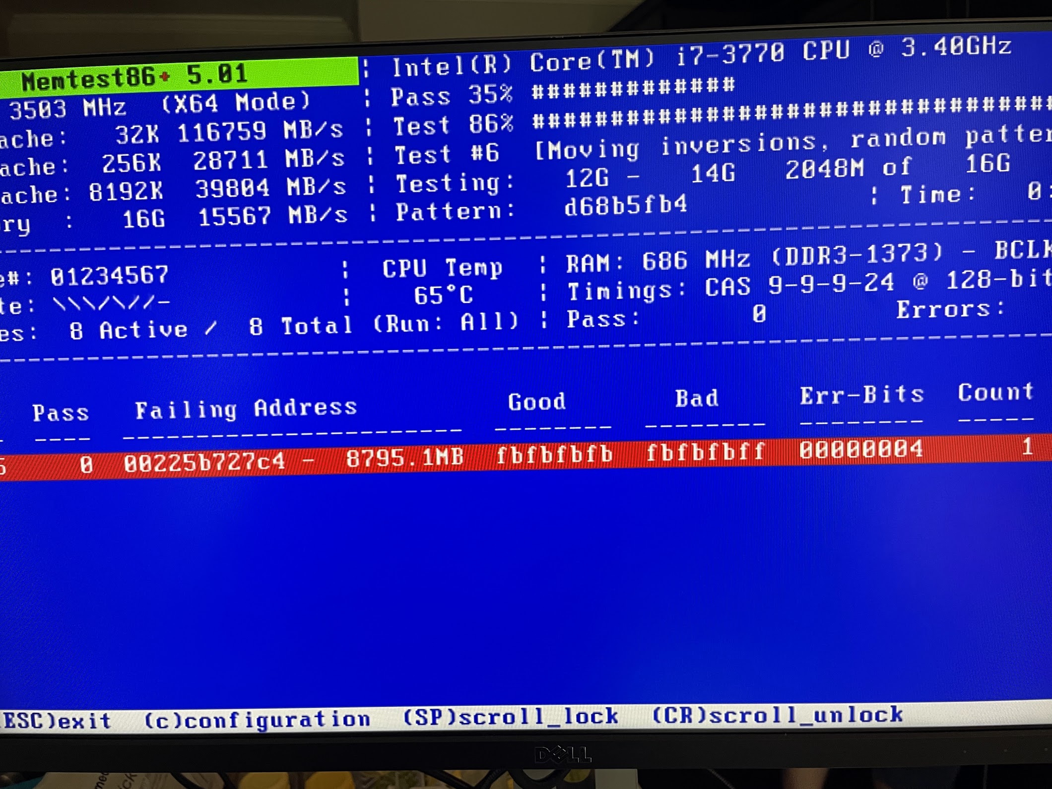

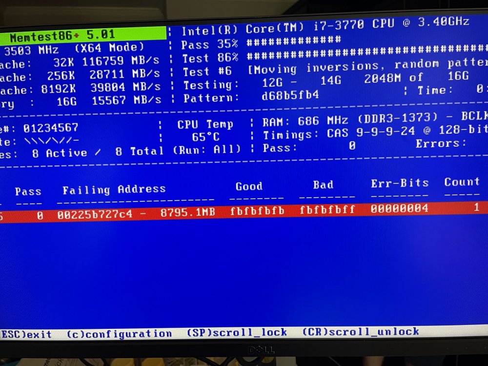

  7. Yes, there are errors with he Bios settings defaulted. Is it typical for a long running machines memory to fail like this?
  8. @trurl Yes, it does. It won't if I don't start the array, but even if I disable Docker, once I start the array it will barf after a few minutes. I started running the Memtest again, but this time with Hyperthreading enabled (option 2) and stated getting these errors after about 30 min, which I did not get with option one. So, I went to the BIOS and reset to defaults and am running again.
  9. It ran overnight, but about 13 hours

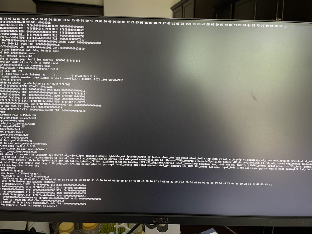

  10. Nerdpack uninstalled. New Panic. New Syslog and Diagnostics attached. xnas-diagnostics-20220821-1325.zip syslog
  11. Diagnostics attached xnas-diagnostics-20220821-1209.zip
