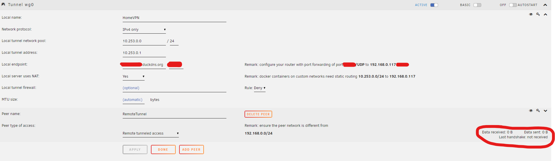

  1. No, not using IPVLAN. Although the suggestion is appreciated, thanks @hawgorn Actually just came back to this thread today to inform anyone from the future that I did manage to resolve this for me. Essentially the solution for me was that I moved house and got a new ISP. New connection, new IP. Not sure what change actually fixed it but I had wireguard up and running in 5 minutes :). I suspect that my previous ISP was blocking it in someway? Anyways, that may be your issue too.

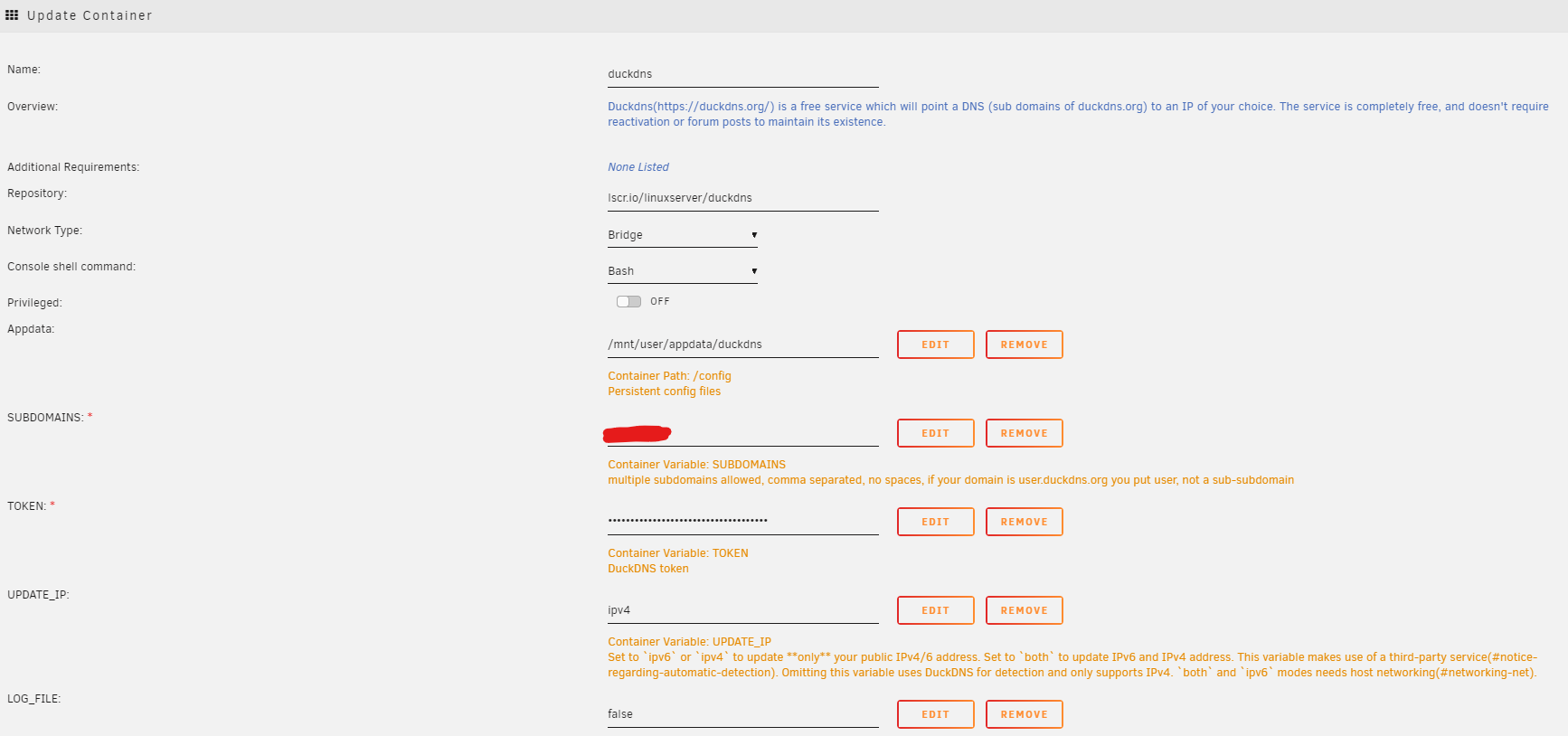

  2. Alright, here is some extra info that may be useful to someone who knows what my problem may be: Here is my port forward rule: Here is my duckdns docker install: And here is my wireguard setup. All just default parameters apart from the essentials:
  3. Hello all!! So recently I have been battling to get Wireguard VPN working. About 12 months ago I had wireguard setup and working well. My setup was a basic remote tunnel, using DuckDNS like this JuanMTech tutorial: https://www.youtube.com/watch?v=HIJiYuPDzKs At the time I used it for remote access to HomeAssistant (This time I might like to access some data remotely also). However, sometime in the past 12 months wireguard stopped working (no handshakes, no data transfer). I do not know exactly when it was because I didn't use it very often, which makes it difficult to pinpoint what changed. Possibly when I updated to 6.12.6? Anyways, after a lot of attempts to try and set it up again I need some assistance! What I've tried so far: Quadrouple checking my port forwarding Updating my IP on DuckDNS (wasn't an issue) Updating the tunnels on my phone via QR code Deleting my peers and tunnels and setting them up again (did that like 10 times haha) A complete fresh Unraid install (at this point I was getting desperate haha) I understand that currently you all have nothing to go on, so if there is a certain kind of log that I can send through that will help please let me know. Thanks in advance, Matt
