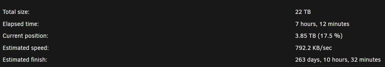

  8. I'm thinking this could have something to do specifically with the Samsung 4TB SSD? My reasoning being that I noticed this same issue last night with the HBA continuously attempting to restart that specific drive after it began a TRIM. In those logs you quoted the timestamp is 07:36 and my TRIM settings are set to run a TRIM at 07:30. Perhaps this would explain why I'm only seeing this issue during a TRIM? Is it possible that SSD specifically is damaged? (It was recently gifted to me from a friend and I have not yet tested it. Funny enough, he gave it to me and it was very dirty; he said his dogs took it outside and it could have water damage.) This issue doesn't seem to be occurring anymore and the parity-sync has returned to 170MBs as of right now. Let me know if you think it's possible that the culprit could be that specific SSD or if it makes more sense that it's still an issue with the SAS cables/power?
  9. To add more context: I'm running a 45Drives Storinator S45 as the server case with 18 of the 45 bays filled. It's one of the older styles that doesn't use a backplane. I recently upgraded the cable harness to use 1 meter SFF 8643 -> 4 8482 SFF SAS cables. I'm then running triple Broadcom SAS 9305-16i HBAs. The power for all of the drives is using the cable harness that comes with the Storinator using single molex to power two sata connectors per sas cable. You can see what that looks like in this video from 45drives here at timestamp 1:33: The disks do share a power splitter, but it should be providing more than enough power? In the logs, is there a way to tell which specific drive is being rebooted by the HBA continuously? The server power supply is a ZIPPY M3W-6950P. Here are the specs of the power supply for reference: https://knowledgebase.45drives.com/kb/power-supply-specifications Also attached below as a pdf incase the link ever becomes dead in the future for others who may come across this. Zippy 950W M3W-6950P 2+1 Redundant.pdf
