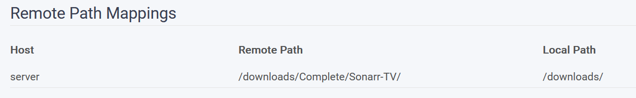

  4. Well tried something else, and looks like the trick for me was a remote path map like so:

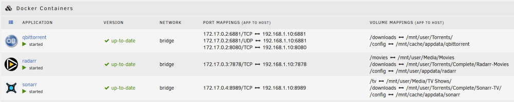

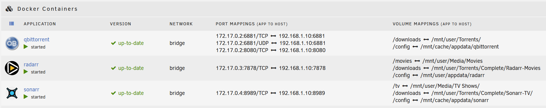

  6. Just in case, heres the docker mappings:

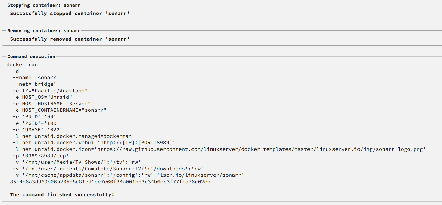

  7. Nope, completes fine:
  8. Having a weird issue with my Sonarr/Radarr instances in docker, where they both wont mount shares. I have my torrent download directory set to primary as cache with secondary as array (since I was filling up cache on large download batches). However, if i mount the download share as /mnt/cache/xxx, then sonarr will mount it (but cant see any files because theyre all living on the array and not the cache drive), but if I try mounting the share as /mnt/user/xxx, then it simply refuses to mount and its not listed as a location in sonarr...any tips? edit: I was getting file not found errors and thought this was due to the fact the volume wasnt showing up in the system section of sonarr (which it did when mounted as /mnt/cache but not when mounted as /mnt/user)...solution was to mount as user, but put a remote path map in as shown below...

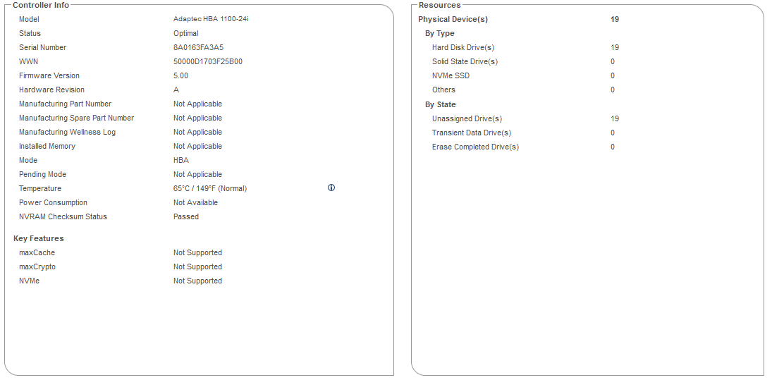

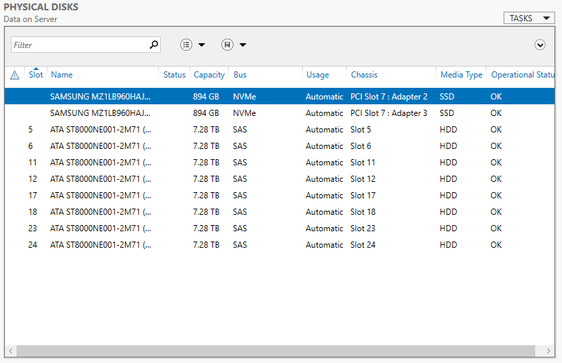

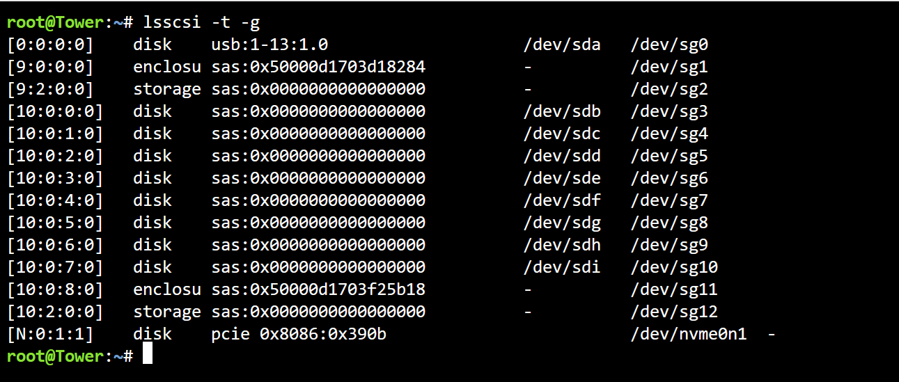

  9. Not sure if it matters but all drives are SATA and not SAS...
  10. Interesting, its JBOD as far as I know...screenshot of adapter properties (from MaxView Storage Manage webgui running under Windows Server 2019), drive quantity will differ as I unplugged my windows drives for unraid testing...but no HBA card settings were changed. I can flash drive locate LED's via windows storage spaces admin console and chassis slots are reported also (see below)..
  11. dirtrally joined the community
