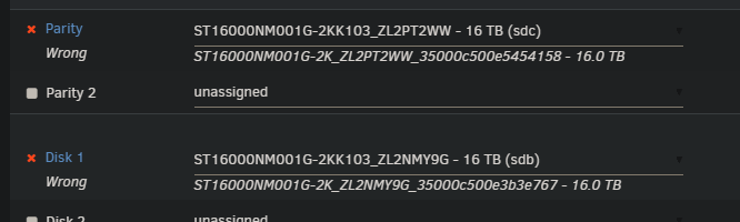

  7. Hi, I recently upgraded from my old xeon 2470v2 server to a ryzen 7 3700x computer (mainly for power savings). I followed a post on the forum, and transferred the drives and the flash drive to the new pc. I noticed my drives showed up as missing. The two drives are still there, but under different names. I assume this has something to do with the raid controller I had set to JBOD in the hp server that isn't present in my new build (I'm just using motherboard ports now). The solution I saw was to do a new config, and to me it seems pretty obvious which drive was which, but I wanted to make sure before I (potentially) nuke all my data. Thanks
