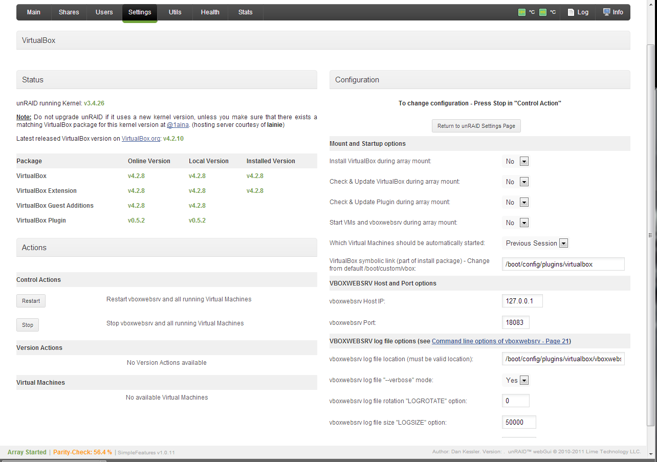

  2. To fix the soap error, you have to enable it in a php config file, I'm not at my server and don't remember the file off the top of my head though, the fact that you're getting the soap error means your virtual box and php virtual box are linked. Sent from my Nexus 7 using Tapatalk HD
