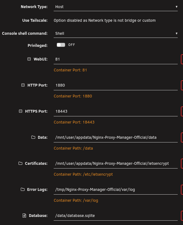

  1. Hi all, Hoping you can help, I had to reinstate my containers from back up and everything came back fine with the exception of Nginx Proxy Manager. I guess it keeps crashing at the backend as the logs show this : ❯ Starting backend ... node[1356]: pthread_create: Resource temporarily unavailable Warning: Failed to load CA certificates off thread: resource temporarily unavailable [8/30/2026] [1:25:04 PM] [Global ] › ℹ info Using Sqlite: /data/database.sqlite ./run: line 21: 1356 Aborted s6-setuidgid "$PUID:$PGID" bash -c "export HOME=$NPMHOME;export CERTBOT_VERSION=$CERTBOT_VERSION;node --abort_on_uncaught_exception --max_old_space_size=250 index.js" I did try copying my old cert folder into the certificates folder but that did not work, so I blew away all instances of NGMPM and installed fresh with this still happening. my unraid box is: Intel® Core™ i7-3770K CPU @ 3.50GHz MACHINIST B75 PRO , Version V2.0 American Megatrends Inc., Version 4.6.5 AMDAMDGPU Radeon 540/540X/550/550X / RX 540X/5 Memory: 16 GiB DDR3 If anyone can please help to get this working again i would greatly appreciate it . Thanks, Drezin Couple of points : *yes I have turned on Host access to containers in Docker settings of unraid. *yes i do have port 80 and 443 forwareded in my router to those ports. My Letsencrypt folder is empty (clean install) Here is a look at my data folder Here is a current look at my setup as maybe i have something reconfigured incorrectly :

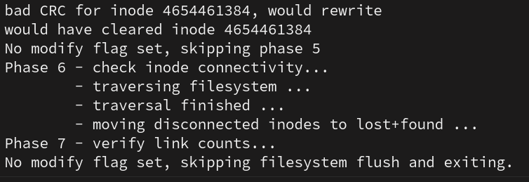

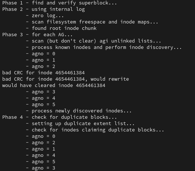

  6. Good Morning All, This is the second time this has happened to me which leaves me to suspect a bad file system on my disk. My Unraid system has one 6TB Disk and one 6TB Parity Disk. The system runs on a UPS and one day during a thunder and lighting storm I lost about half my data, mostly movies books text documents etc. Even though I did not loose power I chalked it up to the storm and some kind of power surge. Just this past week (Saturday Night) it happened again. Suddenly data loss again half the data is there half of it gone. Not the same things but different. This is why i think it is a bad file system. I put the server in Maintenance mode and checked the disk. I did see in it that it "needs repair". So I let it run fully and ran it again but did not get the message "needs repair" again. So I assumed the system fixed the problem. The data is still missing and did not return. I am starting to think it is a hard drive crash fail and i was preparing to buy a new hard disk to replace it and attempt to data recover the old data from the old one. It still boots and runs like everything is fine but half the data is missing. The first time it happen I posted here asking for help and uploaded the log and you responded with not seeing any issues in it (Thank You again) . I cannot even upload the log as the "Syslog Server" went missing. (Yes I know I am a bone head for storing it on the disk lesson learned) I am adding the S.M.A.R.T report to this post to see if you can find anything to help. Anyways here are my questions: 1) If I add a new hard drive to unsaid I know i have to clear it and format it but then i would also need to clear and format the parity disk? I do not want the parity disk to rebuild a bad file system on the new disk. 2) Is it possible to recover the data with a file system issue if it is one or does anyone else know of a better solution. I plan on connecting the drive to my main computer through a hard drive enclosure and USB to try to copy (Rsync) the data off and onto a back up 6TB drive that i have. 3) Lastly does anyone have any ideas one what will happen to nextcloud with just a new hard drive etc.... or do I need to capture that whole share too? (Might need to post this in the nc forum) Anyways if you got all the way down to here thank you and here is the SMART Report. krynn-diagnostics-20231004-1045.zip Any help is appreciated. Drezin

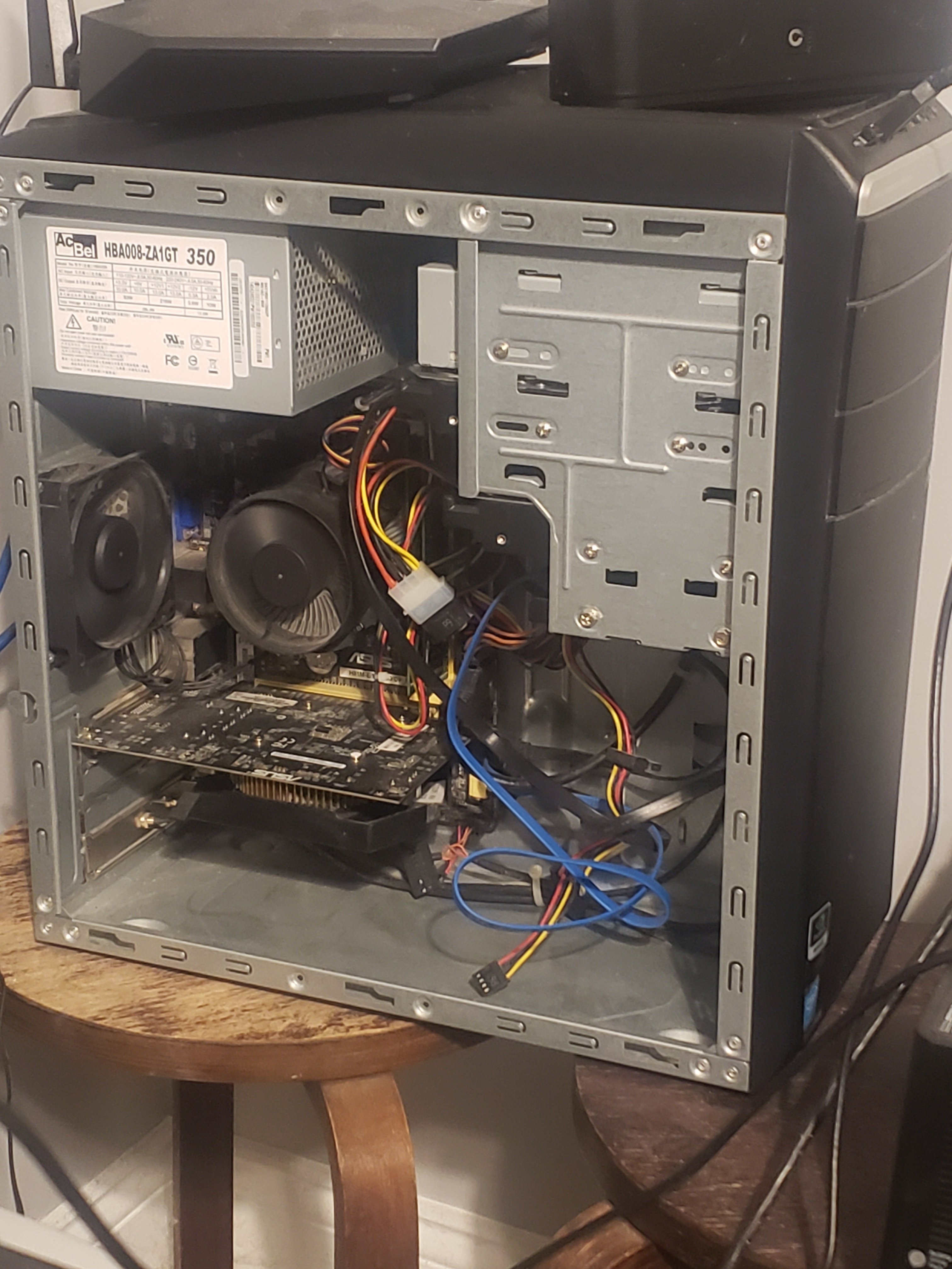

  10. Ok First off thank you for reading this (it is going to be a little long), I am looking on how best to proceed with this server. Here is a summary of everything that has been going on. A few weeks ago the server was running rock solid no problem. I had a scheduled parity check to run over night. When I woke up the server had shut down. I booted it back up and realized the settings for parity check temps were 35 (pause) and 40 (Shutdown) on the hard drives. So I figured it was the settings and rebooted it and reset the settings. From then on I have had numerous little problems here and there. Here is a summary: 1) Unable to run a parity check since then at all it gets to 80% and pauses. If i restart it it shuts down the server. 2) unexpectedly I will get high cpu usage that will not stop or slow down prompting me to reboot the server to calm it down. Normal operation under 15 - 20% of cpu. 3) Whenever i update a docker container it will update fine but the docker will stop and when i start it it gives me an execution error. I have to totally shut down the server and boot it back up to get that container working again. 4) I notice in the morning when I log into it, it would instantly take me in to the UI (accessing it on my home network never really had any lag or congestion) . Now it will sit on the login screen for about 30s then let me go in. 5) I am just concerned with all he reboots I have to do with it, as before i nearly ran it for a year with no issues. Some info on the system: I am running unraid on an old computer bought in 2010, it has a Asus Mother board and an Intel i7 processor, Nvidia Video Card, and just upgraded it to 16GB (from 12) of ram. 350W CPU. It is running with 1 6TB Drive , and 1 6TB Parity Drive with a 250G SSD as cache. Temps on the system in the summer have been 40-43C on the hard drives, and 35C on the cpu under idle. 50C under load. (looks normal or a little high) I cannot tell if this is a hardware or a software problem so I do not know how to proceed. Here are my proposed solutions. 1) Retrofit the system into a better case with more airflow over the hard drives and a new cpu cooler (new thermal paste), Hard drive fans, case fans, and new 600W PSU. 2) Restore Unraid form a backup I have and move forward with that, and see if that fixes the issues. (if I do this I need to look up the procedure and how it will affect Dockers and other information etc.) 3) Scrap the whole thing and buy new hardware with a server in mind and build a new. (if I do this then I need to worry about how to load the drives already full of information into a new Unraid install) I am posting the Diagnostics, and the Server Log, but i am assuming you wont see anything interesting in that, I have looked and others on this forum did not see anything. Any advice would greatly help: syslogserver.zipkrynn-diagnostics.zip Thank you for your help. Drezin
