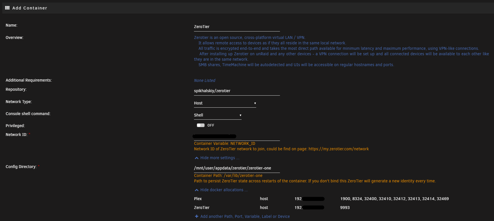

  2. Hello I need to authorize my zerotier vpn to communicate with my smb share, since a update few months ago, I lost the connectivity of my smb from my vpn do you know how to authorize the communication into smb config from my vpn zerotier installed from docker ?

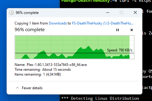

  3. Hello there, I'm having somes issues with zerotier plugin on my server, when I'm in remote i have very low speed less than 1mbps for files transfers. I don't know how to fix this, i have already posted a topic on Zerotier's reddit but people say as now they don't have any problem. My zerotier app isn't edited, i just added the network and started it. On the screen i re enabled the privileged mode. If you have any clue what's could be the problem or a place to check i'm in Thank you

  5. It seems to work so much better when connected to my local network ( and not through my SD WAN) I can watch a Ultra HD without lag and load instantly when i change the timeline of the movie Is there any people using ZeroTier through UNRAID ? any experience with video and files loading/uploading ? Installing a media server like Plex could improve performance too ? I could play with this when i have some time
