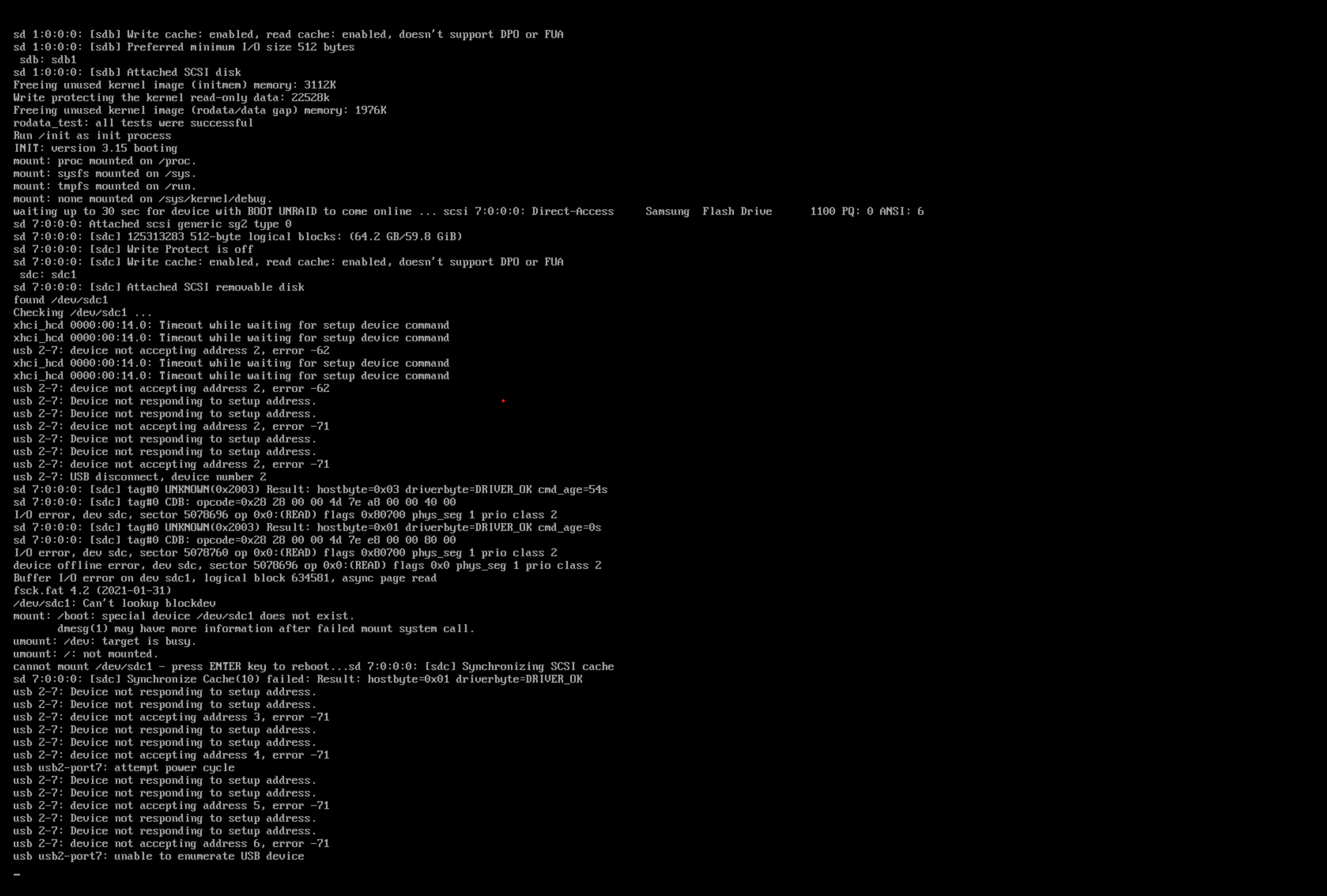

  4. Hi UnRaiders, I’m hoping for some help with my server. I've been having issues since upgrading from 7.0.0 to 7.2.1 , I’ve had occasional issues (random lockups, slow response), but the system was still usable. Yesterday, it completely locked up and I had to force a reboot. After that, I couldn’t boot back into Unraid at all. I was getting an error related to the USB drive (something like “USB device not found” or a mount/filesystem error on the flash device) ; Since I couldn’t boot, I used the Unraid flash tool to reflash my existing USB drive with the latest Unraid version(7.2.2) I then copied my saved config folder and extra folder, from a backup onto the new USB. Things seem stable but i wanted to see if anyone would be able to tell me if i there's anything i should correct or if it might have just been a corrupted USB causing trouble. the error i saw during boot was: ares-diagnostics-20251207-1849.zip

  14. Thanks everyone! server has been stable for 14 days, while troubleshooting the hardware aspect i noticed that the fan profile was set to quiet so i ramped up the fans and cleaned up some unused plug-ins and general maintenance. Thanks again!
