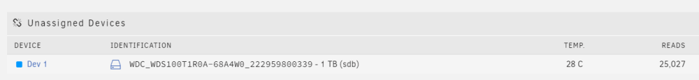

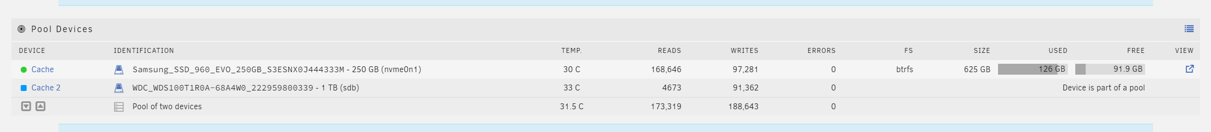

  11. Hi again Yesterday my drive went missing again, there is something wrong with the samsung one. So today i tried it again. You say "after that is complete", when do i know if its complete? Currently, the WDC drive is still a "new device". That has to go green right? Then, i can remove the Old Samsung drive and im good? Thanks again!

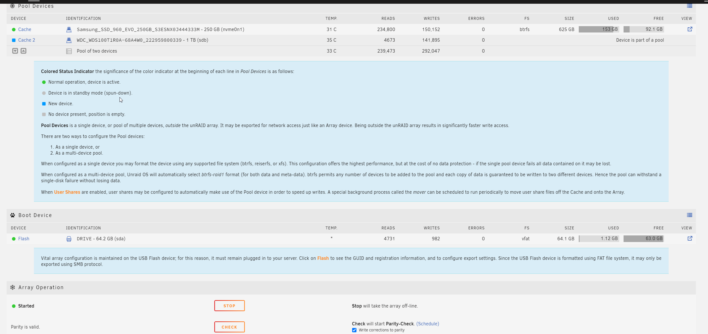

  12. OH MY GODDD YESSS!!!! It looks like its all back again! So, that i don't fck it up again, this is the right procedure for me right? (The "How do I replace/upgrade my single cache device? (unRAID v6.2 and above only" post)

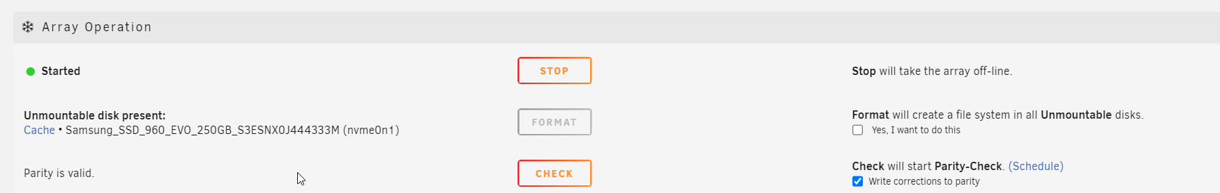

  13. Ohh ok, yes i did reboot the Server multiple times in the meantime. What i did after the initial swap and seeing that nothing happens is i stopped the array and moved everything back as it was (WD Drive "unassigned" and Samsung Drive back to the Cache Pool). When i then started the Array i saw the "unmountable" error for the first time and rebooted the server. Output is: using SB copy 1, bytenr 67108864
  14. It is, the new one is this one: I had an "old" Samsung SSD lying around which i used for Cache. Now i want to replace it with a WD Red SATA and an Intenso NVMe. Since i only have one NVME Slot, i wanted to first move everything over to the SATA Drive, then remove the Samsung NVMe and install the new Intenso NVMe. Why do you think that the Samsung Drive is not the old one? Do the Diagnostics say so?

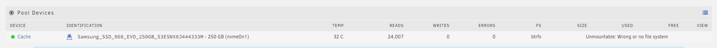

  15. Unfortunately, still same error: It also says that the Samsung SSD is Unmountable:
