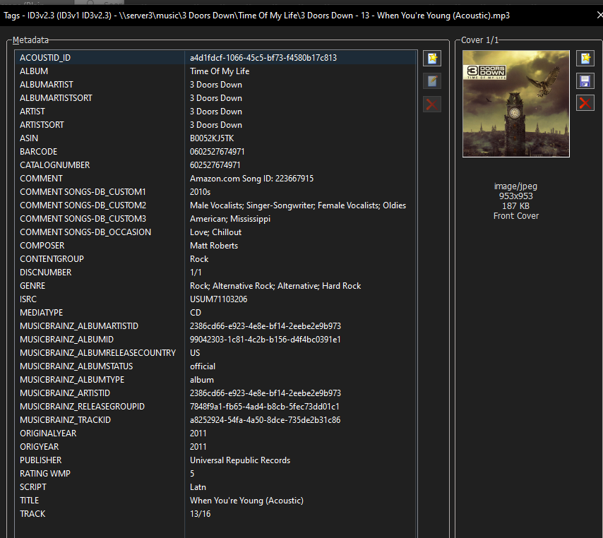

I turned off "enhanced macos interoperability". Now I get a different error warning that some properties won't be copied.

@Kilrah, I'm copying using drag and drop between two Windows file explorer windows. The Unraid window points to a standard SMB Unraid /media share. Thank you @JorgeB for finding the issue and a recommended solution, although I don't know where to enter the command or the value to use. I'm speechless regarding the default unraid file system having a metadata limit that's less than what Windows supports. I'm using MP3Tag, which I figured was the safest compatible program to use. Hard to believe that MP3tag doesn't issue a warning when metadata is exceeded. I'm inclined to believe a standard common xattr size has already been figured out by numerous others. Would you or someone please recommend the size to use for mp3 and flacs?

New to Unraid coming from Synology. Successfully copied all of my movies and TV. Currently 61.5 TB used of 72 TB (85.5 %). Now attempting to copy my 140GB music library from my Synology NAS (same source as movies & tv). Getting one of two errors on some, not all files: "There is not enough space on "Highway to Hell" (whatever the folder is currently trying to copy) Or "Error 0x80070299: The requested operation could not be completed due to a file system limitation" Clicking Skip continues copying many other files, until it triggers another one of those errors, which happens a lot. I tried renaming the files, but that has not affect.
