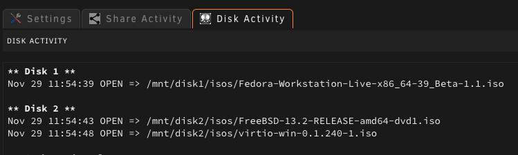

  8. Not sure if this is somehow me problem, but when I login to Dashboard I can hear disk(s) being spun up. I can also see them with green/active in the Array widget. A little bit of background After checking the File Activity (plugin) I noticed that ISOs for my (1 active, 2 not running) VMs are being read. and Which is exactly aligned with disks that are woke up and VMs I have on my Dashboard What should I do differently? Should I store my ISOs share on SSD? (does not make much sense since they are only read once for the VM installation) Should I hide "Virtual Machines" widget from Dashboard? (Interestingly, I spun down all the discs and refreshed Dashboard, but this time all of them stayed on 'standby' and not active) Or should I do something else? The main question is why is this happening at the first place? This is not an isolated case, since I noticed that it wakes up a disk or two when I open the Dashboard after a few hours of inactivity (default spin down time is 1h for me)

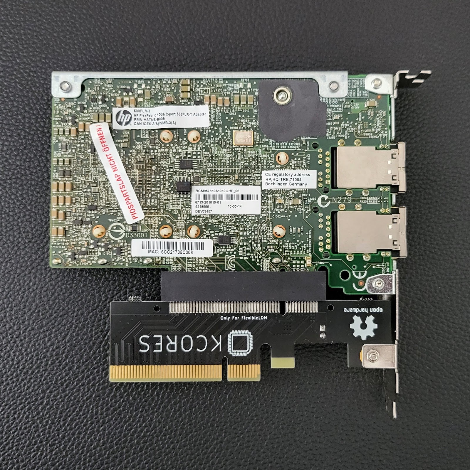

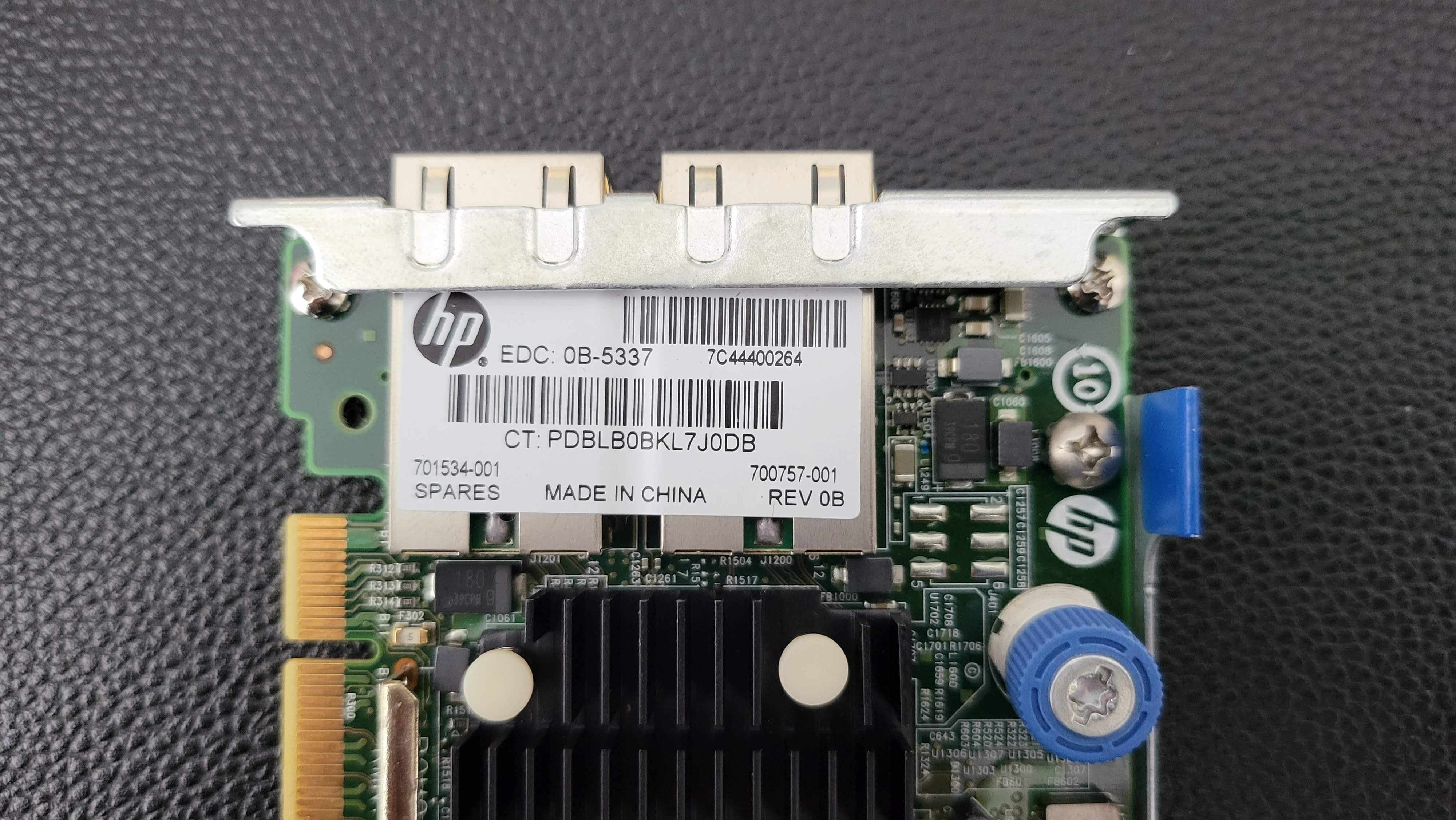

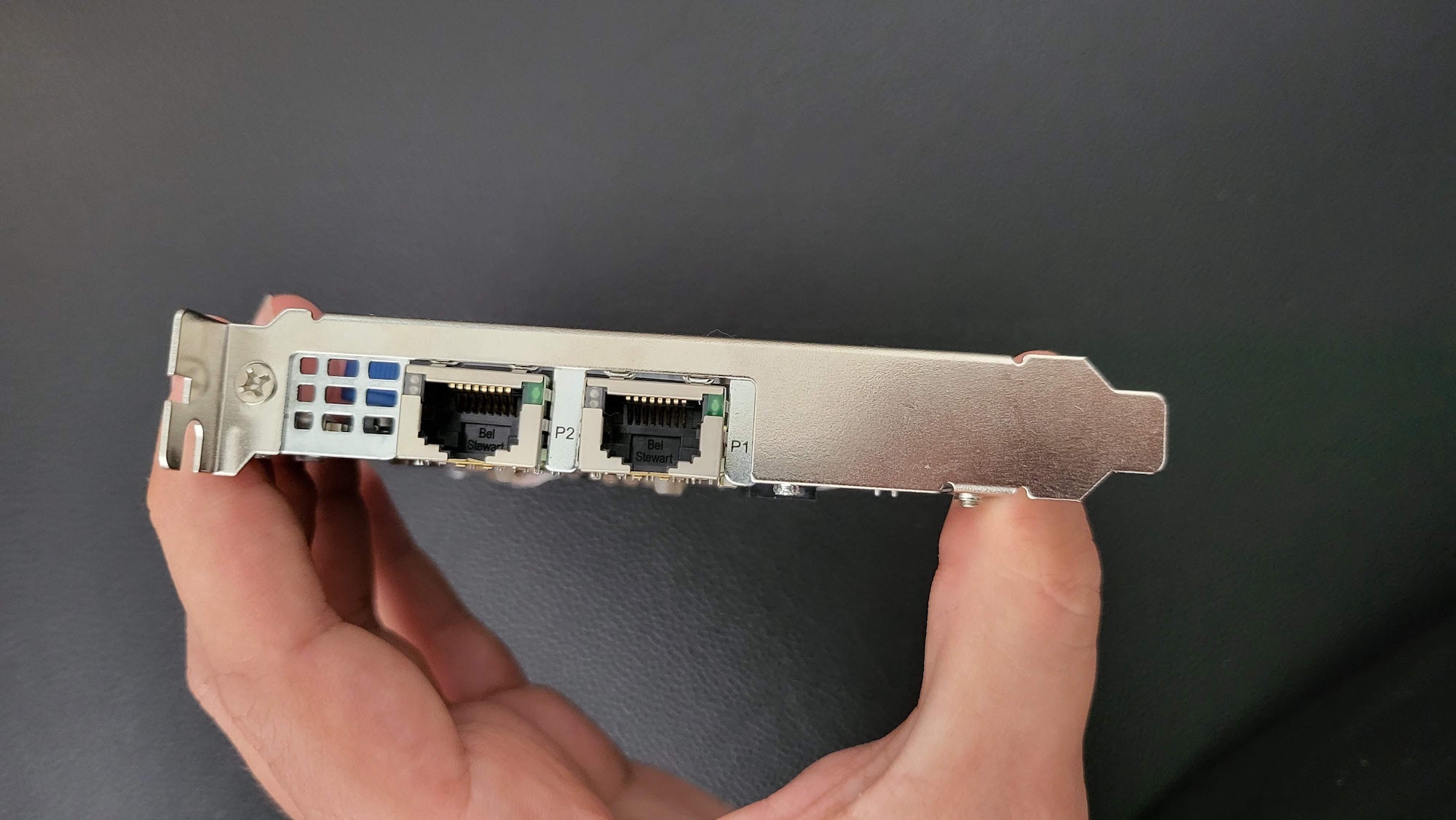

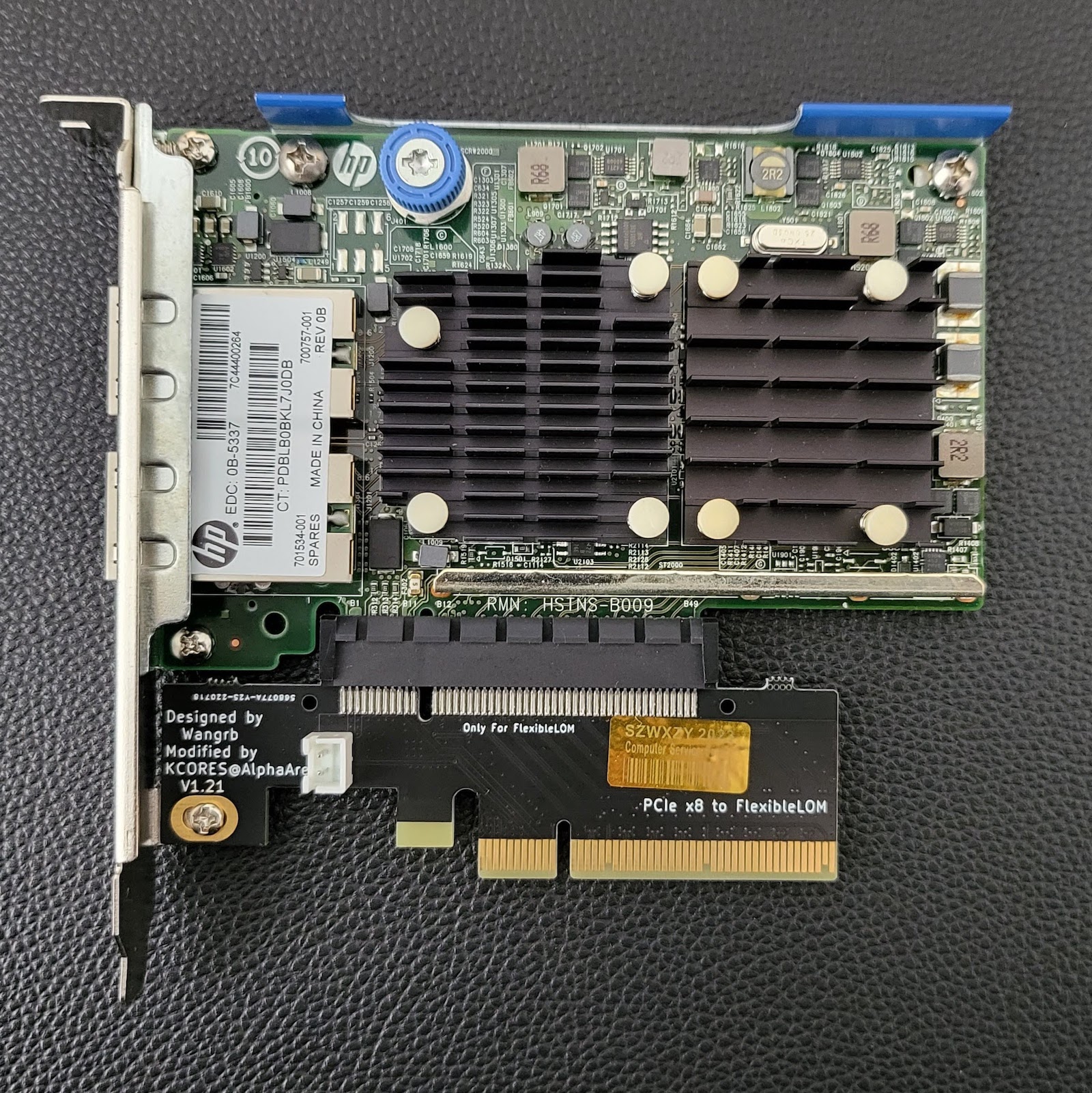

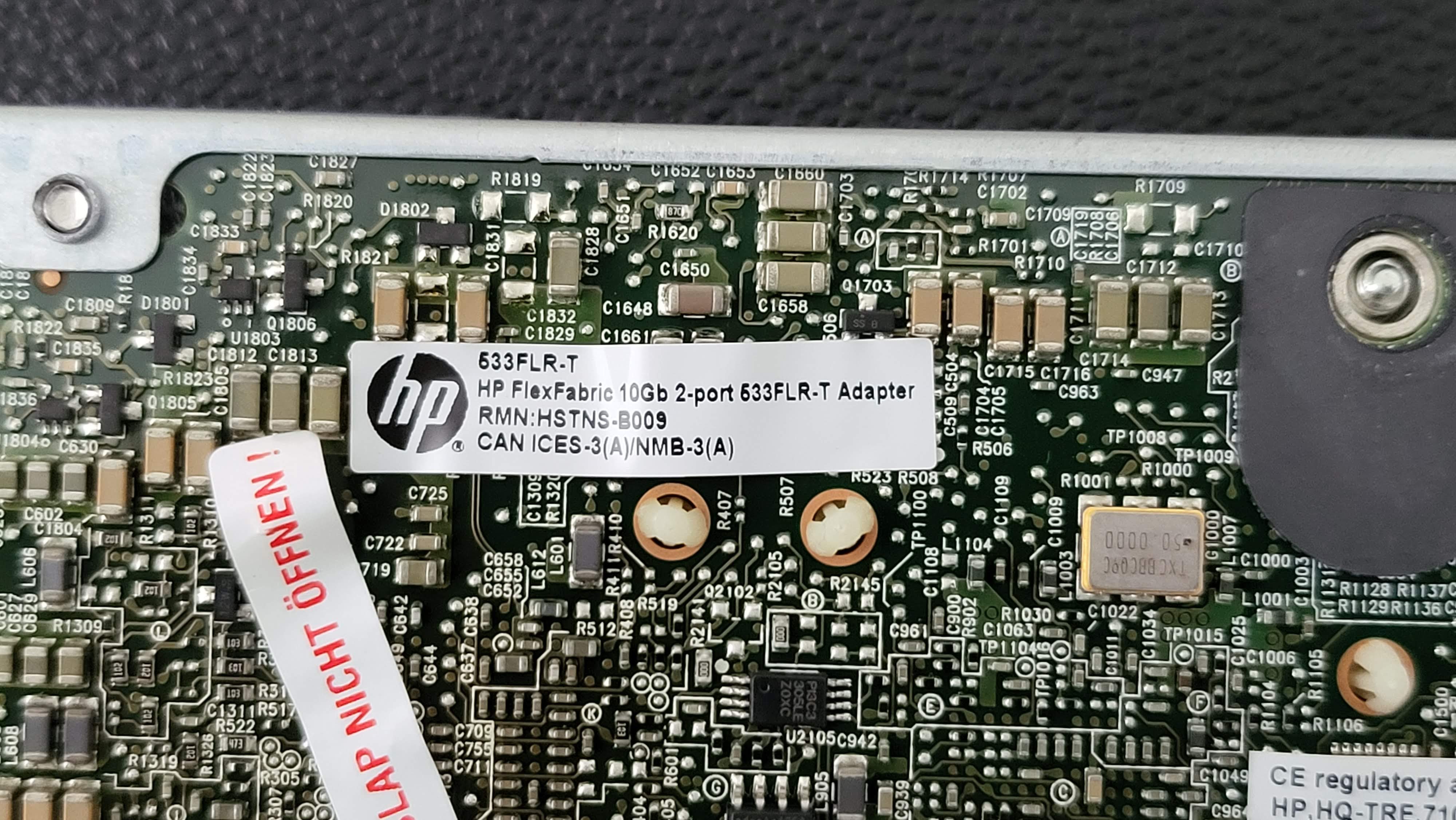

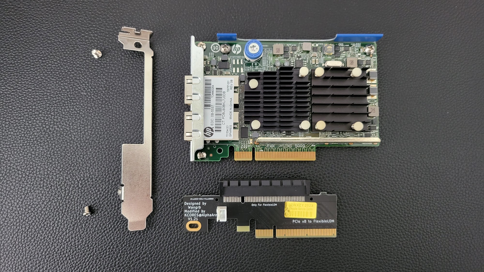

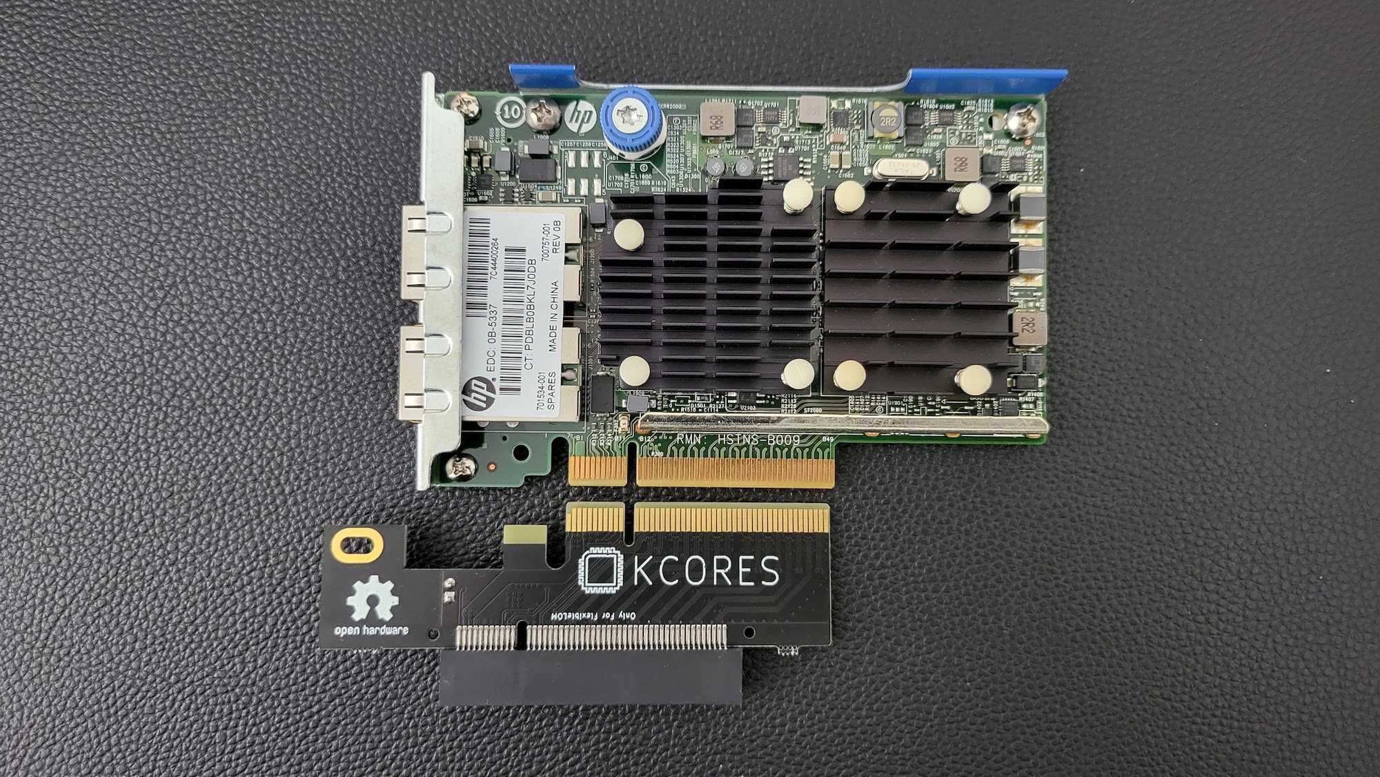

  14. Ich habe vor kurzem eine HP 533FLR-T 2-Port 10GbE Netzwerkkarte günstig gekauft (billiger als 20 Euro). Habe auch den PCI-E-Adapter (erhältlich als DIY-Teile oder zusammengebaut über eBay und AliExpress). Im zusammengebauten Zustand sieht es aus wie eine normale PCI-Karte mit Standard-Backplate-Halterung... Aber ich habe immer noch Angst, es in meinen Heimserver zu legen: D Muss aus alten Komponenten einen billigen Prüfstand zusammenbauen, nur um es zu versuchen. Hoffe es funktioniert mit Unraid.
