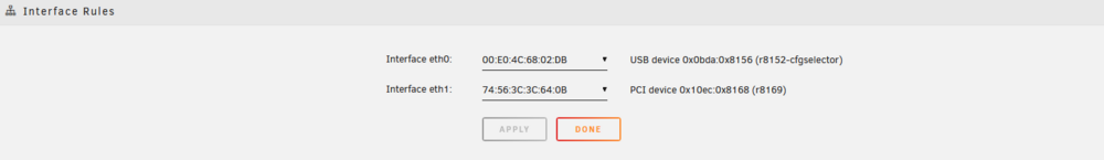

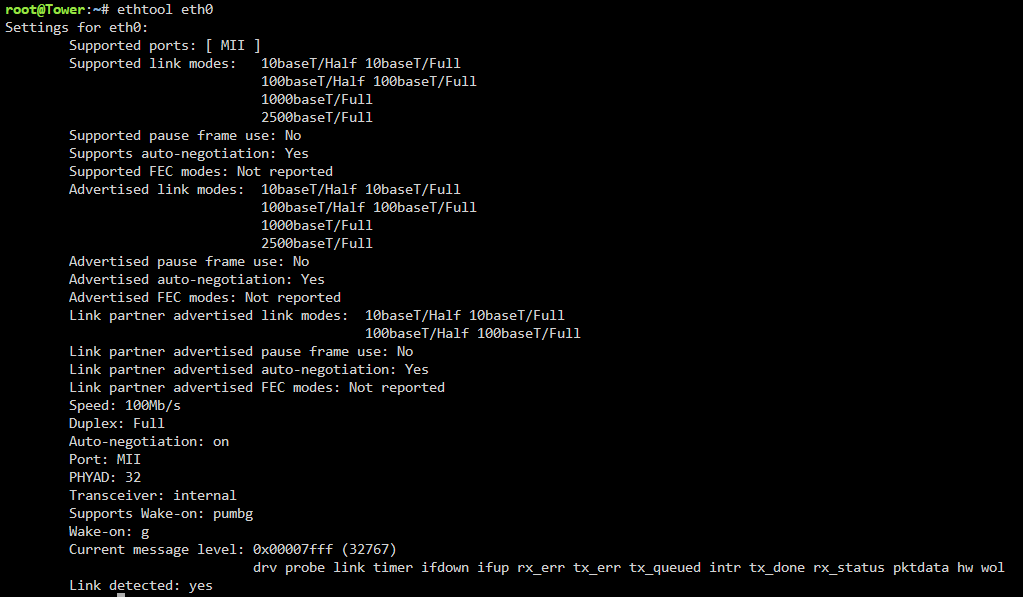

  2. Hi, might be late, but I think if you go into Settings > Network Settings you can switch from Interface Rules:
  3. Hello I tried to find a solution reading through this large topic, but ultimately i am stuck with my problem. I am using this USB network adapter : https://www.amazon.fr/dp/B0DM5GGT25 I change it to be eth0, changed the MTU to 9000 and, it is working somehow because I have access to the server and I see it in the System devices : Bus 004 Device 002 Port 4-2 ID 0bda:8156 Realtek Semiconductor Corp. USB 10/100/1G/2.5G LAN I see that he can achieve 2500 using ethtool : Yet i am stuck with 100Mbps speeds ... Can anyone have a look, please assume i am a not an expert ^^ thank you very much. tower-diagnostics-20250305-2055.zip
