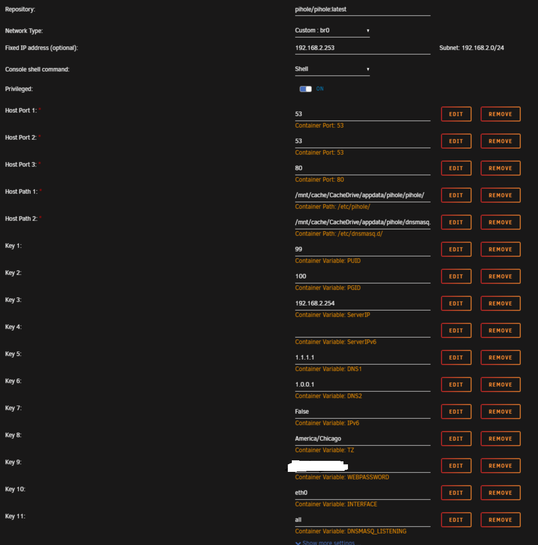

  1. @TheInfamousWaffles I am not running a bonded connection, but I do run a bridge, but I understand that you can bridge a bonded connection to allow VMs and dockers to communicate. I would suggest enabling bridging in your network settings and then running the Pi-Hole Docker in Network Type: br0 and setting a custom (unused of course) IP address and it's default port of 80. This is my setup and I have no issues running Unraid's web UI on port 80 (server ip ending in .254) and Pi-Hole's UI port on 80 (Pi-Hole's ip ending in .253).
  2. @TheInfamousWaffles with a quick look over I see that you are putting your DNS for the docker as itself... I am not saying mine is configured correctly, but I have my dns severs set up as traditional servers (i.e. 1.1.1.1 and 1.0.0.1) Here is a screenshot of my config. Unraid IP is .254 and Pihole is .253 for clarification of screenshot. Also, I setup with the help of this video:
