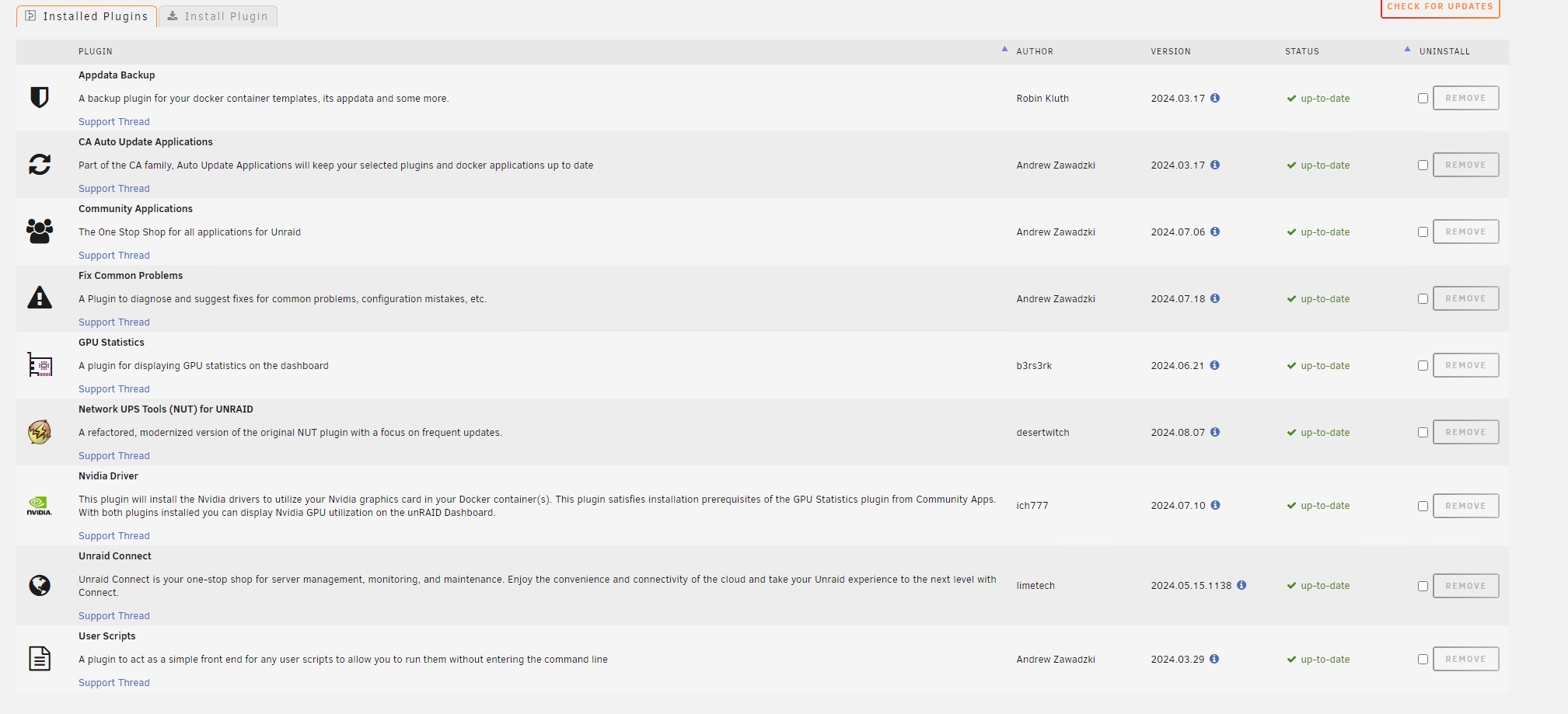

  1. Hello Unraid Community, I am experiencing several recurring issues with my Unraid server and am seeking assistance to resolve them. Here are the details: SMB Shares Inaccessibility: My SMB shares randomly become inaccessible after a few days, requiring a server reboot to fix. bzfirmware Checksum Error: Every time I perform a clean reboot, I encounter a bzfirmware checksum error and have to manually re-drop the necessary files onto the USB drive from the Unraid website while retaining the config folder. GUI Malfunctions: The GUI sometimes fails to display webpages correctly, necessitating a reboot which then leads to the bzfirmware checksum error above. I get the internal 500 server error nginix standard message. CLI Diagnostics Issue: Attempting to get diagnostics from the CLI results in a "bus error." sometimes. SSH and Direct Login Issues: SSH login via Putty provides no prompts, and direct login with a monitor, mouse, and keyboard results in a blank screen after login, preventing any command entry. Nvidia P2000 GPU Issue: My server has Docker containers for qBittorrent, Radarr, Sonarr, Bazarr, SABnzbd, and Plex. I use an Nvidia P2000 GPU for Plex transcoding. Recently, I encountered the following log messages: Aug 9 15:21:38 Tower kernel: NVRM: GPU 0000:01:00.0: RmInitAdapter failed! (0x22:0x56:878) Aug 9 15:21:38 Tower kernel: NVRM: GPU 0000:01:00.0: rm_init_adapter failed, device minor number 0 The GPU is no longer detected in Unraid. Additionally, I have reformatted and checked the integrity of the USB drive, confirming it is in 100% health. I have also checked the motherboard, and everything appears to be in good condition. I don't have a lot of plugins, just the main ones like Nvidia driver, UPS NUT settings, Community Applications, Appdata Backup, and Auto USB Reboot. These issues are making it difficult to manage my server. Any help or suggestions would be greatly appreciated. I am getting seriously sick of all these issues that keep happening, my UNRAID server is basic nothing crazy, just a media server with a Windows VM and GPU installed and some plugins yet it keeps crashing and corrupting itself and now I am unable to safely reboot it via GUI, terminal or physically at the host. I am also limited in experience with Linux so any help is appreciated team. Also I'm hesistant to just cut the power in-case I have data loss, any advice please? Thank you! Warm regards. EDIT: So my server was totally unresponsive, I could not access web gui, SSH or physically at the server with monitor and keyboard it was not responding to commands so I had to just kill the power. It booted back up fine, I was on Unraid 6.12.6 a bit old didn't realise newer versions out it did not notify me, so I incrementally upgraded it to 6.12.11 now latest stable so hopefully that can help. I have deleted a few more plugins too. Server is stable again but usually this cycle of issues repeats itself after a few days. I've attached a photo of my plugins.
