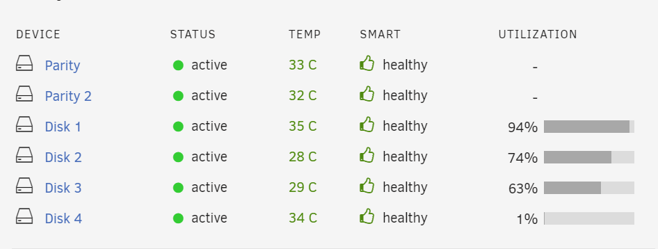

  10. Hi, wondering if I can get some thoughts on the below. I installed 2 new disks into my array and tried to assign one to parity The array would not build due to incorrect arrangement. I searched the forums and found this was a bug. Following the post I set both disks to data disks then moved one into Parity which worked really well. However it left me with the system reporting disk 5 as not installed (It is now parity 2). This is not a huge problem, but the array reports incorrect space on the main tab now. The dashboard reports the correct number of disks. All the drives seem to be working correctly, and reporting no errors. It seems as though moving disk 5 to Parity has worked but just not reporting it through the main tab. Screen shot below shows disk 5 which is now parity but still reporting space: The below is from the dashboard is what I would expect: Any thoughts on how to stop disks 5s space showing would be greatly appreciated
  11. Legend @JonathanM, many thanks, I think you might be right.

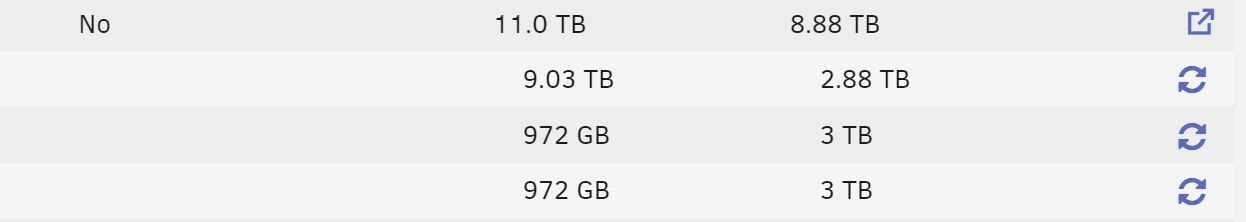

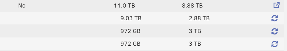

  12. Hi, new to Unraid but loving it. I have an odd issue with my drives that I would appreciate any thoughts on. Hopefully I am just missing something in the problem below. I have 4 drives, 2 x 12tb and 2x4tb, one of the 12tb drives is my parity drive. I have allocated the 3 remaining drives to a share to give me 20tb. I copied 9.98tb from my server into 4 folders on my Unraid share. However my Unraid share is showing 11tb used. I cannot fathom where Schrodinger's 1.02tb has gone. If I look at the share from the perspective of my server it shows 9.98 but Unraid is reading out 11tb. I have compared the size of each folder to be sure and they match 9.98tb however Unraid at the share level shows 11tb. I've attached images below, as I say, any thoughts would be appreciated. Unraid 4 folders across the 3 drives equating to the assumed 9.98tb Unraid share from the perspective of the other server Unraid share from the perspective of Unraid (12tb drive plus the 2 remaining 3tb drives
