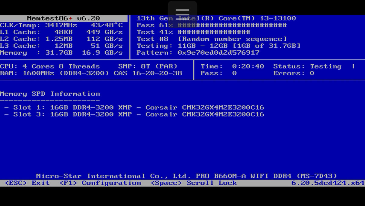

  4. What I’ve found is the machine reboots. That’s why there is a network connectivity drop. i will send you some syslog files if that helps? these are the ones written to the usb flash drive

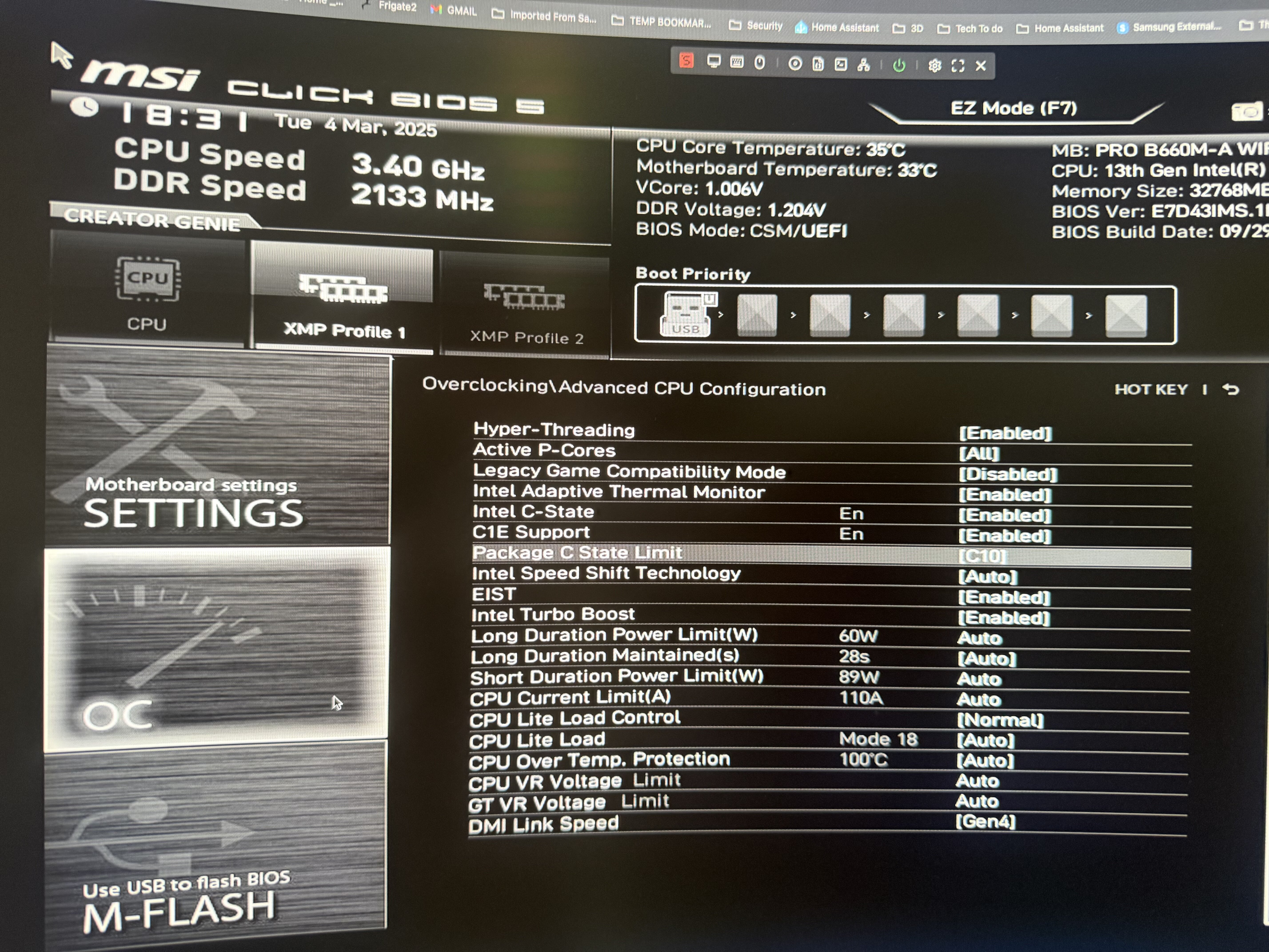

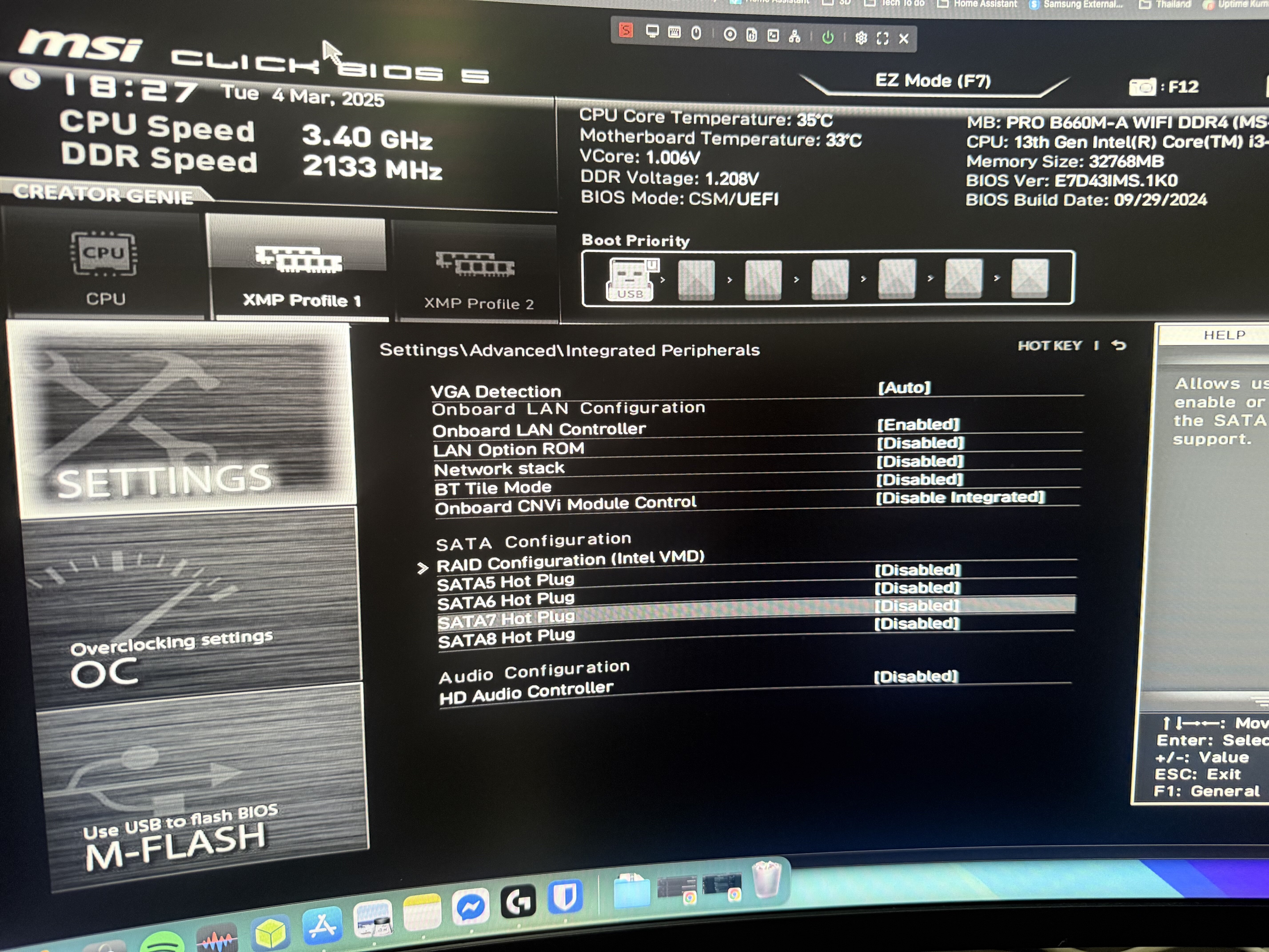

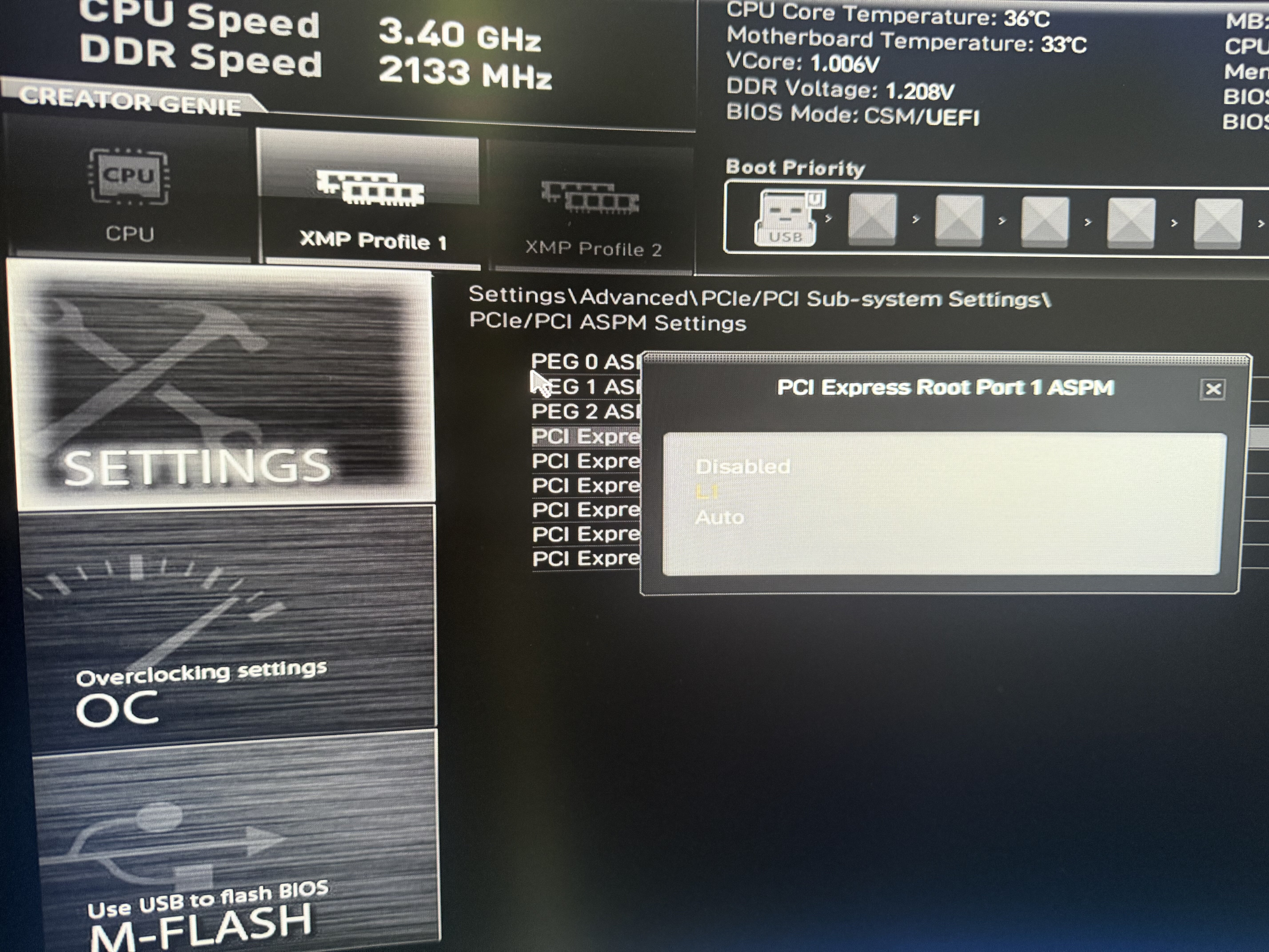

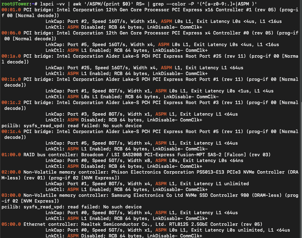

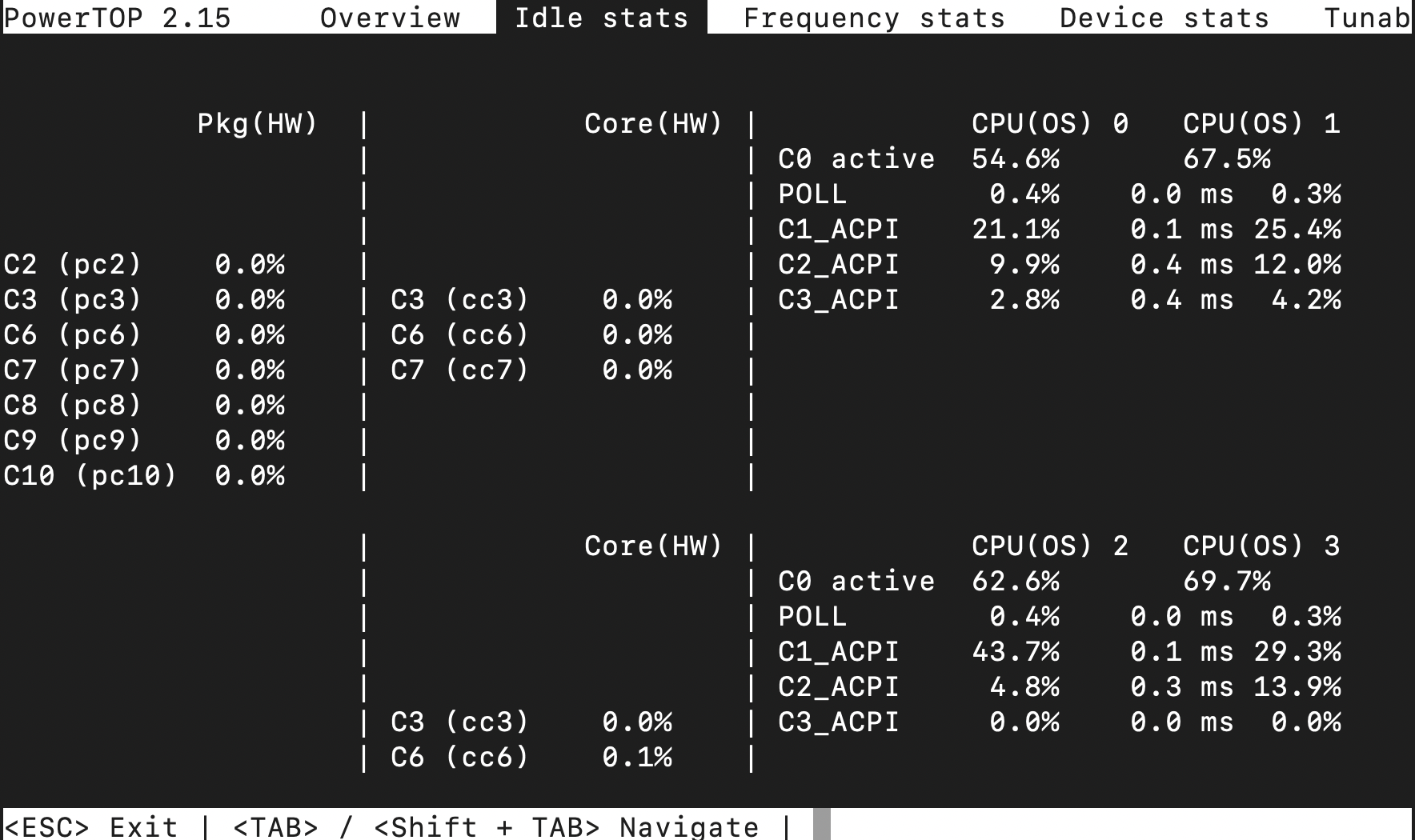

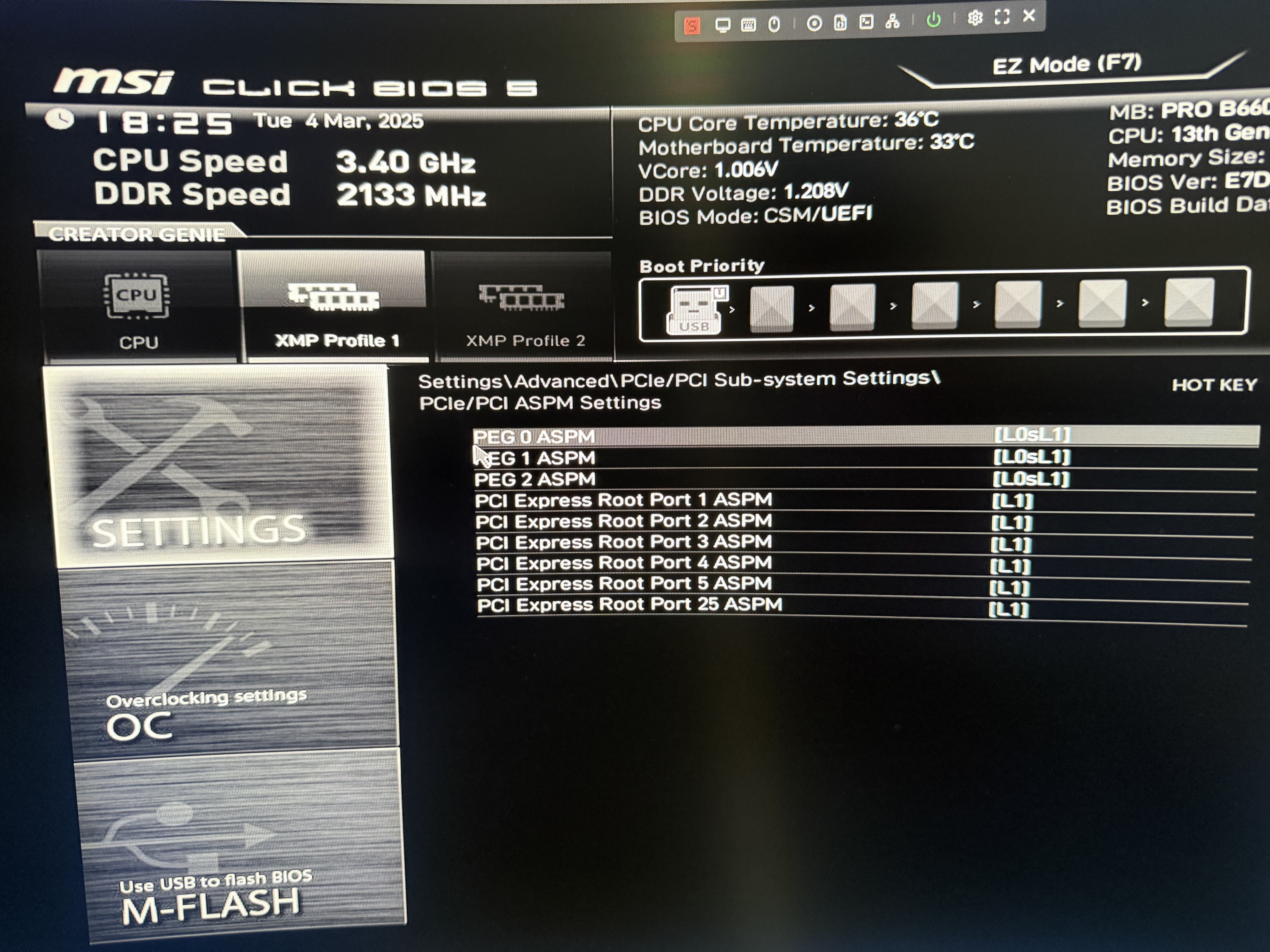

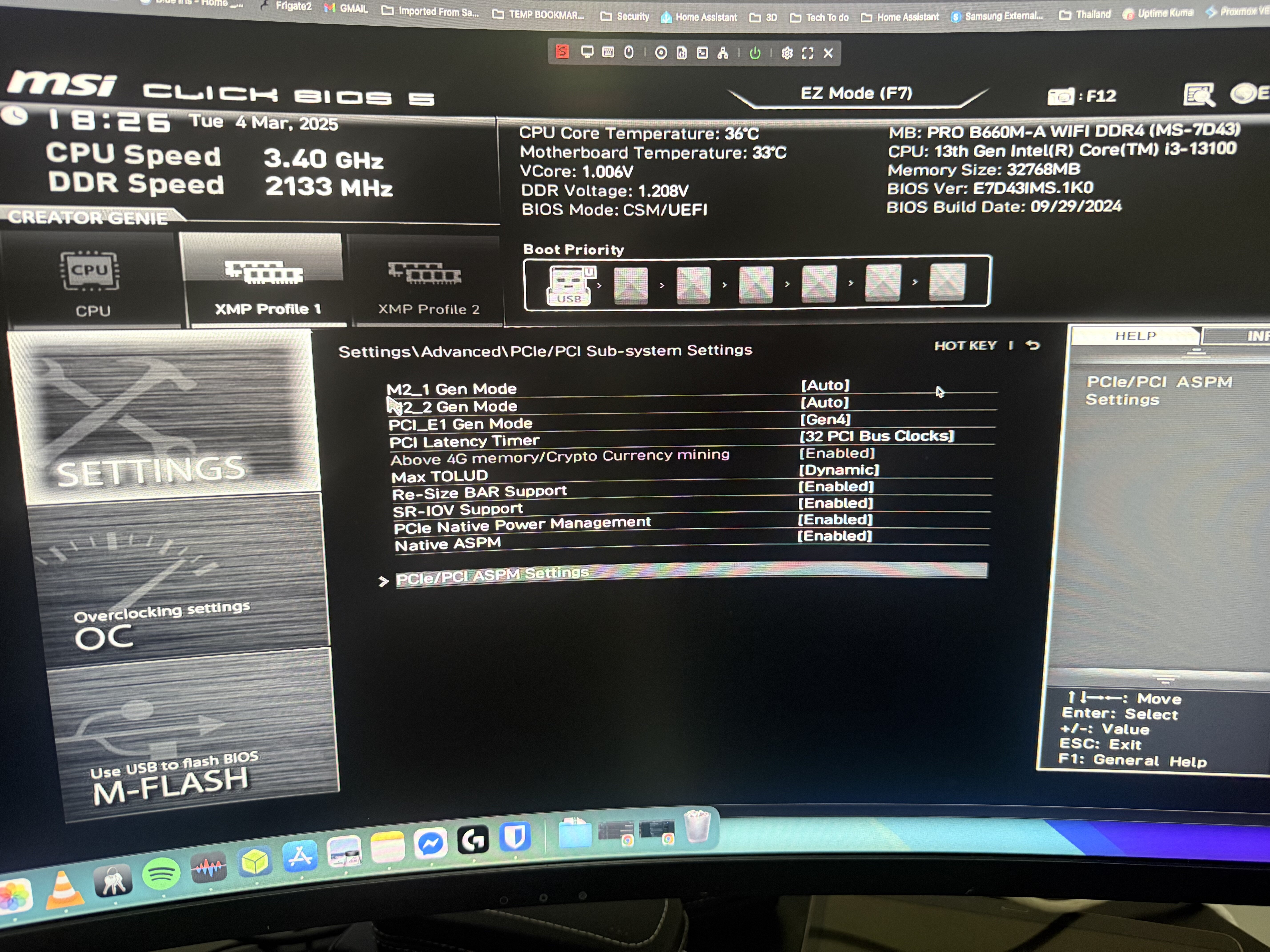

  11. I've runt Powertop --autoconfig (or the equiv. command) but am not seeing any reduction in power using C States. Is this likely due to me having 2 VM's running? Have enabled the CStates settings in Bios to L0 and L1s as well. Taken them off auto. PRO B660M-A WIFI DDR4 (MS-7D43) with a Intel i3 13100 CPU.

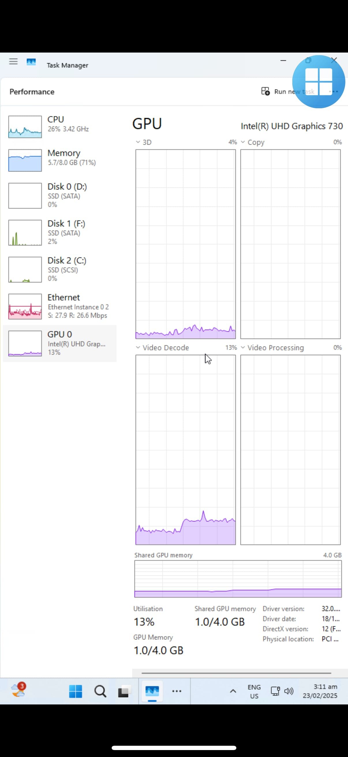

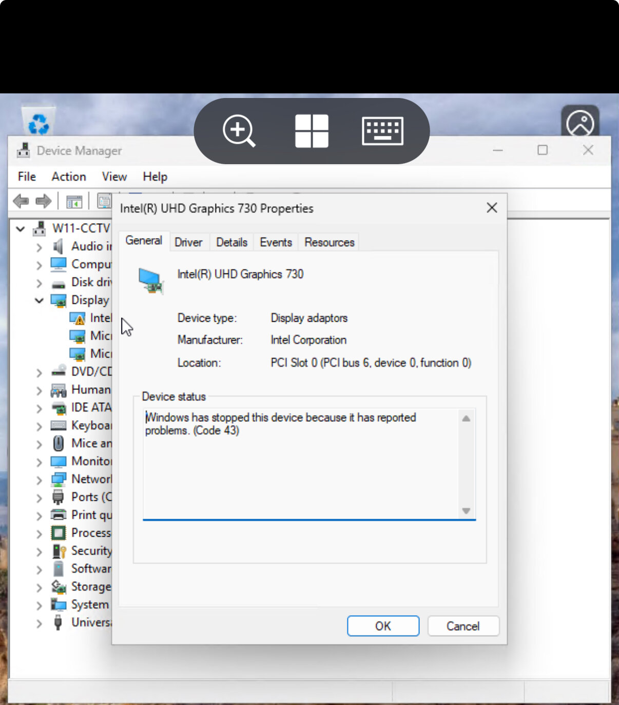

  12. Thank you so much for posting this!!! You helped solve the issue of the Error 43 I was having above!

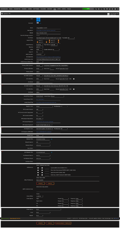

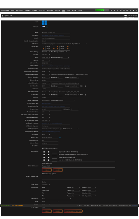

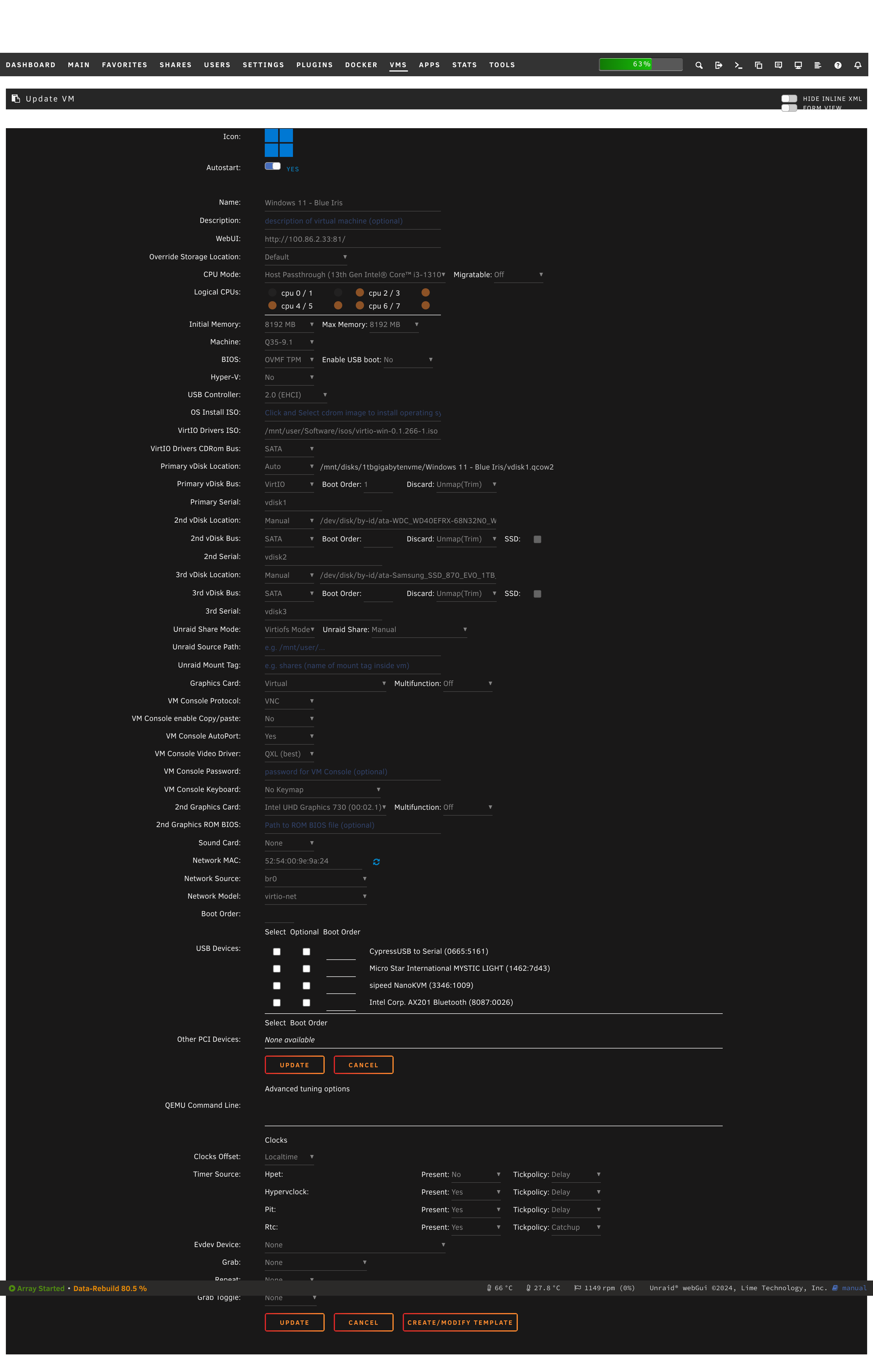

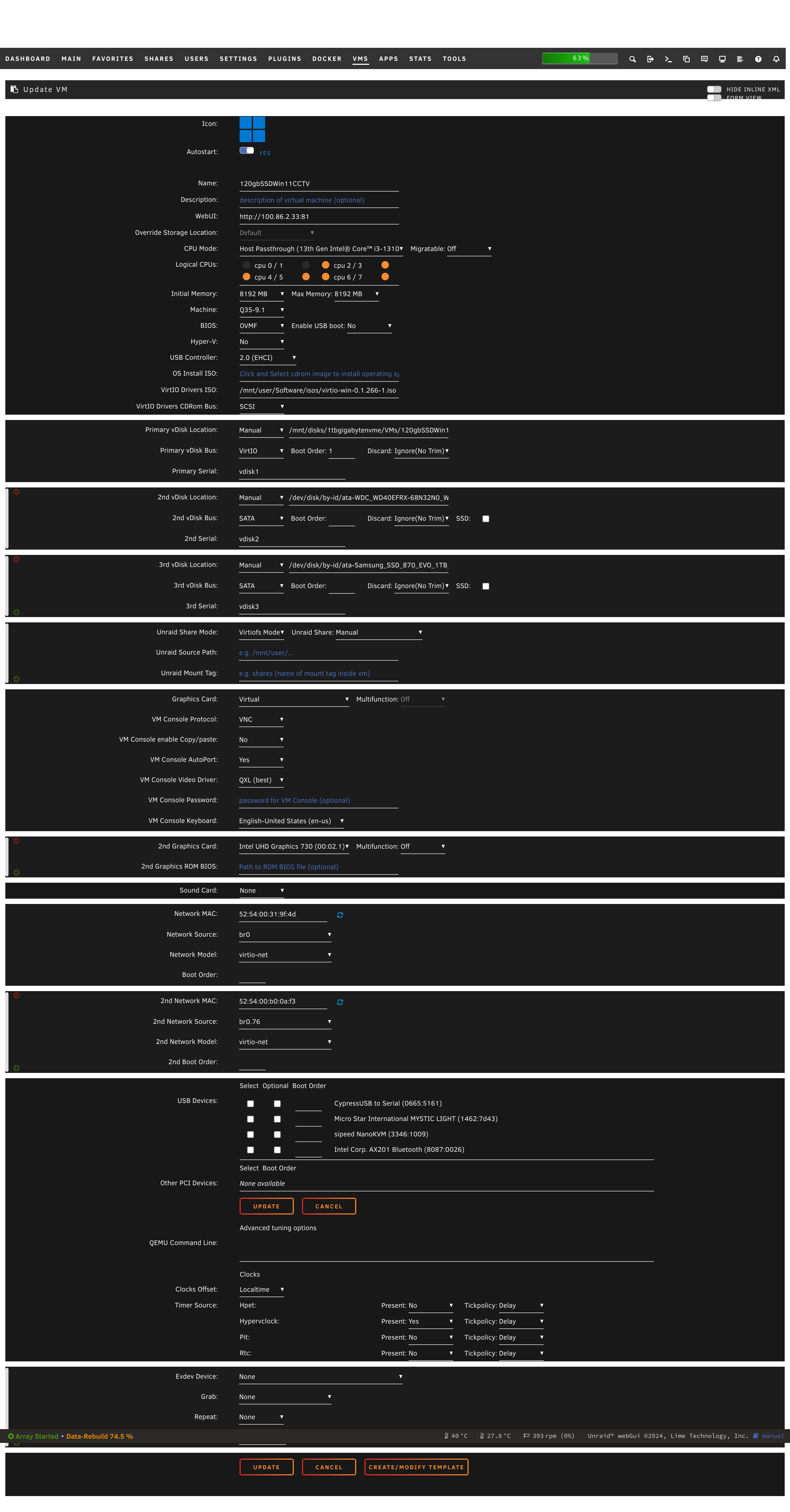

  13. Update: I shut down the VM Uninstalled the plugin rebooted the server reinstalled the plug in set the virtual card number to one. restarted the server.. reassigned the virtual GPU and still no success. any help would be appreciated. attaching screenshot of the error I am facing. as well as a screenshot of how it looked before I assume the vdisk got corrupted not allowing me to boot from it.
