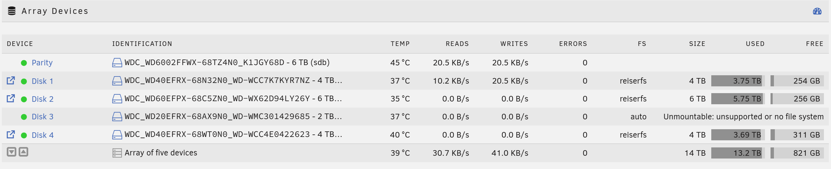

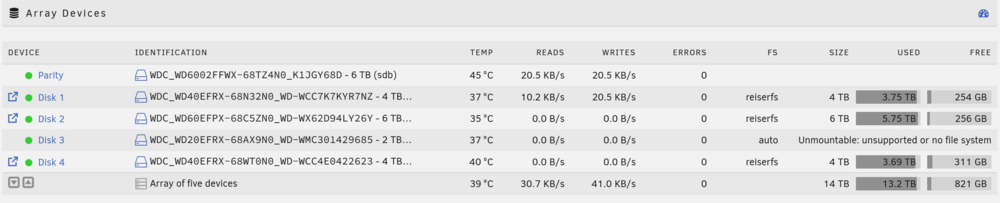

  4. MY GOSH, THANK YOU! See screenshot. I did a quick browse and can see the files now on Disk2 as before. The 'auto' designation switched Disk2 back to its original ReiserFS. Disk 3 still shows it as Unmountable, as I erased it as intended to go to XFS. Thank you again JorgeB! Now, let me step back and describle my INTENDED plan: Remove all data from riserfs Disk3 (Complete) Convert Disk3 to XFS, remount and test/align with parity (current 'unmountable' issue) Unmount and wipe Disk3 for use elsewhere Swap in a 6TB drive to Disk3 to replace the 2TB XFS drive, align with parity Move data (one at a time) from the other existing reisferFS drives to an XFS drive THEN convert each remaining reiserfs disk one at a time to XFS. Should I still convert the 2TB drive to XFS, fix the unmount issue and repair parity, then swap with the 6TB as a larger XFS drive? What is the unmountable issue with the erased drive to XFS? Should I perform the 'XFS Repair' I have been reading out? Just not 100% sure at the moment, and feel a quick review here is best before I jump into it again.

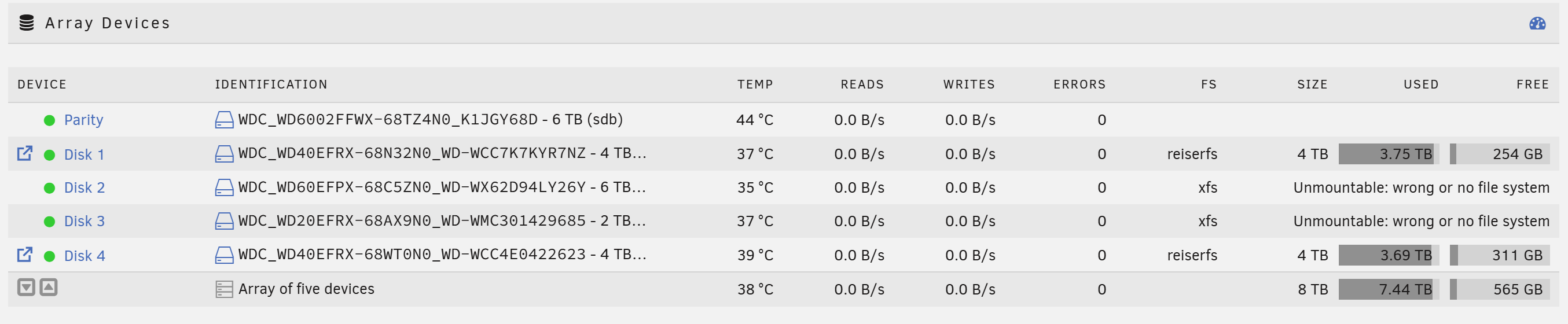

  5. With the array offline originally, I changed the disks to XFS in the dropdown and hit Apply. Due to me being on 7.2.2, I cannot re-select reiserfs from the drop down to the depreciation. What I'm hoping is that since they were never mounted, I find a way to change the format back to reiserfs, and get them to mount to the original configuration. That's where I'm stuck currently, trying to make a workign copy of my flash on a secondary flash drive, but with 6.12 bz* files. Not working yet.

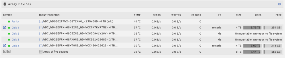

  6. Hi Everyone, My setup: 1 Parity drive, 4 Data drives Unraid 7.2.2 Goal was to finally move my ReiserFS drives into XFS configuration. I have a 2TB drive that I moved all data off of to my other 3 drives, and planned to convert that disk to XFS. Royally screwing up, I mixed up in my head Disk2 (6TB drive) with Disk3 (2TB drive). Disk2 now is converted to XFS. In my panic, I converted Disk3 as originally intended to XFS as well. Now, the array for both Disk2 and Disk3 say 'Unmountable: wrong or no file system'. They have not been mounted back to the array due to this incompatibility message. I've been trying to find a way to revert back to 6.12, to allow for me to bring one or both of the drives back to ReiserFS, so I may attempt to repair them with the Parity. Current path is trying to create a copy of my flash OS drive on another flash drive and manually replacing my 7.2 setup with 6.12 setup, but having some issues getting it to show up currently. My intention was to revert Disk3 back to ReiserFS, get it back in line with the Parity, then do the same for the 6TB drive. Is all hope lost for the data on those drives? Or is there a process where I can reverse what I did, then carefully transition the proper way? If not, any way to get the data off of that 6TB drive in some fashion using another computer setup?
