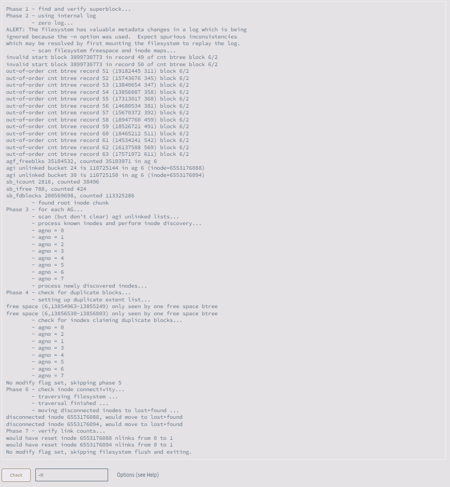

  6. This is the output I get from the filesystem check. I'm not sure what to do here as it's not asking for any options to be set although it would have fixed something? Is it safe to run with -L?

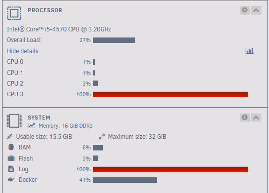

  14. I was doing a parity swap procedure to replace my current 4TB parity drive with my new 8TB drive and then replace disk 1 with the 4TB. It was running fine at 90-100 MB/s but has now fallen down to 1.4 MB/s and seems to be staying there, I can't seem to find a cause for this. All Dockers are stopped and the 1 VM I have is shutdown. I've attached diagnostics. 1 CPU core seems to pegged at 100%, I assume this is normal during a rebuild? The log also seems to be taking a large amount of memory. Any help is appreciated. tower-diagnostics-20240228-2226.zip
