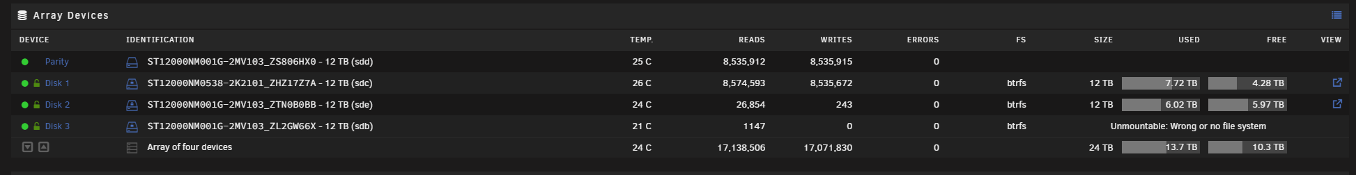

  17. Hey JorgeB - Again appreciate all of your time - I tried some of your methods, before I go to your 3rd dangerous option wondering if you could see if I am doing your other two options correctly or not? Here's what I tried in terminal - root@Saber:~# mkdir /temp3 root@Saber:~# mount -o rescue=all,ro /dev/mapper/sdb1 /temp3 mount: /temp3: special device /dev/mapper/sdb1 does not exist. dmesg(1) may have more information after failed mount system call. root@Saber:~# mount -o degraded,rescue=all,ro /dev/mapper/sdb1 /temp3 mount: /temp3: special device /dev/mapper/sdb1 does not exist. dmesg(1) may have more information after failed mount system call. root@Saber:~# cd /mnt/disk2 root@Saber:/mnt/disk2# mkdir restore root@Saber:~# btrfs restore -v /dev/mapper/sdb1 /mnt/disk2/restore ERROR: mount check: cannot open /dev/mapper/sdb1: No such file or directory ERROR: could not check mount status: No such file or directory root@Saber:~# btrfs restore -v /dev/md3 /mnt/disk2/restore No valid Btrfs found on /dev/md3 Could not open root, trying backup super No valid Btrfs found on /dev/md3 Could not open root, trying backup super No valid Btrfs found on /dev/md3 Could not open root, trying backup super root@Saber:~# btrfs restore -v /dev/mapper/md3 /mnt/disk2/restore No valid Btrfs found on /dev/mapper/md3 Could not open root, trying backup super No valid Btrfs found on /dev/mapper/md3 Could not open root, trying backup super No valid Btrfs found on /dev/mapper/md3 Could not open root, trying backup super root@Saber:~#
  18. Output below - root@Saber:~# fdisk -l /dev/sdb Disk /dev/sdb: 10.91 TiB, 12000138625024 bytes, 23437770752 sectors Disk model: ST12000NM001G-2M Units: sectors of 1 * 512 = 512 bytes Sector size (logical/physical): 512 bytes / 4096 bytes I/O size (minimum/optimal): 4096 bytes / 4096 bytes Disklabel type: gpt Disk identifier: 079AAD43-C6C4-4769-BB43-B69CFE630BFD Device Start End Sectors Size Type /dev/sdb1 64 23437770718 23437770655 10.9T Linux filesystem root@Saber:~#
  19. Thats strange, its been btrfs for the 2 months now and no problem and it has about 2TB of data on it prior to restart - here's the output of your command - Appreciate any and all help and your time. root@Saber:~# btrfs fi show Label: none uuid: 10091590-8586-45b5-82b5-654bd5cd3b71 Total devices 1 FS bytes used 7.01TiB devid 1 size 10.91TiB used 7.05TiB path /dev/mapper/md1 Label: none uuid: 7860e9cf-a7d1-4473-adfb-b67685f33db2 Total devices 1 FS bytes used 5.47TiB devid 1 size 10.91TiB used 5.53TiB path /dev/mapper/md2 Label: none uuid: e2bcedfe-609f-40ce-9531-11ef1b201d31 Total devices 1 FS bytes used 70.76GiB devid 1 size 931.51GiB used 556.02GiB path /dev/nvme1n1p1 Label: none uuid: e6def48b-8343-4c23-b729-d0e6bf475ca6 Total devices 1 FS bytes used 16.34GiB devid 1 size 232.88GiB used 23.02GiB path /dev/nvme0n1p1 Label: none uuid: 31006f9a-9233-4419-a454-43b4e4bdb1c0 Total devices 1 FS bytes used 15.58GiB devid 1 size 35.00GiB used 22.02GiB path /dev/loop2 Label: none uuid: c9ad3558-6606-44e2-b4ef-6a95aac5ceaf Total devices 1 FS bytes used 988.00KiB devid 1 size 1.00GiB used 126.38MiB path /dev/loop3 Also a screenshot of the device array area (they are all btrfs encrypted) -
  20. So I did a clean reboot of my system and when it booted back up disk 3 now says unmountable wrong or no file system. The drive has been working up to this point (I put this drive in probably 2 months ago or so). Additionally until stopping and starting the array a few times it also failed to load the docker (but they are now being loaded). I have three drives, they are all btrfs (which i know i should change that and might do that with unbalance after i get this drive back up and running if i can). Any suggestions on how I can get it mountable and move the stuff off of it? I appreciate all of your help and have attached diag. saber-diagnostics-20231122-2235.zip
