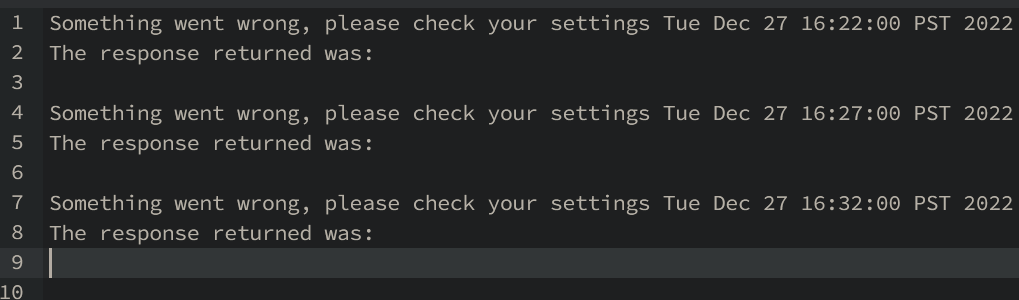

  9. I'm having issues with getting this docker working, all I'm getting are these statuses in the log: Not entirely sure what to do without any response codes. Any debugging steps I should take? Edit: I checked my log terminal and I'm getting the same error as @Luc1691 - curl: (3) URL using bad/illegal format or missing URL. I've tried just the subdomain name without duckdns.org, the entire url, adding http://, etc., and none have worked.

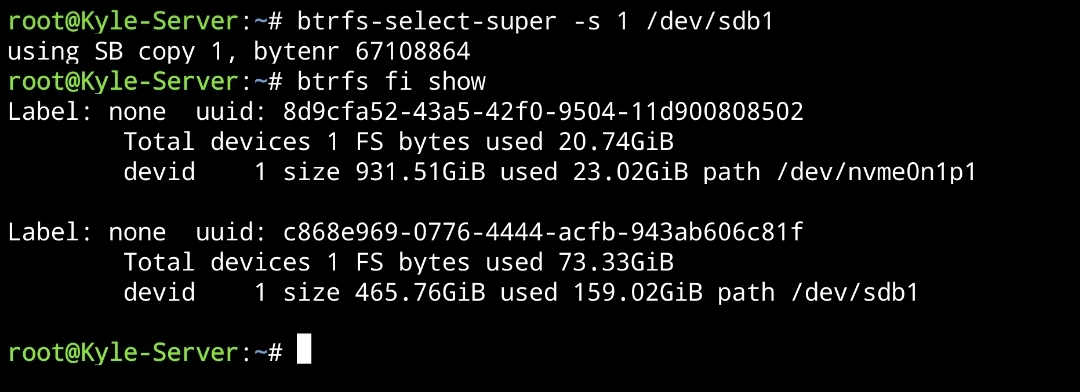

  12. Alright, I'll play around with it some more and see if I can get things back to where they were. I downloaded Dynamix File Manager to make a backup of the old cache on my array and will copy it to the new cache from there as well. Thanks for all of your help! Edit: it worked! All Docker/VMs restored and working!
  13. Update, I added it to a new pool named testrestore and I can see my old data, thank you! Now can I just transfer this to the new drive in the other cache pool to restore my Docker/VMs?

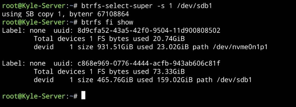

  14. So, shut down the array and add it to a new pool? When both devices are in the pool what happens at that point, will the data be restored to the new device?
  15. Fortunately it doesn't appear to have been wiped: The mount button is no longer grayed out with Unassigned Devices but the partition size says 0B. Typing this from my phone but I'll take a closer look soon.
