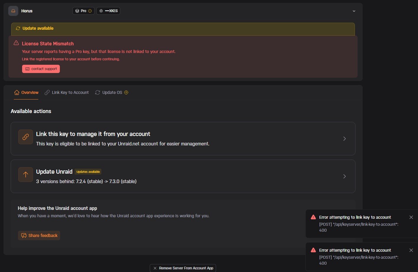

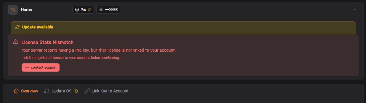

  7. Hmmm... there is a plugin needed? Where can i check this? EDIT: Installed a Plugin called "Unraid Connect" (2026.05.11.1745) but got the same Error... Key can not be linked to my profile... Is this "linking" necessary for internal boot or can i skip this?

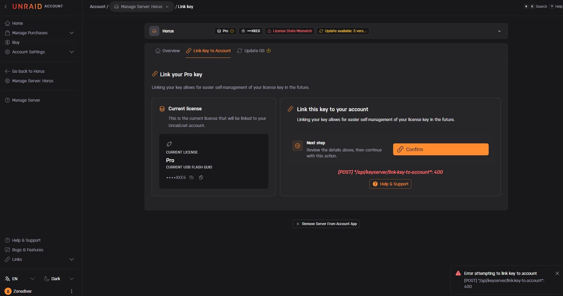

  8. Here a screenshot from https://account.unraid.net/server/link-key

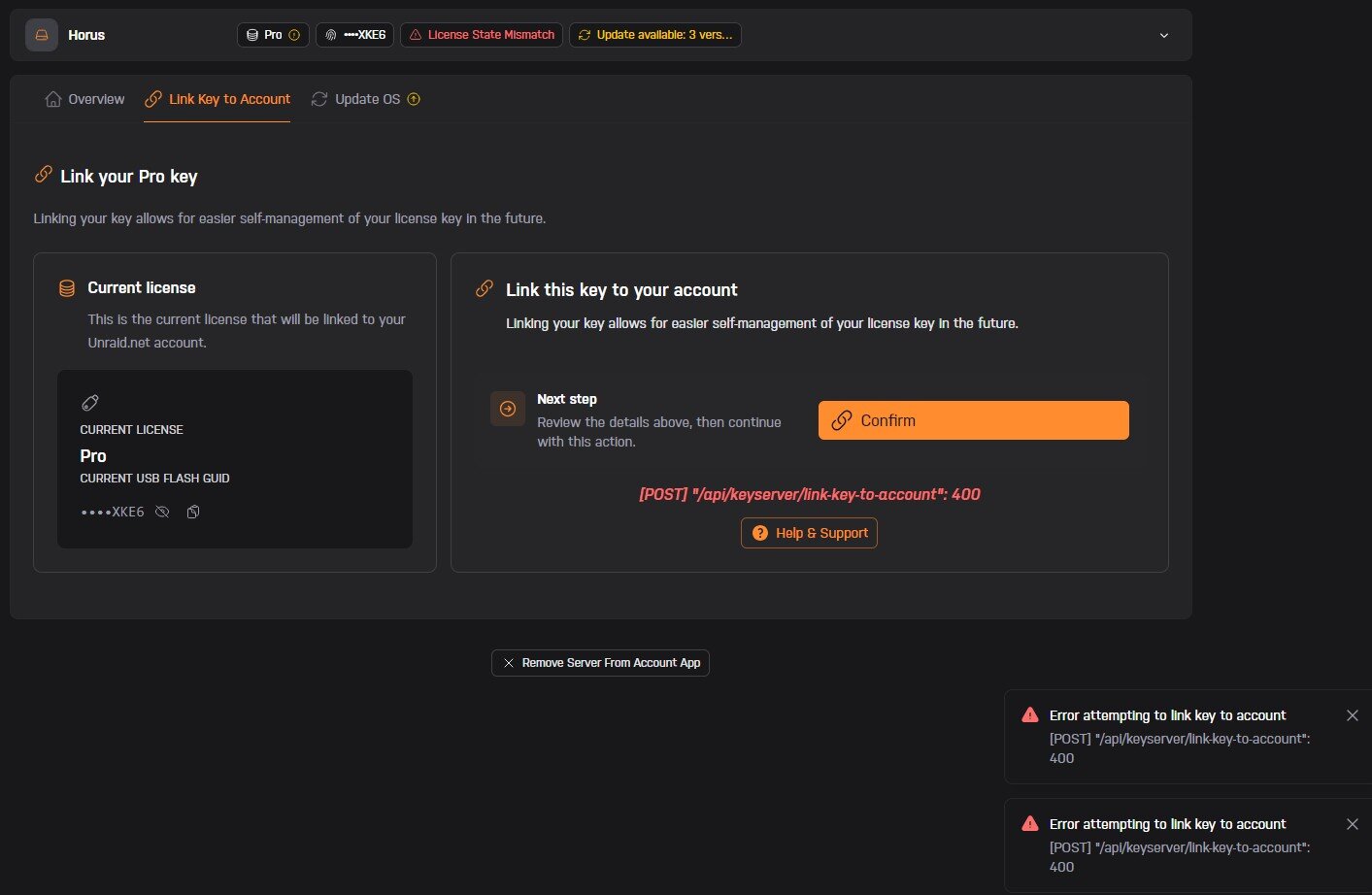

  9. Well... I tried it several times and got this...
  10. Can someone explain, what this means?
  11. ...i am confused...

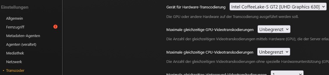

  12. I use the plex docker from linuxserver.io with a plex pass and the latest Plex version 1.43.1.10611 - HW-transcoding is working fine 👍
  13. At the Docker, use "Host" - thats all you need. And you ned "also" to select the iGPU at the plex settings...
