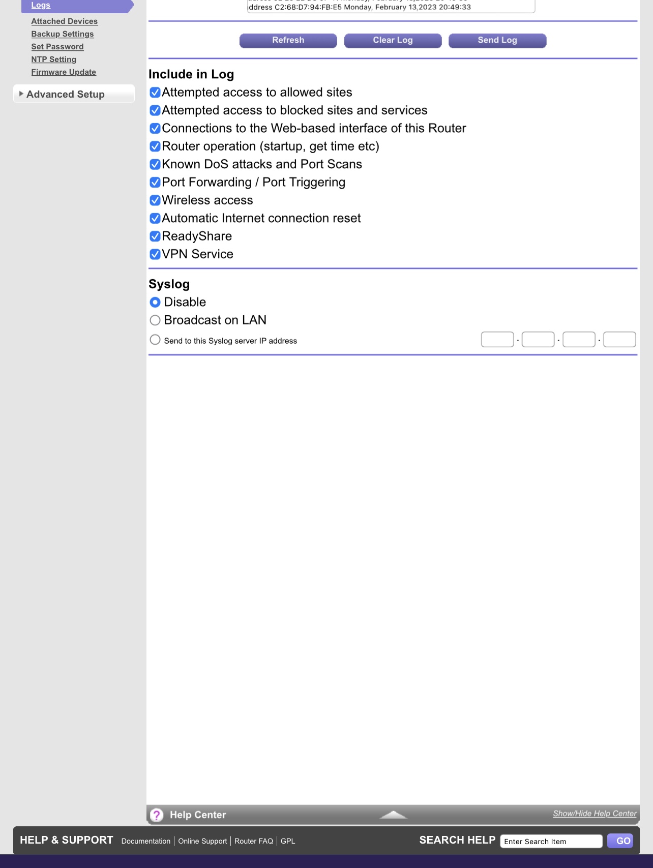

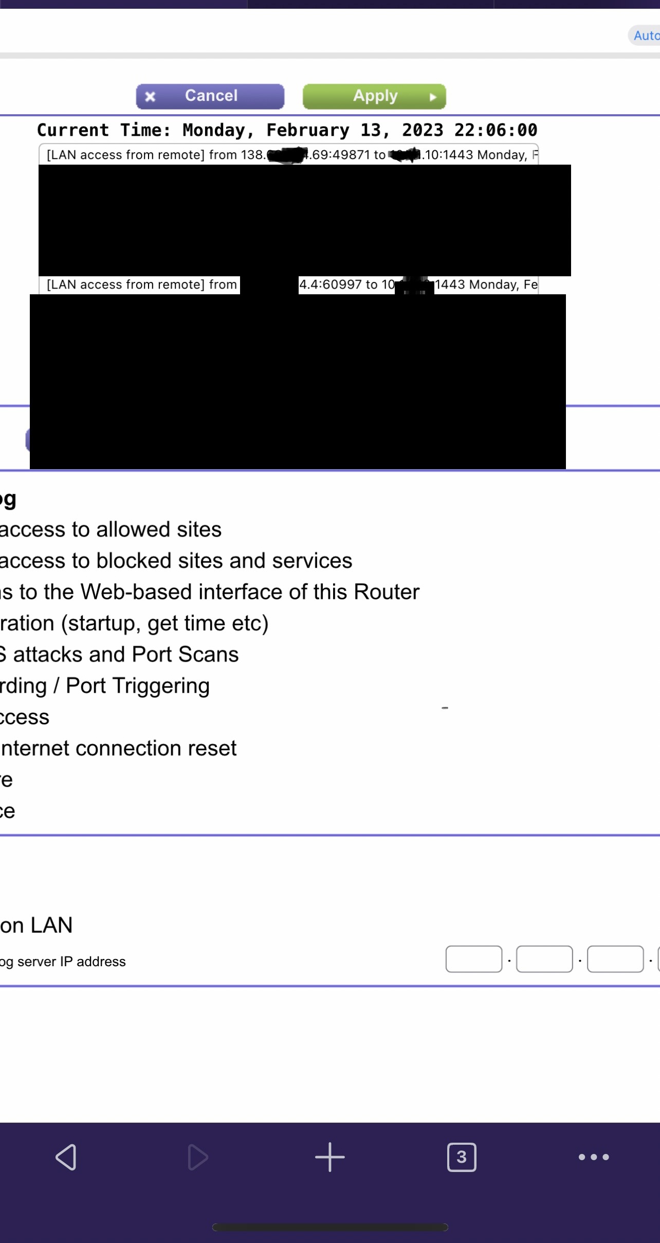

  13. Hello Unraid Community! From what I understand, having any port open is dangerous, but I currently have port 443 port forward to 1443 for my nextcloud server. Although my nextcloud accounts are secured with a very strong password, how big of a security risk is this and is there a better way to do this? I ask this as I have recently noticed “LAN access from remote” on my wifi logs which reference the port 1443 and I don’t recall the ip’s (image attached). Am I doing something stupid here that I don’t properly understand? I mostly followed space invaders tutorial for this but with a few steps missing related to duck dns from what I remember but I did get it all working.
