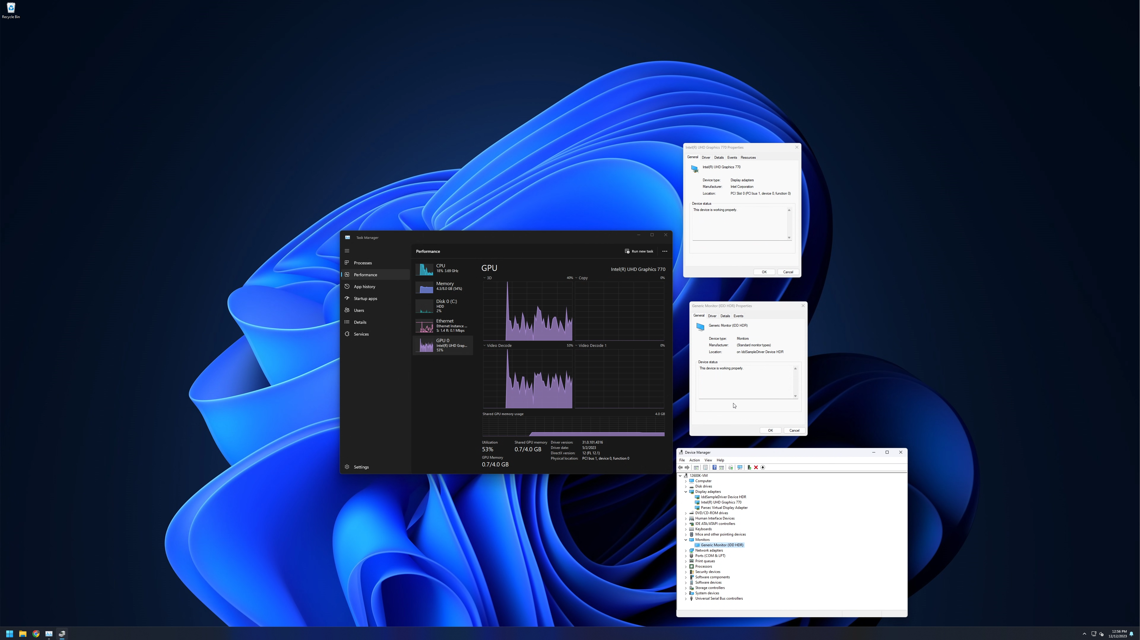

  1. So I was at the exact point you were at last night. I googled a bit more, and I came across this post by scoops22 on reddit (attached to this reply). Using the older intel driver and the virtual display from MikeTheTech worked! I can now use Sunshine to stream from my 12600k iGPU. Thank you everyone involved in making this work!

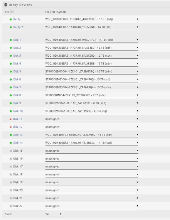

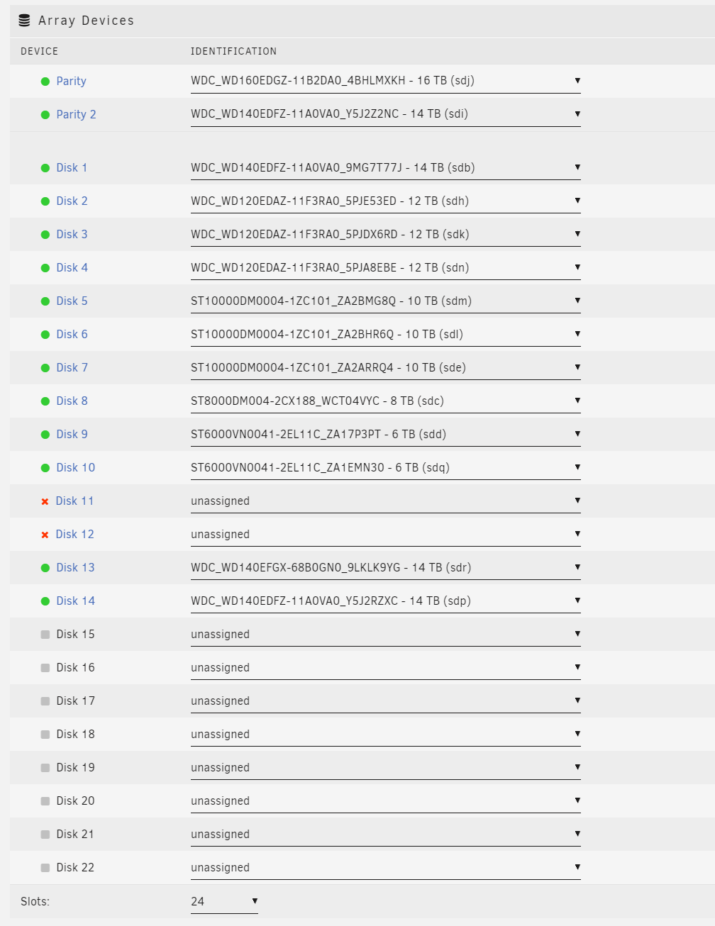

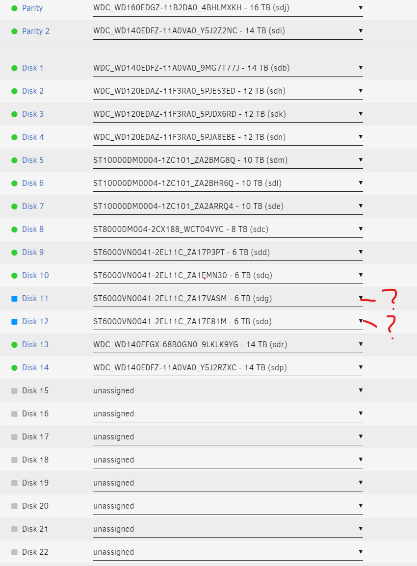

  2. Okay, Bigger problem now. I decided to just start the rebuild. When I started the rebuild, unraid instantly spat out that parity 2 had an error and now the status shows that "Parity device is disabled". I checked it, it was a SMART error UDMA CRC error count with error value of 8. I read the forums, replugged everything in, clicked the error icon so that it looks healthy now, but the parity drive is still disabled. The error count hasn't gone any higher It looks like I can still see all of my data, I'm backing it up now... but is there a way to fix this??? Rebuilding parity is throwing out a lot of errors, but it seems I can still access most if not all of my data. I've attached the diagnostics below. ------ original post -------------- I'm upgrading my backup server with new hardware to be my new main server. I forgot to backup homeassistant before unplugging everything and swapping out the power supply. Long story short, I ran out of SATA power, but I just needed to get the backup and impatience got the better of me since amazon said it was gonna take 2 days for the splitter to get here. I booted the system up, started the array, started VM (VM share is only on nvme cache pool and not on array so I thought no data would be written to array). I shutdown everything after I got the backup. Now that I have the sata splitters cables, when I power on all the drives, it shows the 2 drives I previously didn't plug in as "new devices" when I add them to the array ( forgot to take a picture of previous drive config... I know stupid. I wouldn't have done the psu swap if I didn't know I couldn't run the two serves at the same time). Any way to re-integrate them into parity without rebuilding both drives? My server is setup with 2 parity drives with the new server with 98% backed up. I'm guessing I'll probably have to rebuild parity, but I'm just hoping to avoid if possible. Thanks for any help tower-diagnostics-20231204-0004.zip

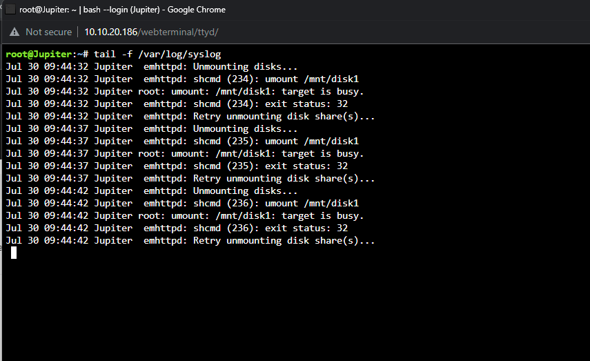

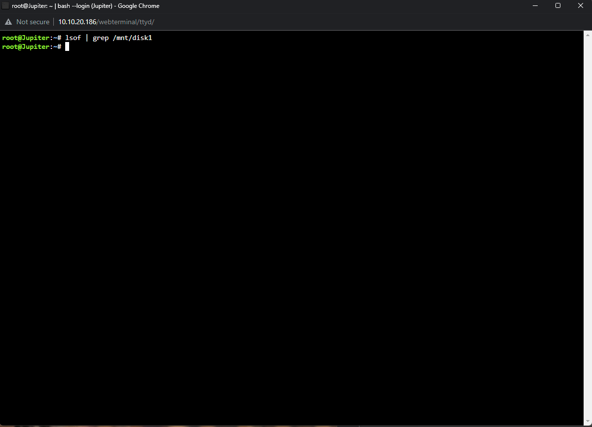

  5. I can't stop my array. I'm currently in the process of replacing my Parity drive with a larger drive. I'm trying to stop the array so I can change the parity drives, but the array won't stop. The logs says that disk1 is preventing the array from stopping saying the target is busy. (see pictures attached) I tried to use lsof | grep /mnt/disk1 to find out what's causing it, but it doesn't show anything (see pictures attached) I've also attached the diagnostics. Any help would be greatly appreciated. Thank you Edit: I don't have terminal open, and there's no ssh windows open jupiter-diagnostics-20230730-1045.zip

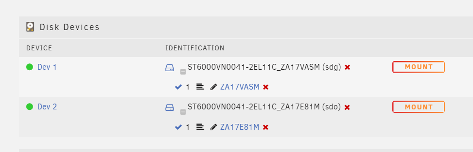

  6. Everything works now! Thank you very much for the quick help!
