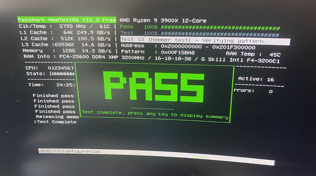

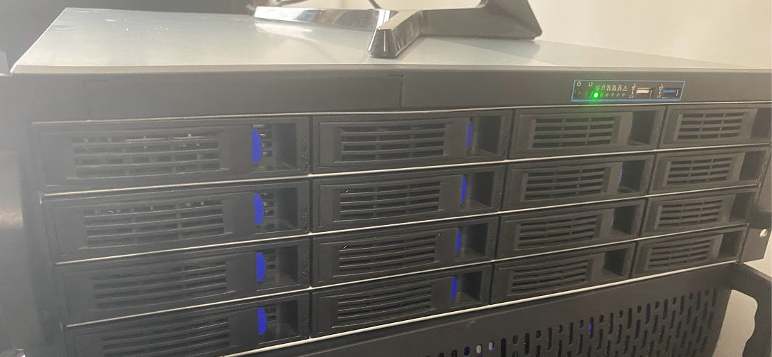

I'm very new. So, I apologize in advance if this is a simple question. My current issue is unraid is not recognizing any of my hard drives. All the ram seems fine. I ran a memtest and it shows all 128GB installed (and I don't think unraid would run without RAM). When I turn on my server, no lights come on indicating that my drives are working. Here is the build of my server: It's a Norcos 16 bay server case Other components: Asus AM4 Motherboard Ryzen 3900X 12 core DDR4 128GB RAM Corsair HX1000 PSU RAID Card (2) Samsung 500GB SSD (8) WD Black 4TB HDD (8) For other context: I have the newest version of unraid installed (just the trial version). I'm able to boot to that and log in on the server as well as the web GUI. This is where I noticed no devices were being found. I can boot to the UEFI menu, but I'm not exactly sure what I'm looking for there I attached an image of my server, as well as the results of the memtest. Is there a test I can potentially run to see if my hard drives are recognized so that I can rule out a hardware issue? Or is there something in unraid that I can do?
