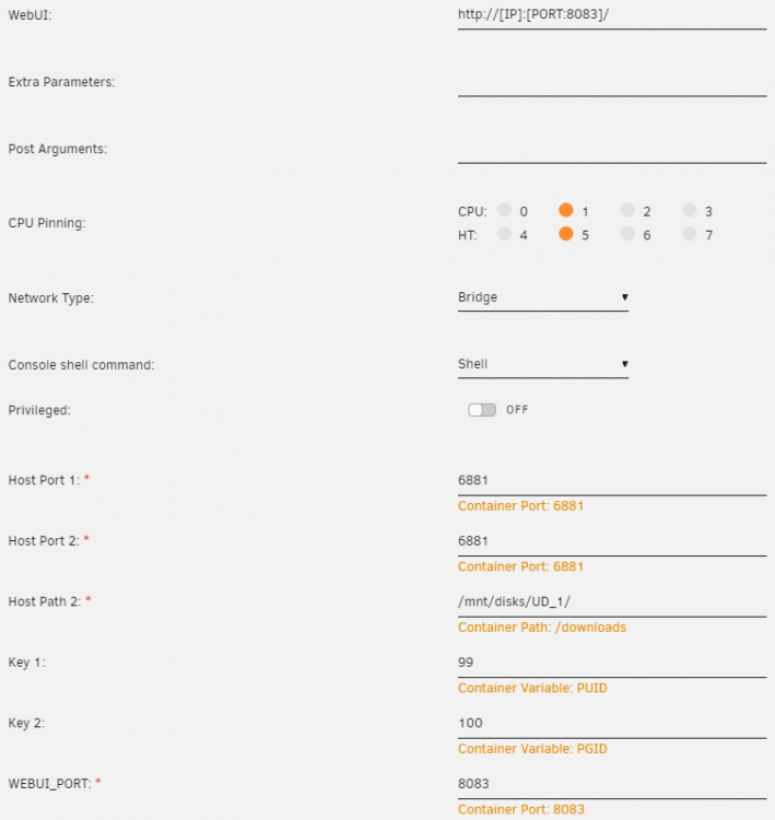

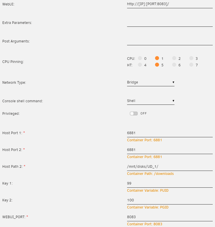

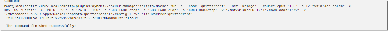

  21. I have tried changing the default port as mentioned in this thread - with NO success My Docker configuration: Docker Command: I tried manually going to port 192.168.1.104:8083 but always get "This site canโ€™t be reached" error All my other dockers WEBUI work OK. What I noticed is that the qBittorent.conf file has the following parameter: WebUI\Port=8080 even when I change it or completely delete the file or the whole Docker appdata folder each time I run the docker it is recreated with the 8080 port. I tried reinstalling the docker a few time with the port change but still not working. How can I get it working?
