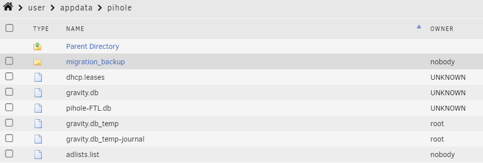

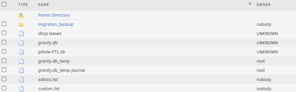

  5. After restarting it is still like this: And the directory has changed back to this:
  6. It didn't do much of anything except set the owner to UNKNOWN on the gravity.db* files

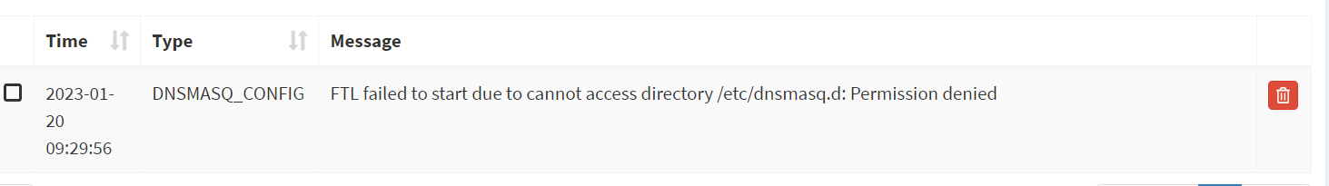

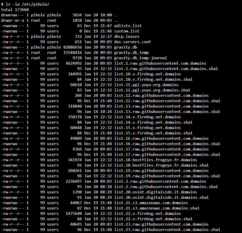

  7. When the issue started, I tried setting the perms of the files it couldn't access to "nobody", but pihole kept setting them back to "root" or "UNKNOWN"
