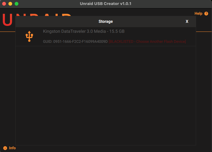

  3. Several years with Unraid an no issues when upgrading, but after upgrading to 6.12.14 I have access GUI and no containers or VM´s boot. SSH works, tried to boot to GUI but no success. Ended up recreating USB, but no my usb shows up as "blacklisted". This USB have been used for several years. I also tested another USB I have laying around with same result. Any suggestions how to solve this? Do I need to get a new USB, and if that's the case which one should I buy?
