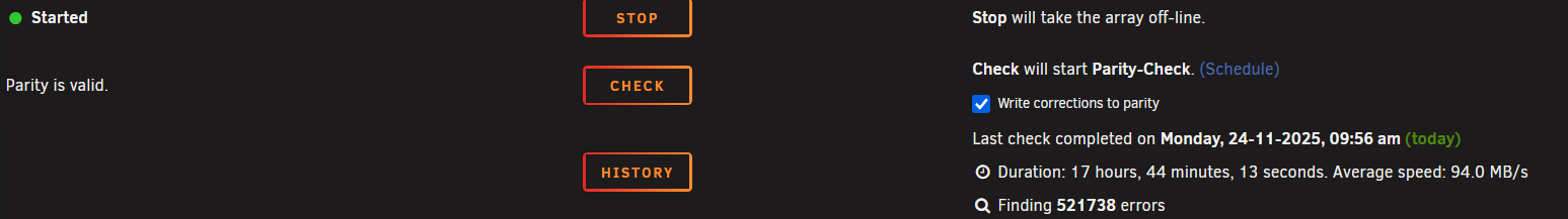

  5. Yes, but they do need a rebuild - I had to rebuild those before, and when I started it, disk 5 instantly became error disabled. It finished with 794882269 errors. The content on disk 5 looks fine. Which is why I don't get why I can't just enable the drive again. So in my head, if I can turn disk 5 active again and run a correcting parity check, there will be no data loss / corruption at all. For clarity's sake, I do think the firmware on my SMR drives is to blame for the repeated read errors that come up out of nowhere, even though the SMART statistics look fine...

  10. Yes, Disk 4 and 6. It took about 18 hr and 35 min, about the usual time to complete. I have not touched the server in a long time, but I will check the connection. Now that you mention this, it's always disks 4, 5 and 6. This time, all three at once. You are probably right with cables being the issue. In the server is an LSI SAS 9207-8i; to be sure, I will buy new mSAS to SATA cables. The SMART attributes always looked good; that's why I never changed the drives. I had these issues in the past; that's why I unassigned those and reassigned them immediately, and it always solved the issue:
  11. I have 6 data disks and 2 parity drives. 2 of the data disks were error disabled, so I unassigned those and reassigned them to activate them. While the rebuilding was in place, a third disk began to give read errors. --> "Data-Rebuild finished (794882269 errors)" What would be the best steps to verify what data is lost or corrupted? The diagnostics File: biggie-diagnostics-20251019-1530.zip

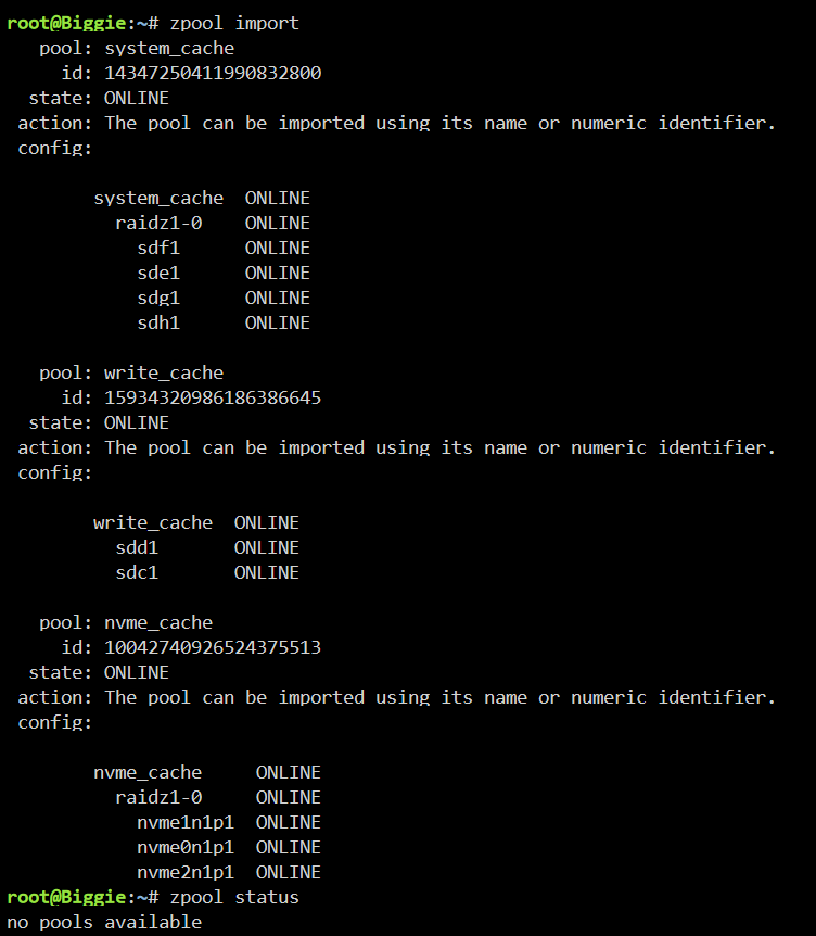

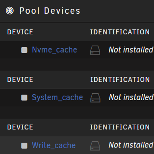

  12. I had a Hardware failure recently where my CPU or Board died, since then I replaced both. Now the problem is that all my pool devices are unassigned: What would be the best way to restore the pools without losing data? The diagnostics File: biggie-diagnostics-20241124-1110.zip The zpools look fine: Can I import the zpools and Unraid will detect them as the right pools and assign the devices accordingly? I would import them with: zpool import -a Any help is appreciated! I may be a bit overly cautious since I do not want to lose any data...

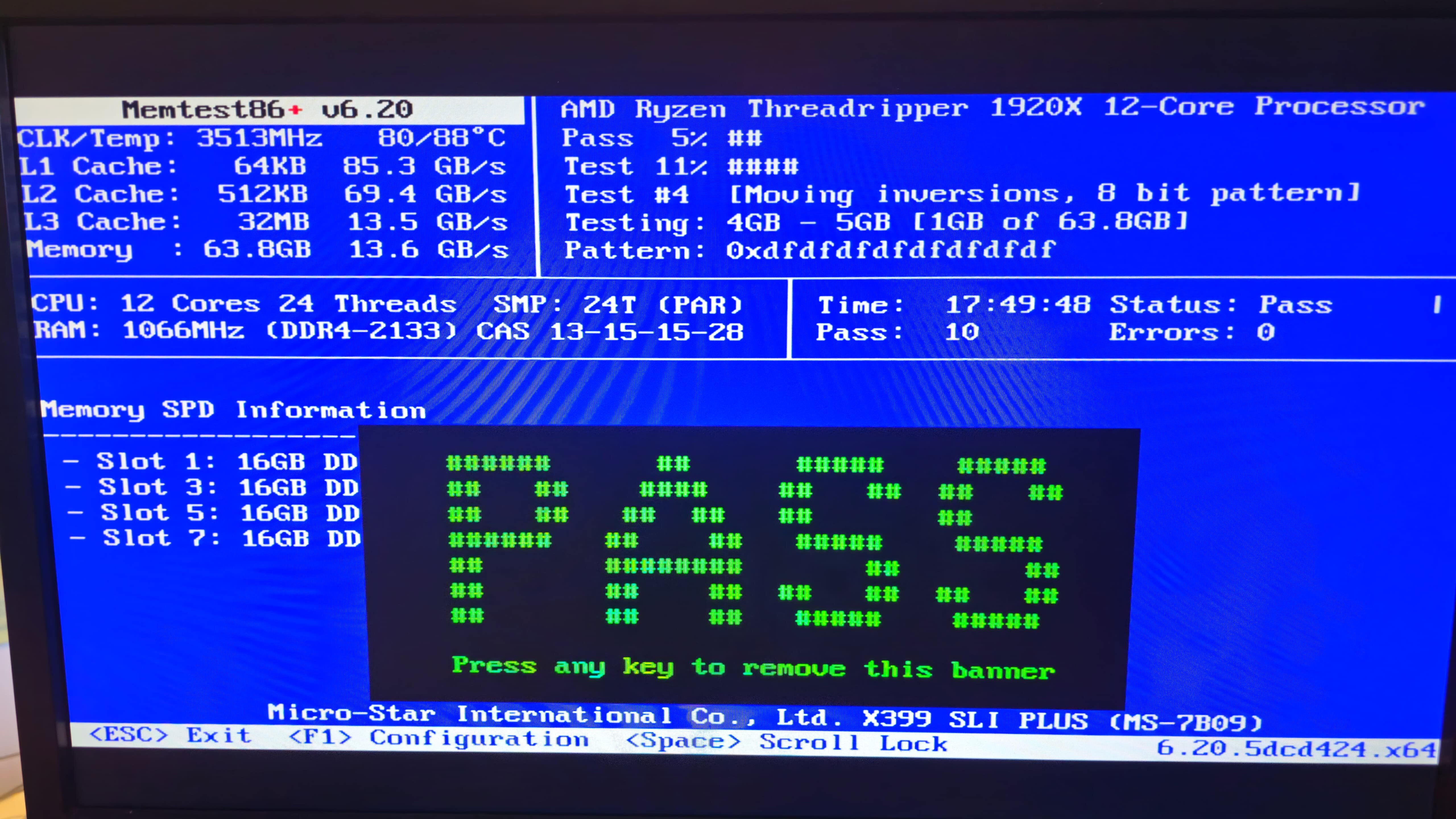

  13. I tested the GPU in a Windows system and it works fine. Booted from an Ubuntu live stick with no drives connected (no SAS-Card ether) and the system still crashes. So you are right that it is either the CPU or board. I remounted the CPU and cooler because I heard the TR4 Socket can be finicky. Didn't fix it. I will buy a used motherboard / CPU combo on marketplace to replace and test my current hardware. Strange that server just killed itself My PC died a few days after, not the best timing… Thank you @JorgeB for the troubleshooting help! Really didn't think it was a hardware problem at first because it ran fine before.
  14. OK, I think RAM is not the issue. I tried both pairs three times, but the server crashed every time (always at a different point) Also tried completely different RAM, just one stick, and the server crashed with that RAM too. Can a GPU or SAS-Card also create these crashes? That's the only other components in there, except the Drives. I'll be able to try a different mainboard and CPU combo tomorrow to see if that's the problem. Can I just switch out the components, or does unraid have a problem with that?
  15. I have now installed just 2 out of 4 Sticks and Memtest is running again. Will run both pairs for 24h and see if errors occur. In my BIOS there are no settings for the C-States and other Power Control settings or similar. The BIOS is on the newest version. The RAM is not over overclocked, running at its native speed 2133MHz.
