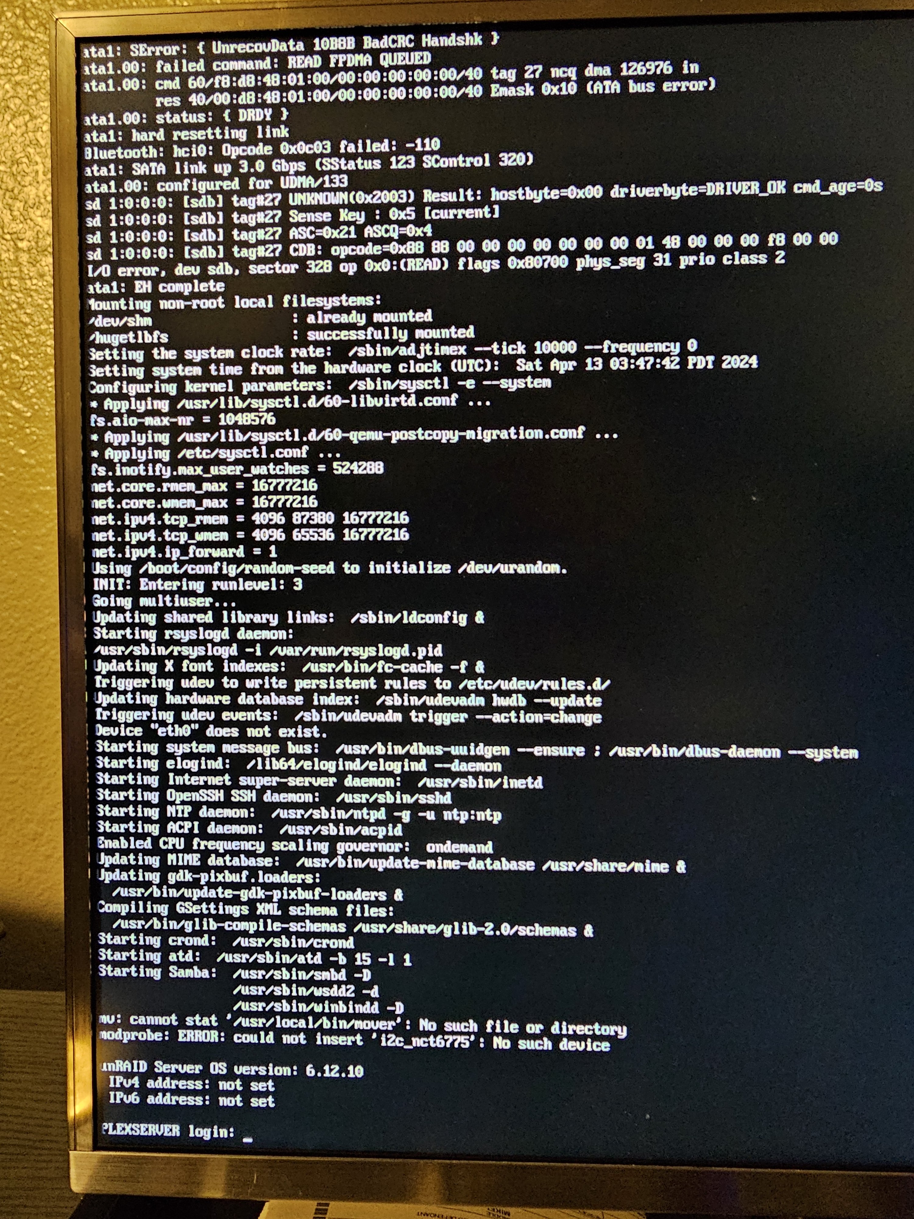

  12. Good news! I found a temporary solution. I reformatted my original usb and used the most recent beta OS. I booted the usb using my laptop and installed all 4 plugins for realtek NIC drivers. After install, I booted my new setup with the same usb and now it provided a valid ipv4 address! I still can't get the boot gui up but progress!!!
  13. How do you install the plug in? Do I have to take the USB into a different computer and drag and drop the plug in into a folder onto the usb?
  14. I am currently trying to upgrade my motherboard and processor because my last motherboard is now unresponsive. I first tried using my USB from the previous motherboard which it froze after the boot screen countdown. I then erased the USB and fresh installed Unraid onto it resulting in no netwrok connectivity (IP showed "not set" for both selections). I tried booting to GUI which resulted in a black screen with a cursor at the top blinking. I do not know tech scripts real well and im fairly noobish but I have built computers for awhile now. I was able to generate a diagnostic file and will post that too. my set up is: Motherboard: ASRock Z890I Nova WiFi LGA 1851 Mini ITX PRocessor: Intel Core Ultra 7 265K - arrow lake 20-core - BX80768265K Ram: Team T-Force Delta RGB 32gb (2x16) 288-pin ddr5 6400 SSD: Crucial T700 GEN5 NMVE M.2 1tb PCIe 5.0 My goal is to get my network driver working (assuming that is the problem) and reinstating my old set up unraid from my old motherboard to my new motherboard. Any suggestions? zenithicus-diagnostics-20241217-1410.zip
