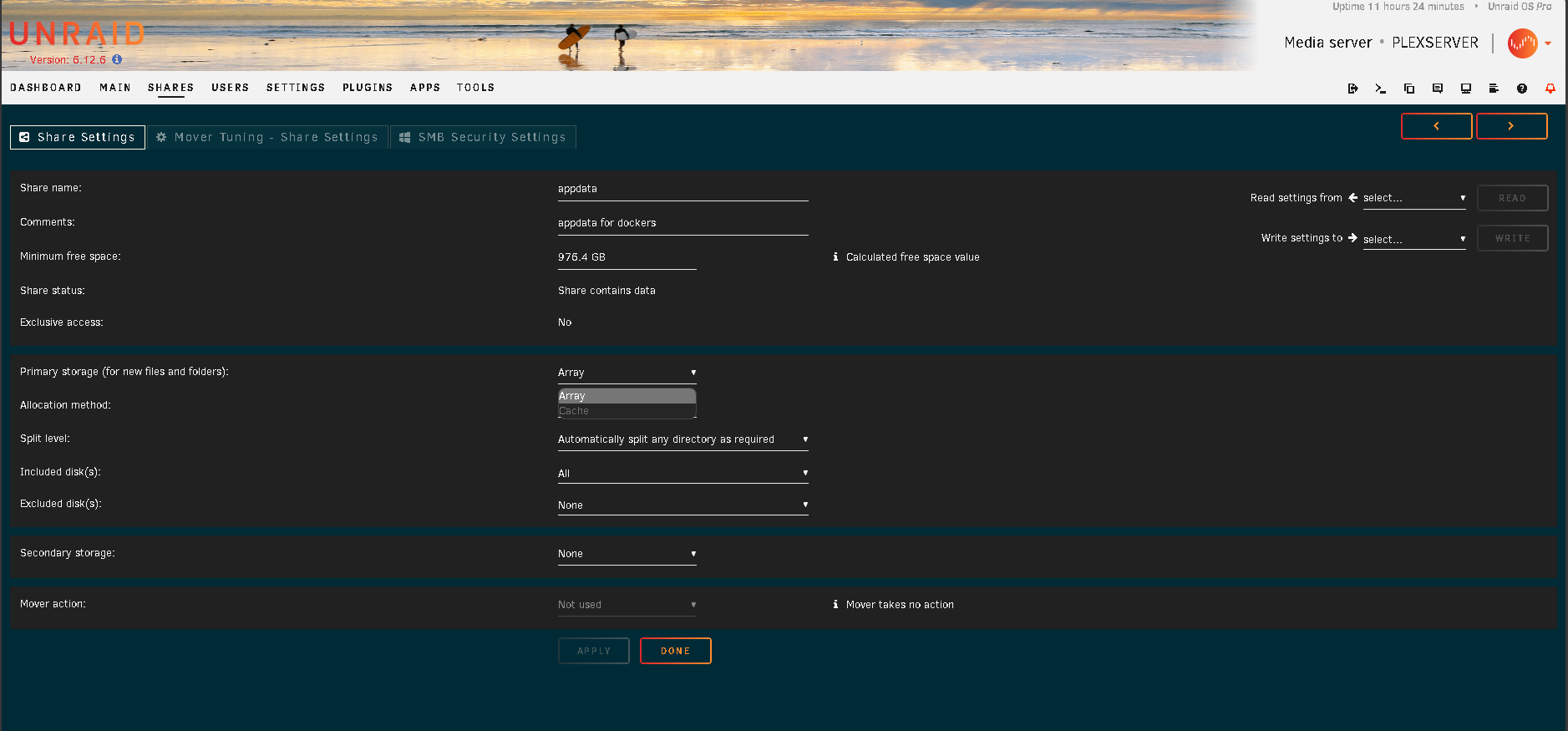

  20. i figured it out. had to stop array, go to cache settings, enable user assignment, start array and then go to appdata share to change it
  21. i get that but this is what I have. the option to change the primary storage is there but it is greyed out and unselectable
  22. i still cant figure out how to switch back to the cache for my appdata share. It was once on the cache primary storage but to get rid of the warning symbol shown on the appdata share, I changed the primary to the array option. now Fix Common Problems is saying that it is wrong so I am trying to change it back but it has the drop down "cache" option for primary storage greyed out and unselectable. I am lost on what to do and I cant figure it out by the forums. am I doing something wrong? I posted diagnostics. plexserver-diagnostics-20240125-0554.zip
