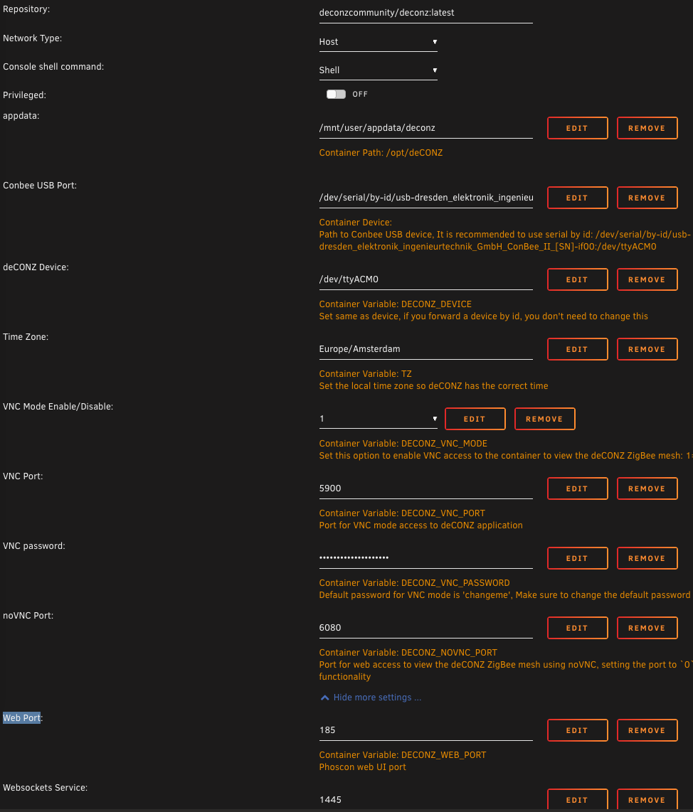

  20. trying to get deconz to work but when using my custom network bridge I don't get an IP or ports assigned in unraid, and I can't access th gui/novpn. when trying host mode I still see port 80 being assigned while I setup deconz to use a different port via the Web Port variable. Any thoughts? Deconz seems to have started when I check the logs but I can't get access. edit: I used to run deconz in docker on a raspberry pi but wanted to migrate as my Pi keeps crashing due to recent added devices in deconz... edit2: changed it back to bridge mode and added 3 port forwards, 80->185 443->1445 6080->6080 novnc is now accessible, webui / phoscon is still not available
