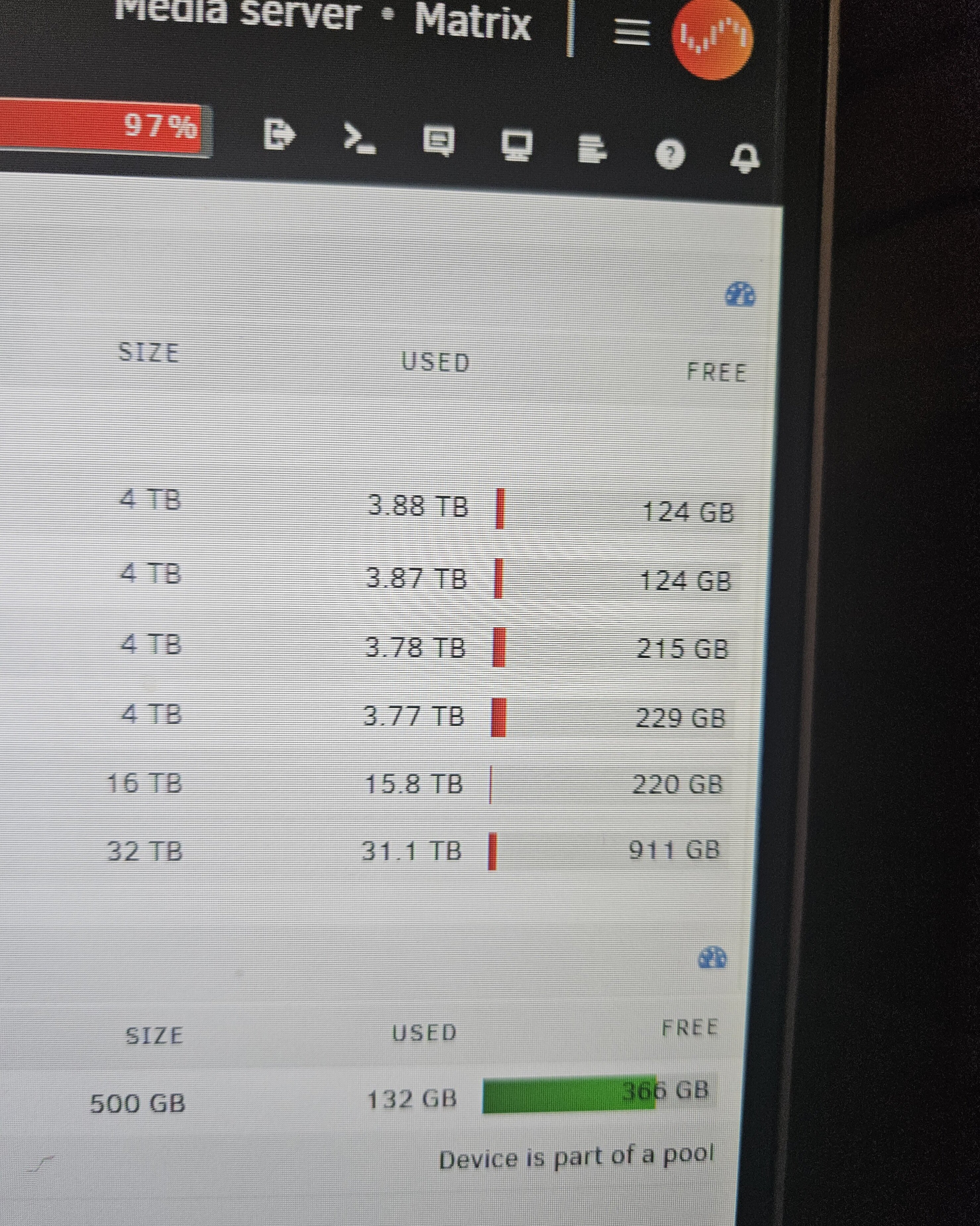

  9. Hi Guys, so ive had nothing but dramas with my server since i upgraded over the past few weeks, most likely user error by not understanding certain unraid requirements, i had files moving all over the show, i think the issue stemmed from most my drives being close to full. I purchased a new 16TB drive to replace an 4TB. i rebuild the drive from parity, and all seemed good. I then seemed to have had a power cut a week later. which i think may be the culprit of my server having issues, when i got home and booted it back up, its stated the new drive was unmounted. So i stopped the server, re-mounted and started the rebuild. this took almost 2 days, the rebuild is done, but the drive still says its not mounted, ive stopped the array, if i put it into maintenance mode, it mounts with no errors, but when i start the server up as normal, i get the unmounted error. if i go into maintenance mode and click "Mount" on the unmounted device, i get this error : Failed: Device "/dev/sdd" Failed to mount. Check the syslog for details. Ive attached the log, as im struggling to navigate where the issue is. If i click on the "remove" partition option on the unasigned disk, and then re-asign, will this wipe the disk and then rebuild again, and hopefully work? Im hoping my parity is fine, as i think it would be, the SMART report also attached i cant see any issues with the disk. help appreciated. matrix-diagnostics-20241216-1824.zip matrix-smart-20241216-1741.zip

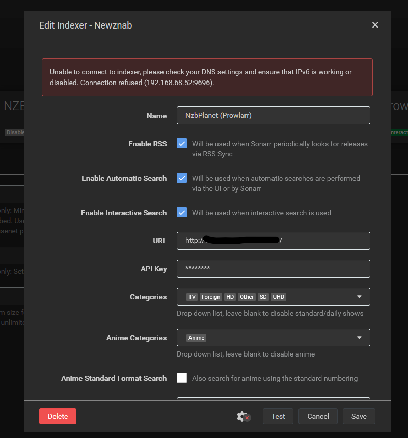

  12. i also just noticed this on all my indexers on radarr and sonarr: Unable to connect to indexer, please check your DNS settings and ensure that IPv6 is working or disabled. Connection refused. again i havnt change any settings other than a unraid update. has the update changed a lot of settings for some reason, causing all these issues, as i find it weird that heaps of settings have changed for no reason? Regards

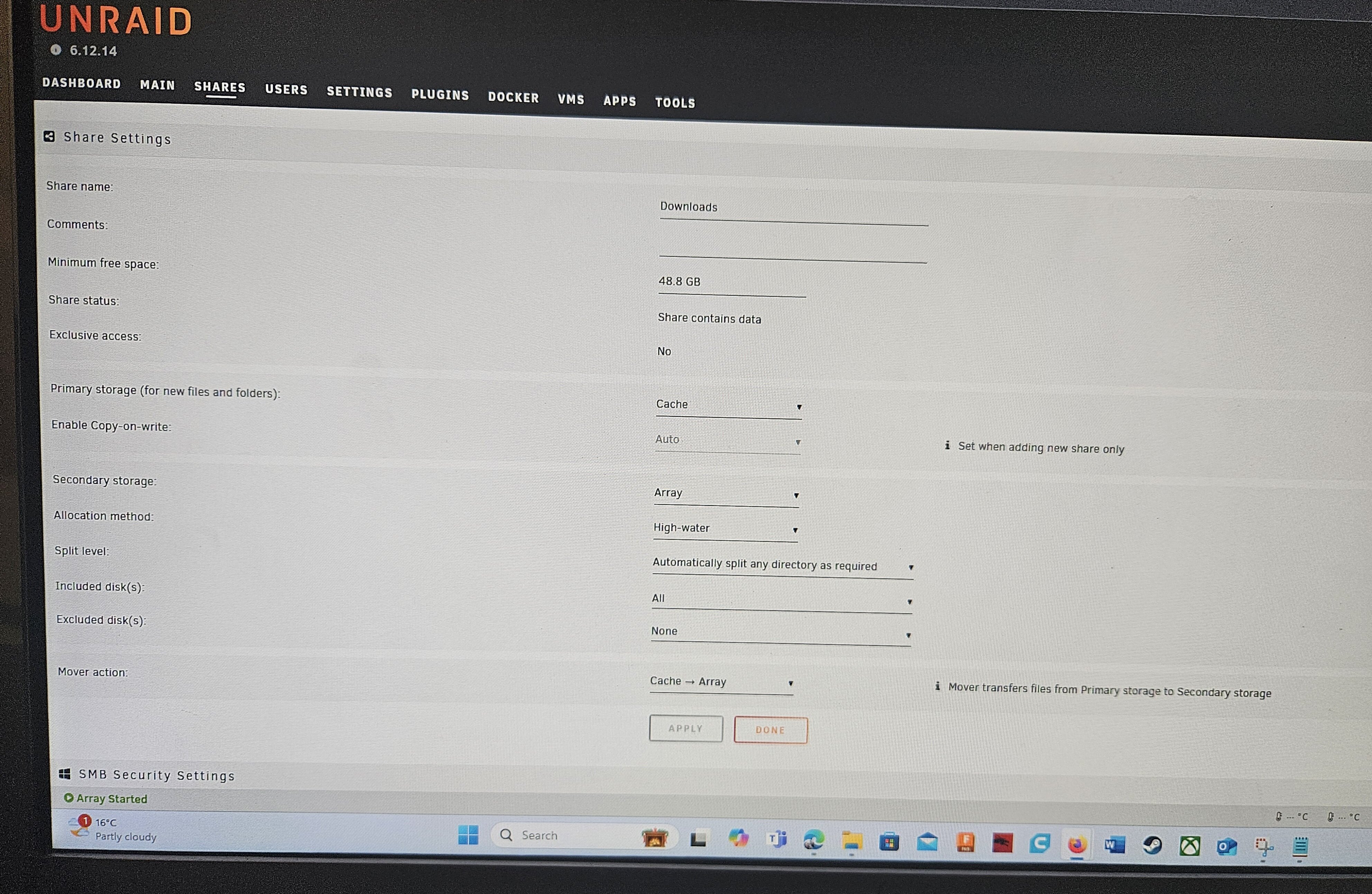

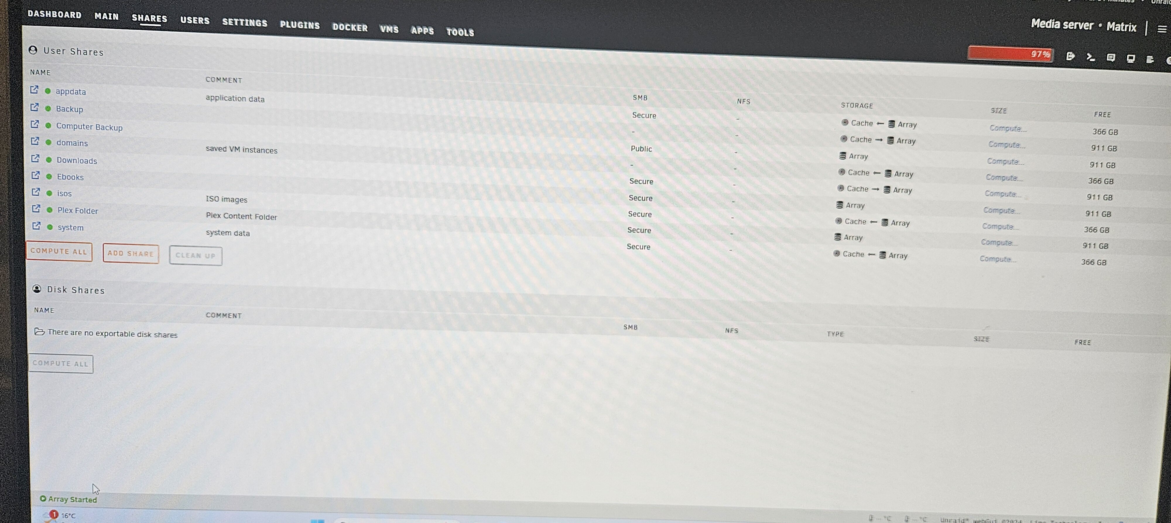

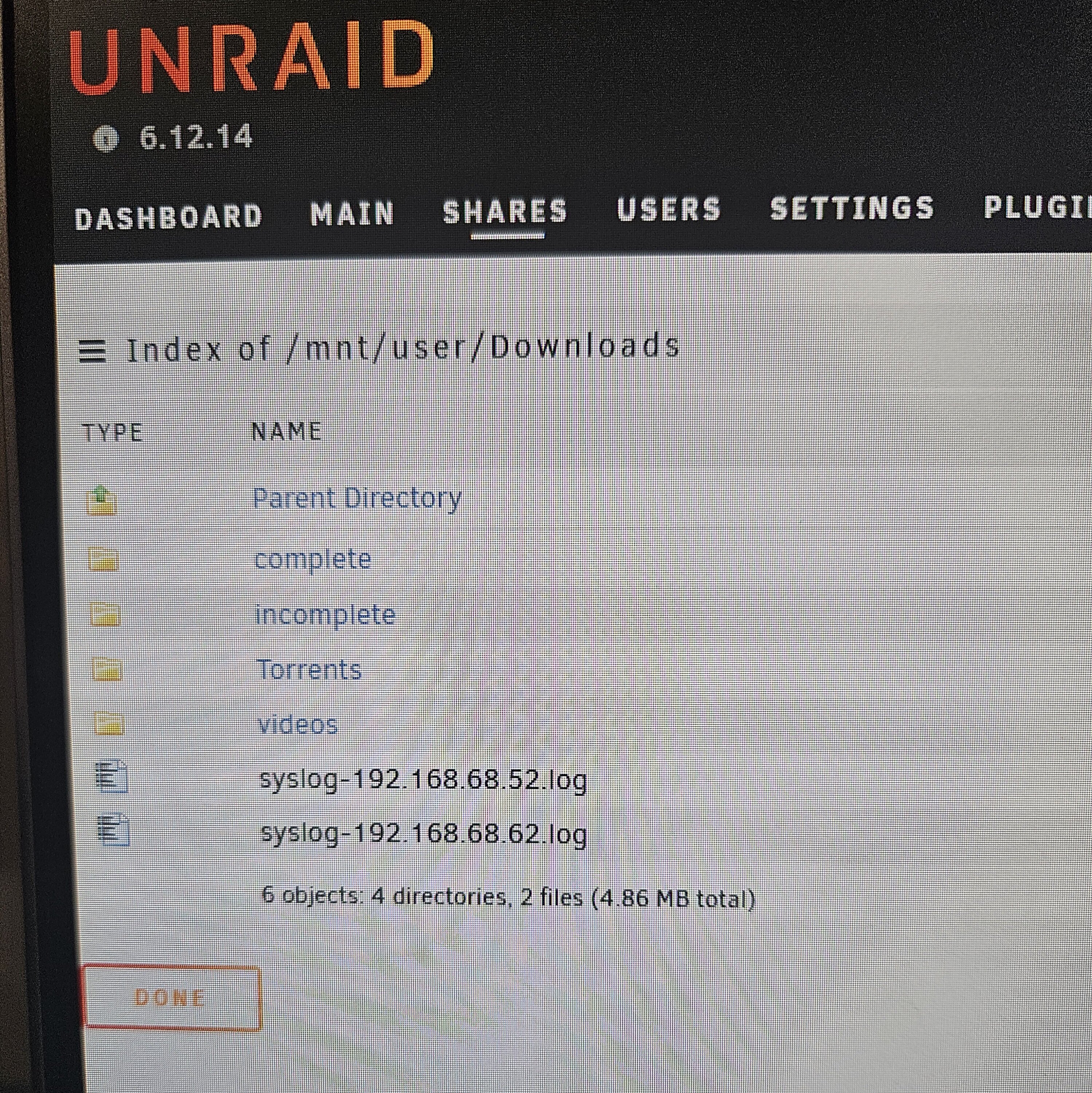

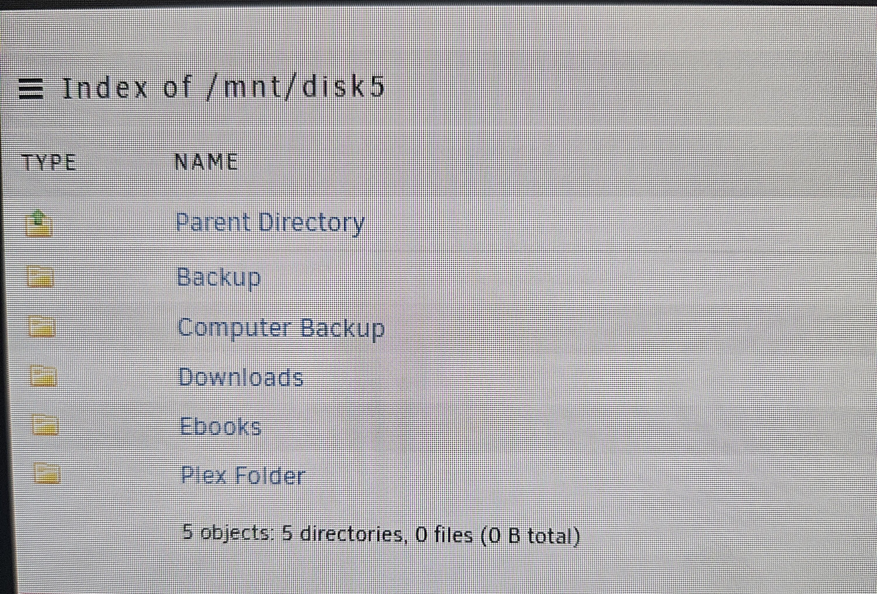

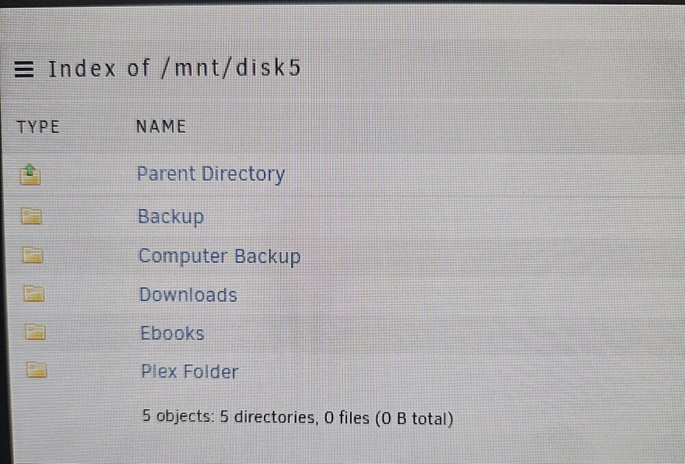

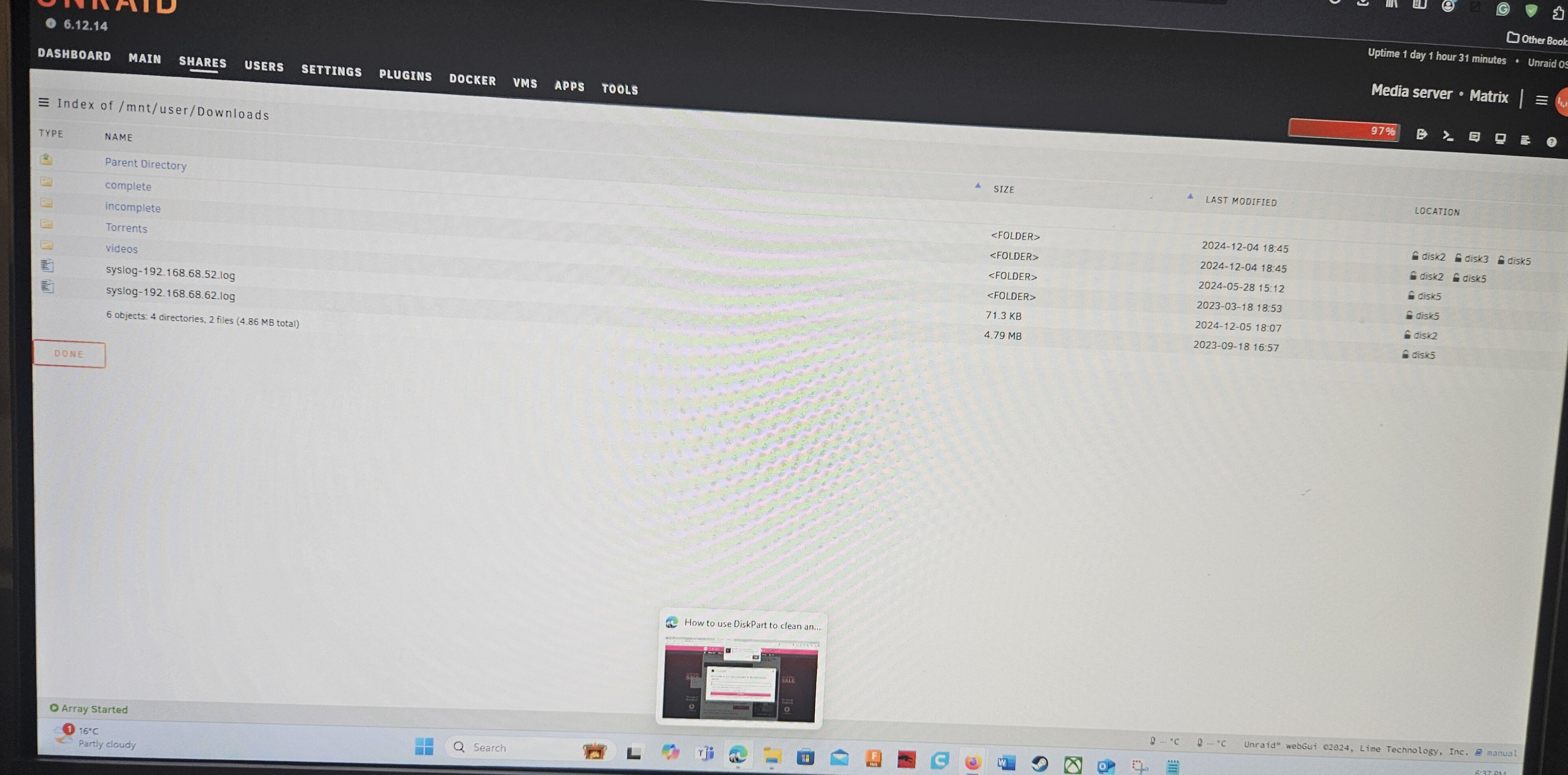

  13. matrix-diagnostics-20241205-2019.zip sure thing. please see attached. the share folder name is "Downloads" from this directory "/mnt/user/Downloads" its now spread across multiple drives, but the bulk of the data is on drive 5. unraid wont let me manually move through krusader the files from drive 5, it says theres not enough room on my drive to move the files to the correct folder, even though i have 900GB spread between all drives. is this because drive 5 is now full? it needs room? originally before this issue, drive 5 had the most room left out of all the drives, as it was the newest. what i also dont understand, is the download folder which is set to receive all files from downloads in the cash no longer exisits. i do have a backup flash drive from 4 days ago, im hoping the issue didnt start then. as this is when i installed a new plex docker and removed the old, as i had issues with plex, everything seemed to work for over 24 hours with no dramas. so i updated unraid, and then a few hours later, the cache filled and everthting started erroring. im not sure if that info helps at all? cheers for the help so far. i have tomorrow off work, so i will have the time to try and rebuild the flash settings from backup if need be, im just not great at this level, so wanting to avoid this if possible. Regards

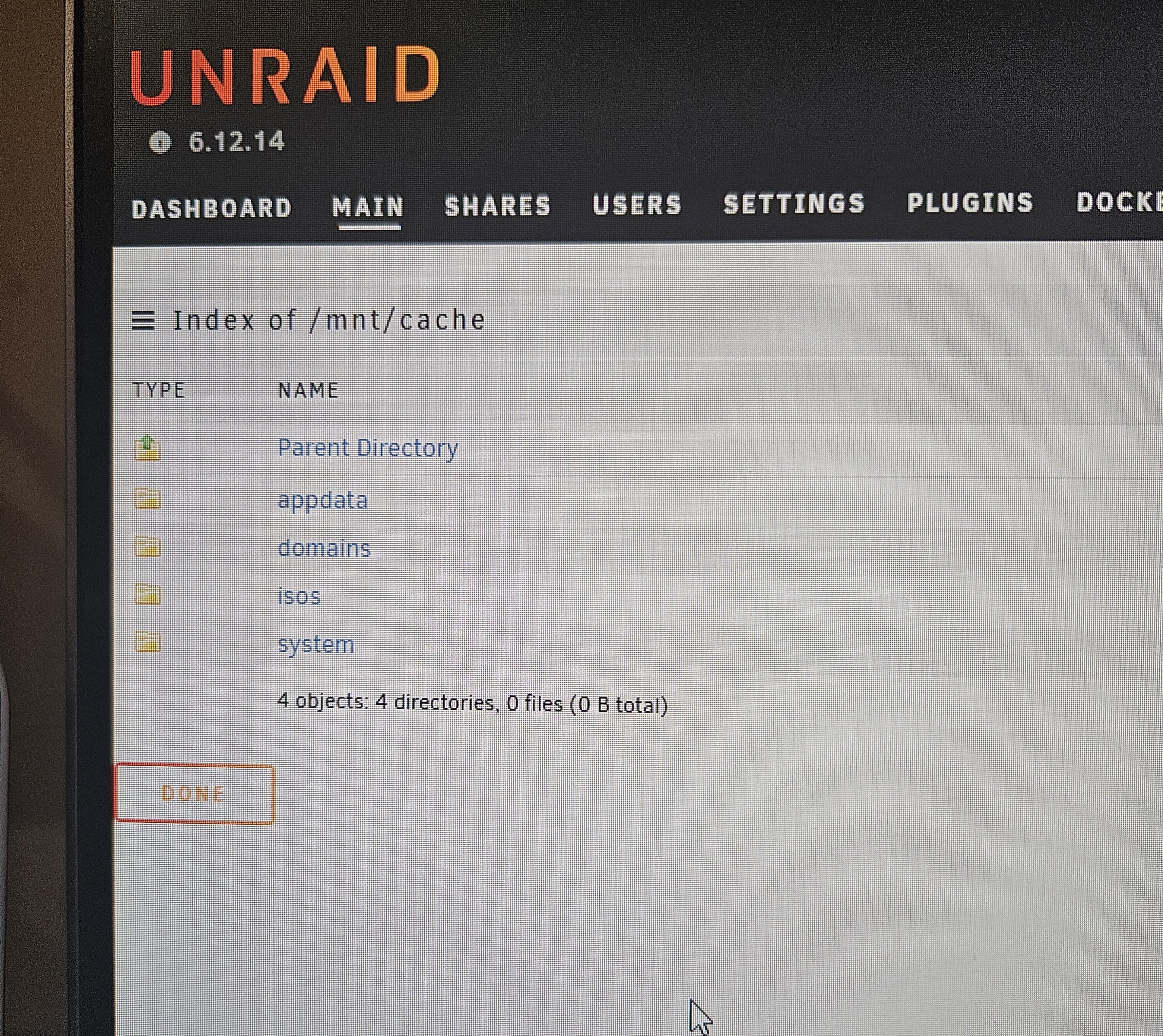

  14. Just out of curiosity, check your cache folder. May be unrelated, but since I upgraded, mover is moving files completely incorrectly and in the opposite direction. Be curious to see if it is in cache
  15. Tried this morning. Kinda worked but didn't... it moved the whole download folder to disk 5 and completely filled it. All the settings state that folder is to be in cache and contents get moved over all array, where now it only moves anything to disk 5. Now that's full, nothing will move anywhere else. Please see attached as this is completely wild...
