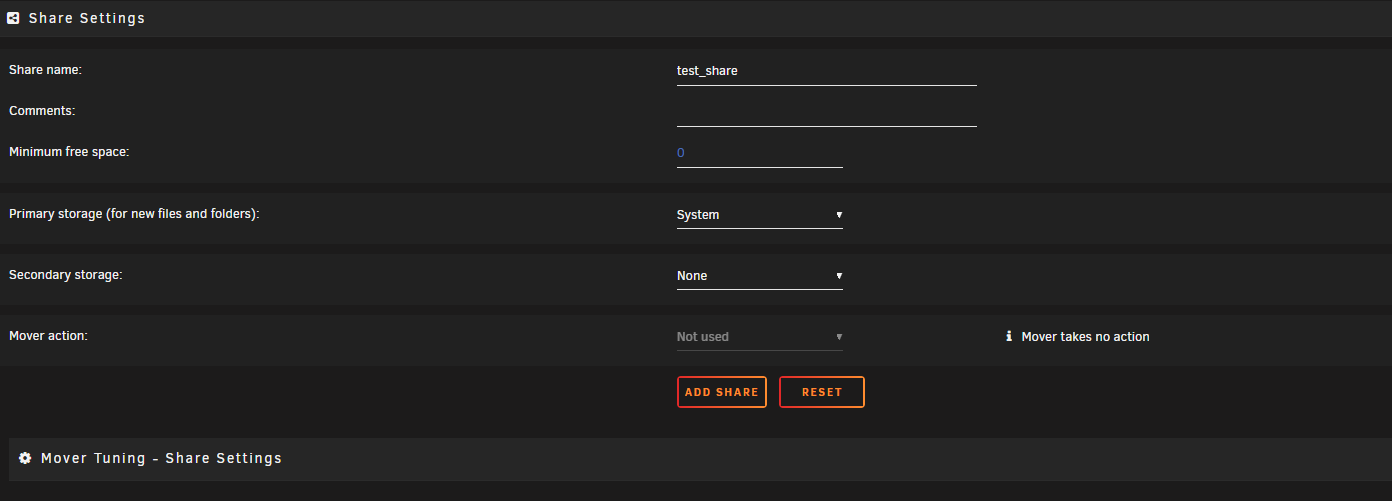

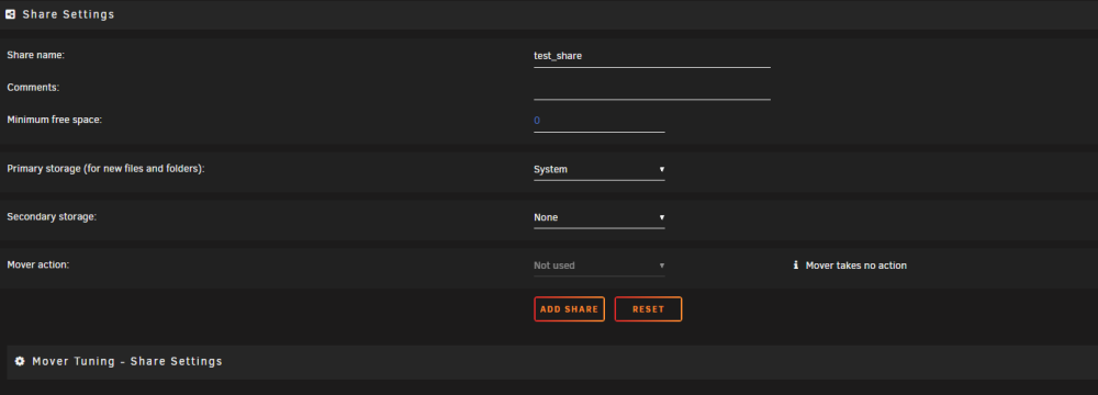

  6. thnx, Just changed the pool back to zfs mirror. After reboot created a new share. In the share tab in Unraid is says all the data is protected and there is a green dot in front of the share name. In the dashboard: These are all the files: mediaserver-diagnostics-20231212-1518.zip Thnx in advance.
  7. No over here not. Just change the pool to BTRFS raid1 (mirror) But the share is still orange on the dashboard.
  8. yes pretty sure, pool: Share setup: Dashboard:
  9. For me, the dashboard is a way to quickly get an overview of right and wrong. Green/blue is fine and orange/red needs attention. Currently, shares outside the parity protection but in a redundant pool are displayed in orange, making it appear in the dashboard as if they are at risk. My proposal: Shares inside parity protection: Green Shares inside protected pool: blue (Mirror, RaidZ) Shares on single pool disk or unprotected array: Orange Maybe I'm overlooking something, this won't work for other situations, but in my situation it would be very useful.
