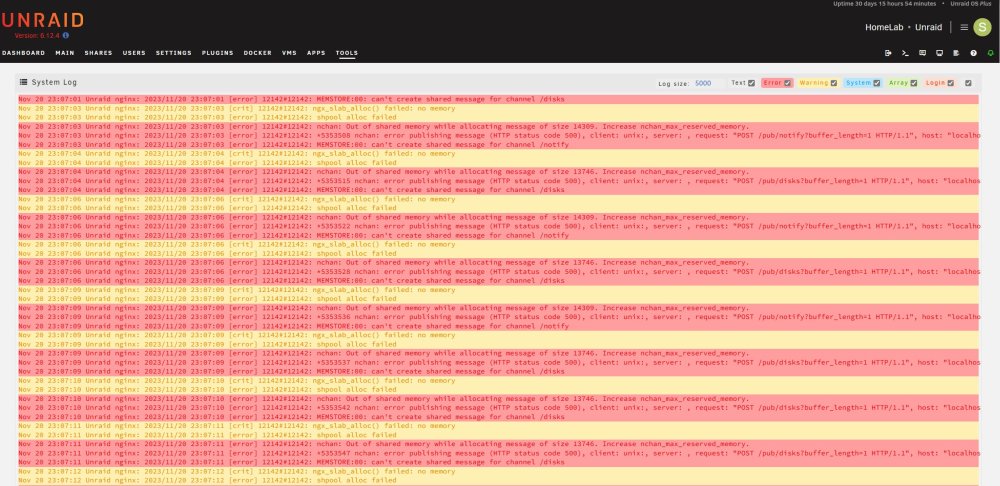

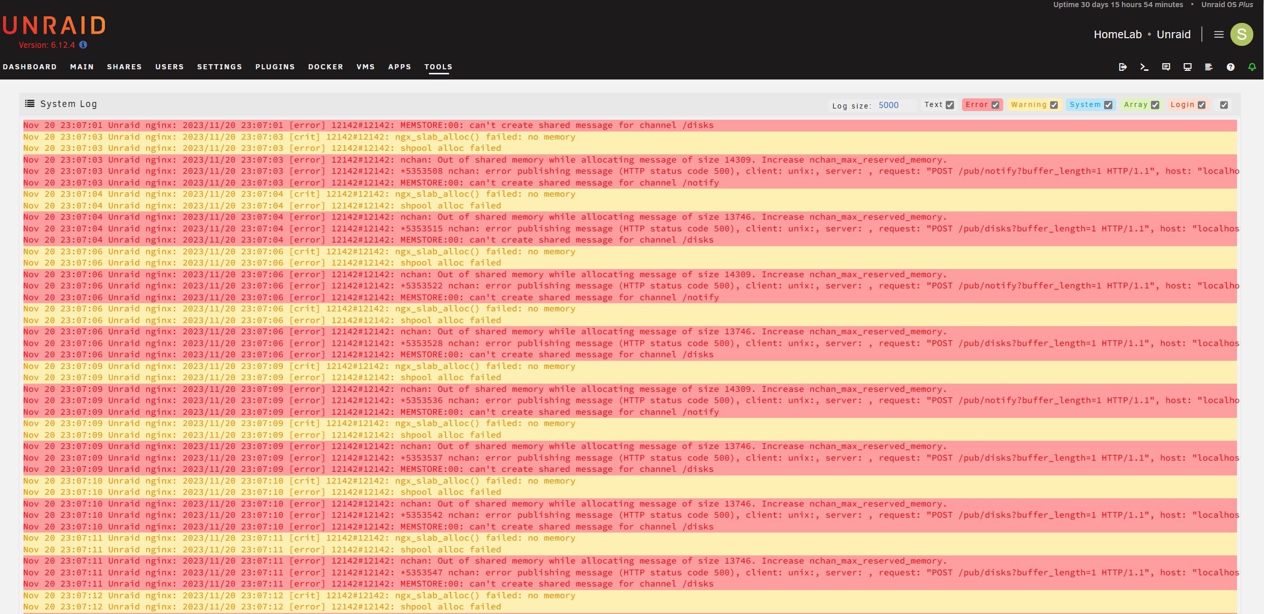

  6. Dear all, I have my Unraid server up and running for few month now with few SMB shares. Today I've check the shared folders in Windows and I found that all folders are empty. In the Unraid dashboard it says that there are no shares present although I see the right drives capacity ( they were at about 50% capacity) What can it be? I am a bit worried about my files... I send you a screeshot of the log. There's definetely something wrong...
