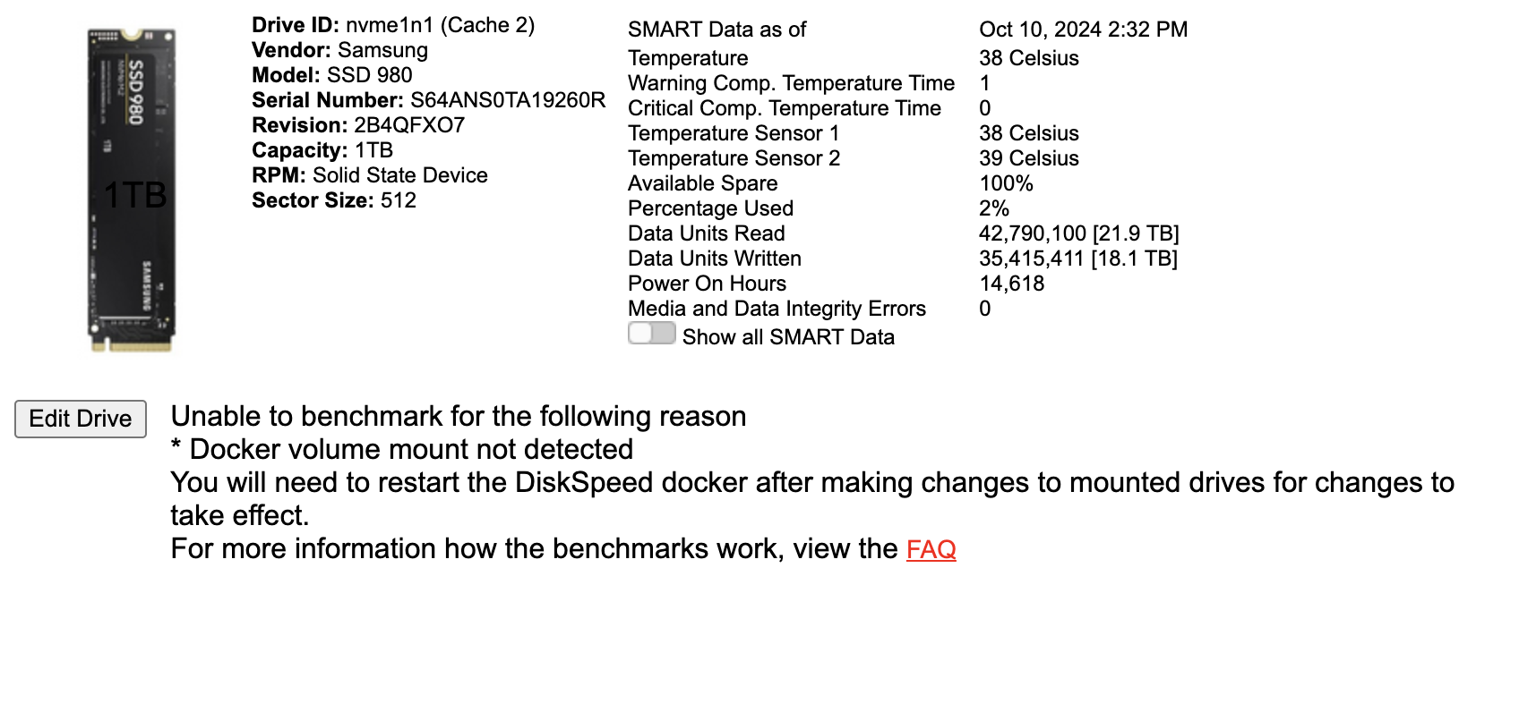

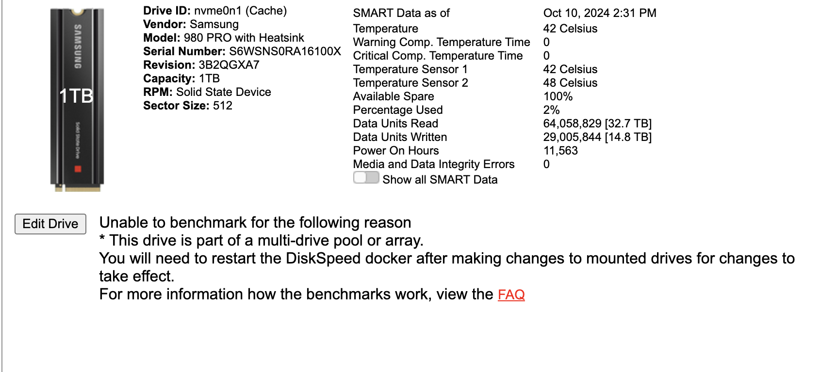

  3. Is it possible to test NVMEs in a zfs pool? I have 2 1tb drives in a striped zfs pool acting as my cache and I would like to benchmark performance. I see this for the first drive and this on the second drive. First message leads me to believe that testing ssds in a zfs pool is not possible but thought I would check
