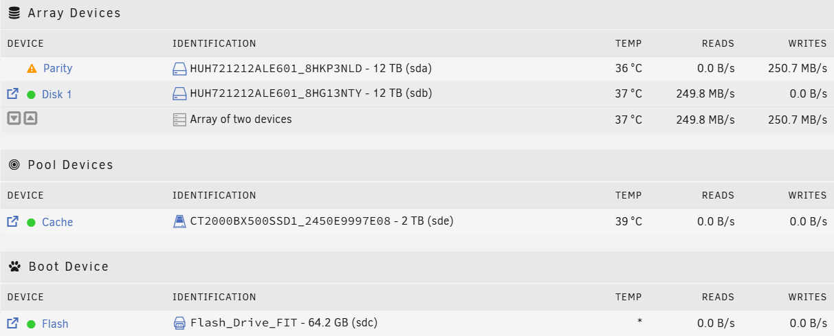

  9. thank you, i was working under the assumption that those were created as default before docker/vm was up. Thanks!
  10. rebooted: no effect deleted array using new config, recreated array: no effect any help appreciated, Thanks.

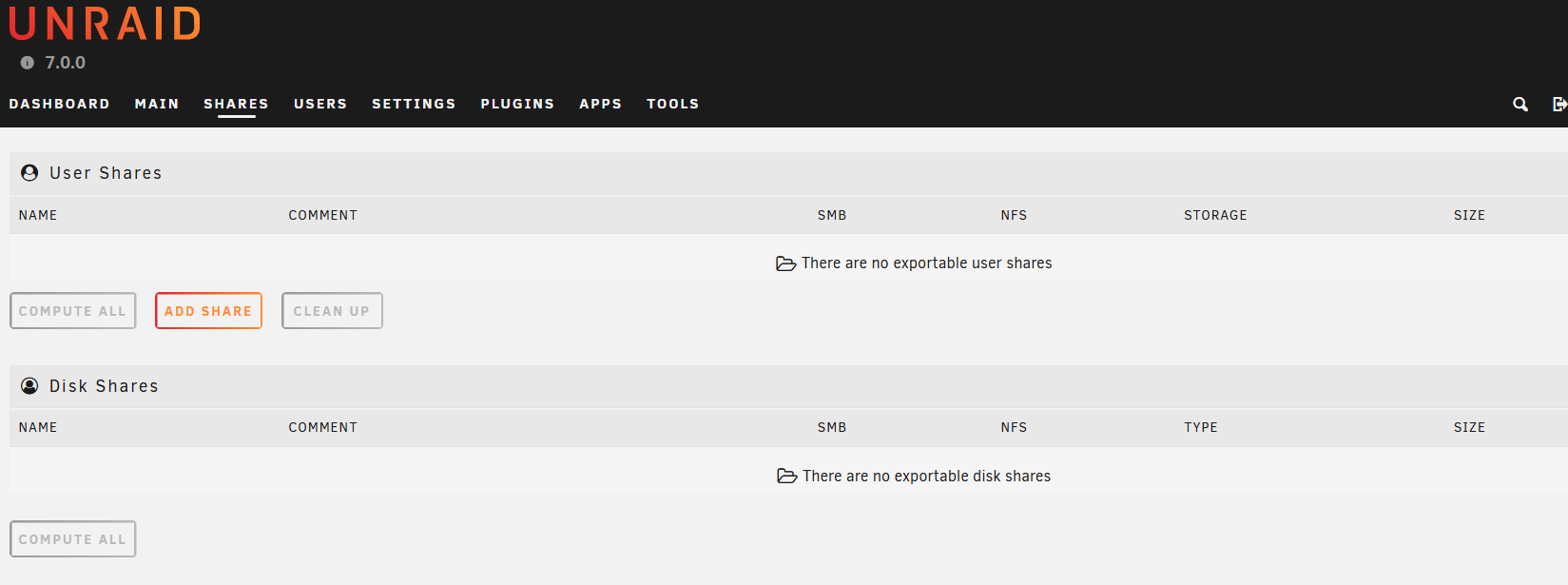

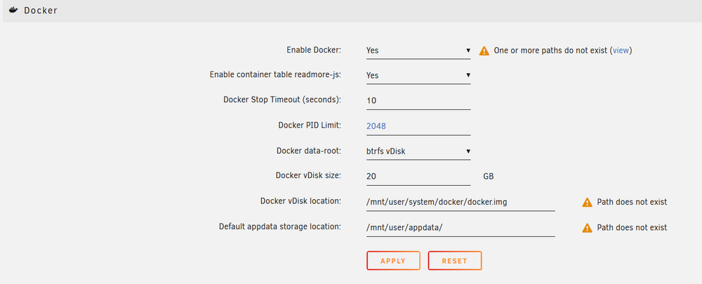

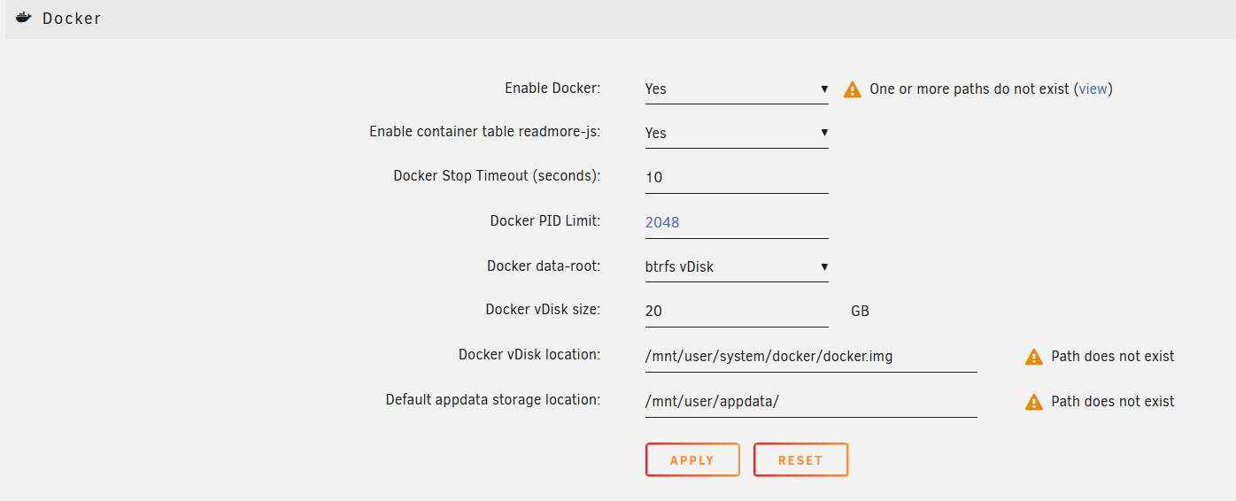

  12. appears to be no shares, another thread seems to indicated that docker would create the shares upon enable, but it appears that docker requires the shares to be enabled. seems something is wrong here. not sure if i took a wrong turn. any help appreciated. (parity still being built)
