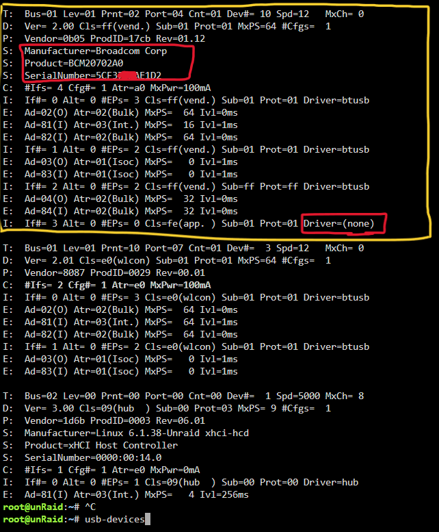

  3. Hello Everyone. I've been searching the internet and this forum mostly for a couple days without success. I'm really sorry if this is a duplicate. My issue : I can't pass my brand new asus BT-400 bluetooth dongle to HomeAssistant Docker. Here is what I tried without success : lsusb to get the BUS and Device numbers and pass it as a "device" using --device=/dev/bus/usb/00X/00Y With --device=/dev/bus/usb/00X/00Y, trying to pass the dbus path /dev/bus/usb:/dev/bus/usb Trying to find the ID using `ls -l /dev/serial/by-id` to pass it as '/dev/ttyACM0:/dev/ttyACM0' > My USB dongle does not appear when using the command. Side note : I did managed to pass my SonOff Zigbee dongle using the `ls -l /dev/serial/by-id` command since it appears in it. What I found after some time : When using this command `usb-devices`, I find several lines for my device wich show driver = btusb but the last line displays : driver = none Any idea how that might be or what I should do to get this dongle working ? If not, could you recommand one that's working out of the box with unraid since I can still ship this one back with Am****n Thanks to you all.

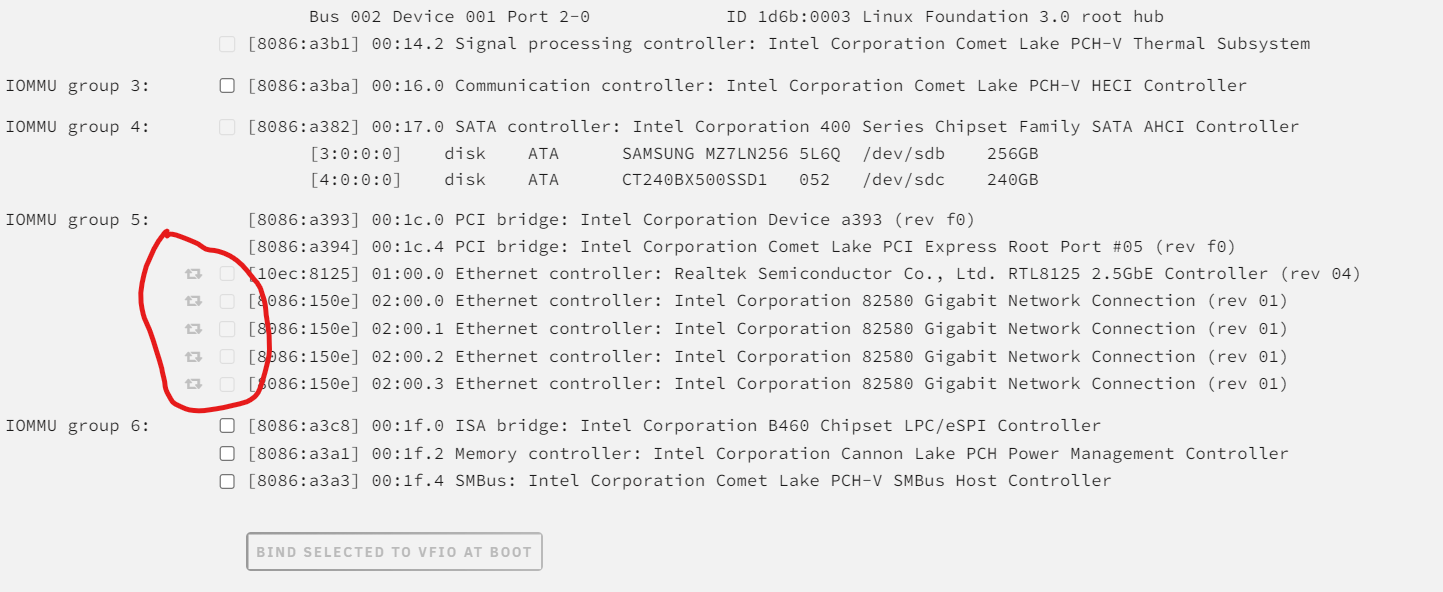

  11. Hello everyone, I'm trying to isolate my network interfaces to use on VMs in unraid. I have a total a 5 ports. 1x onboard NIC - 2.5GB (RLT8125) 1x quad port PCIe network card - gigabit Intel 82580 The onbloard NIC is connected to LAN to accès unraid via the webGUI. I'm trying to isolate 2 of the 4 ports on the intel PCIe card (I'm willing to compromise isolating the 4 of them) As per my research, I'm trying to bind those to VFIO at boot using the Tools > System devices option in unraid. However, all of them are actually marked as "In Use By Unraid" (see screenshot below), even with VMs and Docker disabled. My question is : Are they all "in use by unraid" because they're in the same IOMMU group as the 2.5Gb NIC that I use to access Unraid via webGUI ? If so, what is the solution to seperate them and bind them to VFIO at boot ? If that's not the reason ? Why are my Nics marked as "in use by unraid" and How can I set unraid to "unuse" them. For information, 2 of those ports (on the quad PCIe card) are bridged, each to 1 seperate brX network. The other 2 nics are not bridged, nor bonded. Thanks in advance to anyone who will take some time to answer Have a great day ! unraid-diagnostics-20230205-1245.zip
  12. Thanks. I went with the Bridging to a BRx network for 2 of those nics. I used those 2 BRx networks in my VM config. Seems to work pretty well. It might not be th ebest solution in terms of security... But it's a problem for later...
