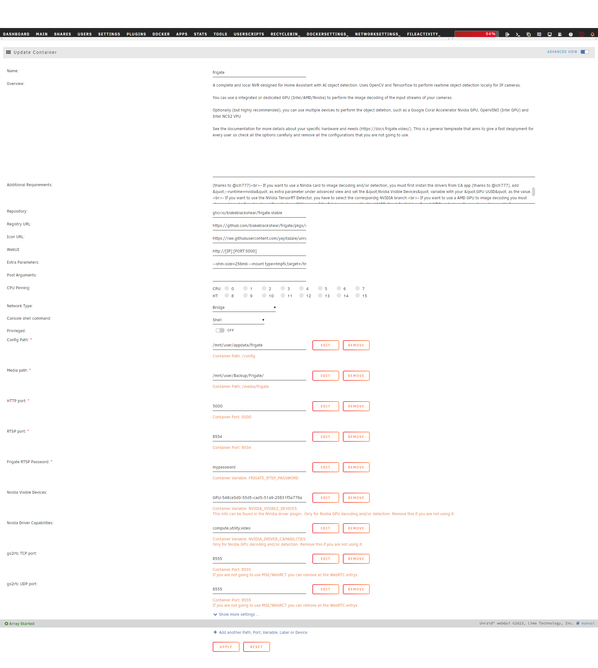

  11. okay got my gpu working in frigate but for some reason the event detection is not working with the tensorrt, I see no events being triggered any ideas why? My config below mqtt: enabled: False detectors: tensorrt: type: tensorrt device: 0 model: path: /config/model_cache/tensorrt/yolov7x-640.trt width: 640 height: 640 go2rtc: streams: bedroom: - http://192.168.4.183/flv?port=1935&app=bcs&stream=channel0_main.bcs&user=admin&password={FRIGATE_RTSP_PASSWORD} cameras: bedroom: enabled: True ffmpeg: inputs: - path: http://192.168.4.183/flv?port=1935&app=bcs&stream=channel0_main.bcs&user=admin&password={FRIGATE_RTSP_PASSWORD} input_args: preset-http-reolink roles: - record - path: http://192.168.4.183/flv?port=1935&app=bcs&stream=channel0_sub.bcs&user=admin&password={FRIGATE_RTSP_PASSWORD} input_args: preset-http-reolink roles: - detect detect: enabled: True width: 640 height: 480 fps: 7 record: enabled: True retain: days: 10 mode: all events: retain: mode: motion default: 20 birdseye: enabled: True mode: continuous restream: False width: 640 height: 480 quality: 12 ffmpeg: hwaccel_args: preset-nvidia-h264 output_args: record: -f segment -segment_time 10 -segment_format mp4 -reset_timestamps 1 -strftime 1 -g 300 -c:v hevc_nvenc -preset p7 -tune hq -level 6.2 -tier high -c:a copy and the logs doesn't show any errors: 2024-02-10 13:41:15.567309349 [INFO] Preparing Frigate... 2024-02-10 13:41:15.579936723 [INFO] Starting Frigate... 2024-02-10 13:41:17.224436812 [2024-02-10 13:41:17] frigate.app INFO : Starting Frigate (0.13.1-34fb1c2) 2024-02-10 13:41:18.796348475 [2024-02-10 13:41:18] peewee_migrate.logs INFO : Starting migrations 2024-02-10 13:41:18.805579722 [2024-02-10 13:41:18] peewee_migrate.logs INFO : There is nothing to migrate 2024-02-10 13:41:18.813163234 [2024-02-10 13:41:18] frigate.app INFO : Recording process started: 742 2024-02-10 13:41:18.816235491 [2024-02-10 13:41:18] frigate.app INFO : go2rtc process pid: 99 2024-02-10 13:41:18.841004447 [2024-02-10 13:41:18] frigate.app INFO : Output process started: 753 2024-02-10 13:41:18.862050587 [2024-02-10 13:41:18] detector.tensorrt INFO : Starting detection process: 751 2024-02-10 13:41:18.941615303 [2024-02-10 13:41:18] frigate.app INFO : Camera processor started for bedroom: 766 2024-02-10 13:41:18.943448568 [2024-02-10 13:41:18] frigate.app INFO : Capture process started for bedroom: 768 2024-02-10 13:41:20.430493881 [2024-02-10 13:41:20] frigate.detectors.plugins.tensorrt INFO : Loaded engine size: 317 MiB 2024-02-10 13:41:24.024620445 [2024-02-10 13:41:24] frigate.detectors.plugins.tensorrt INFO : [MemUsageChange] Init cuBLAS/cuBLASLt: CPU +772, GPU +192, now: CPU 1731, GPU 1287 (MiB) 2024-02-10 13:41:24.407048625 [2024-02-10 13:41:24] frigate.detectors.plugins.tensorrt INFO : [MemUsageChange] Init cuDNN: CPU +235, GPU +52, now: CPU 1966, GPU 1339 (MiB) 2024-02-10 13:41:24.409465278 [2024-02-10 13:41:24] frigate.detectors.plugins.tensorrt INFO : [MemUsageChange] TensorRT-managed allocation in engine deserialization: CPU +0, GPU +320, now: CPU 0, GPU 320 (MiB) 2024-02-10 13:41:24.422489353 [2024-02-10 13:41:24] frigate.detectors.plugins.tensorrt INFO : [MemUsageChange] Init cuBLAS/cuBLASLt: CPU +0, GPU +8, now: CPU 1649, GPU 1335 (MiB) 2024-02-10 13:41:24.422599790 [2024-02-10 13:41:24] frigate.detectors.plugins.tensorrt INFO : [MemUsageChange] Init cuDNN: CPU +0, GPU +8, now: CPU 1649, GPU 1343 (MiB) 2024-02-10 13:41:24.426641410 [2024-02-10 13:41:24] frigate.detectors.plugins.tensorrt INFO : [MemUsageChange] TensorRT-managed allocation in IExecutionContext creation: CPU +0, GPU +222, now: CPU 0, GPU 542 (MiB) 2024-02-10 13:41:24.426747591 [2024-02-10 13:41:24] frigate.detectors.plugins.tensorrt WARNING : CUDA lazy loading is not enabled. Enabling it can significantly reduce device memory usage. See `CUDA_MODULE_LOADING` in https://docs.nvidia.com/cuda/cuda-c-programming-guide/index.html#env-vars

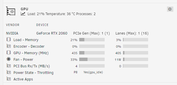

  12. No its not being used for anything, my GPU settings was working before the frigate docker update so not sure why its not working now
  13. any idea why my frigate container won't start? I'm trying to add my RTX 2060 GPU with the drivers already installed, and --runtime=nvidia set in extra paramaters with gpu id set too, I get the error docker: Error response from daemon: failed to create shim task: OCI runtime create failed: runc create failed: unable to start container process: error during container init: error running hook #1: error running hook: exit status 1, stdout: , stderr: Auto-detected mode as 'legacy' nvidia-container-cli: initialization error: open failed: /proc/sys/kernel/overflowuid: permission denied: unknown.
