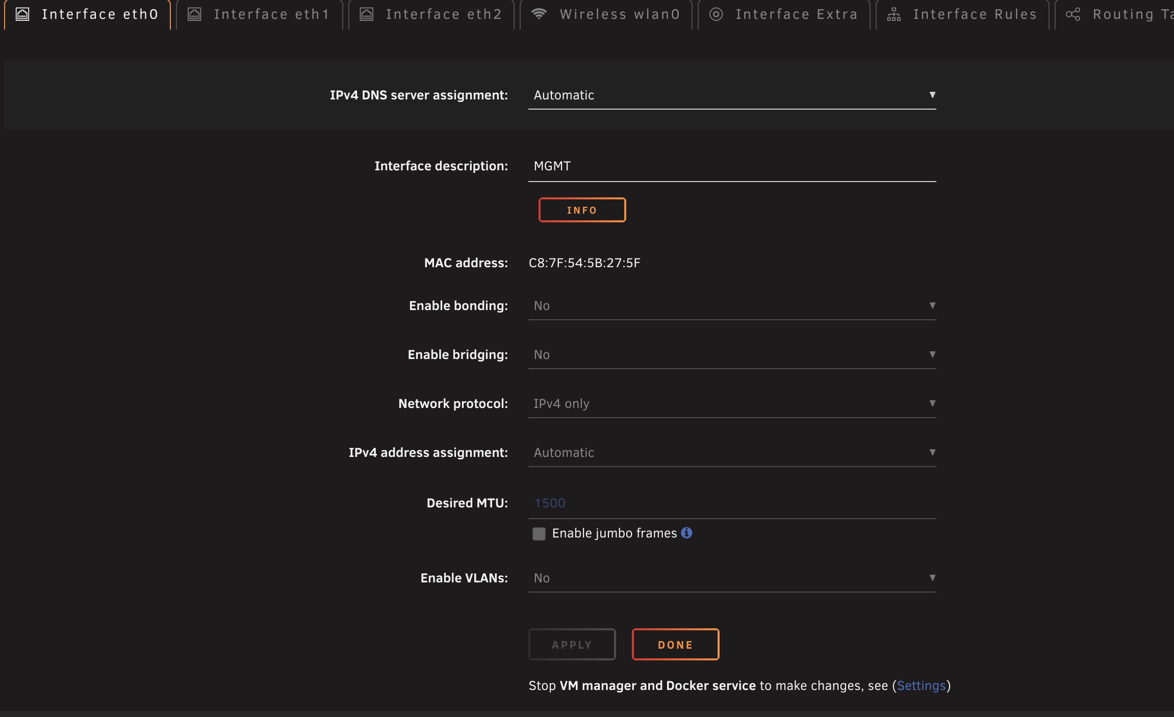

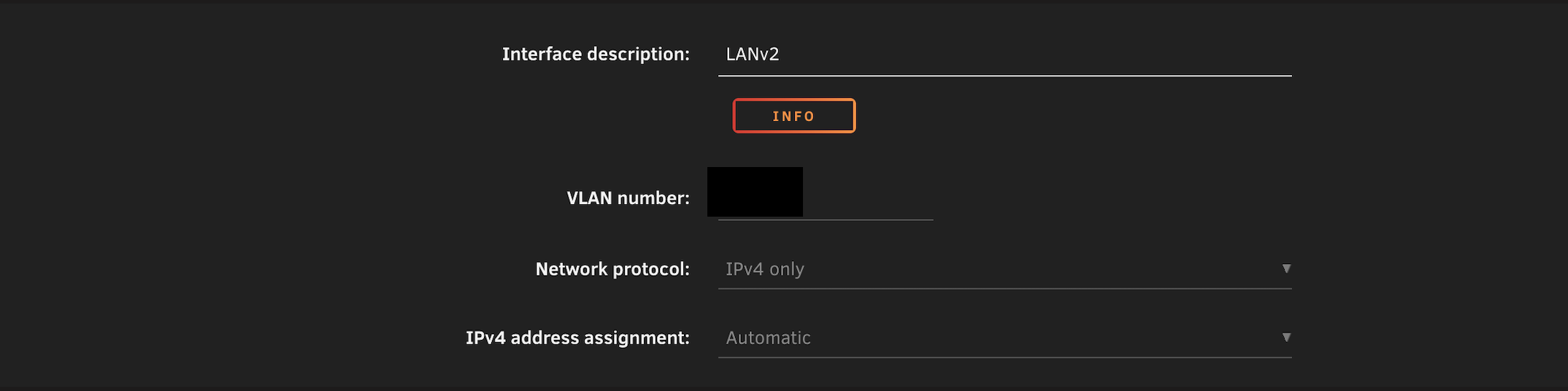

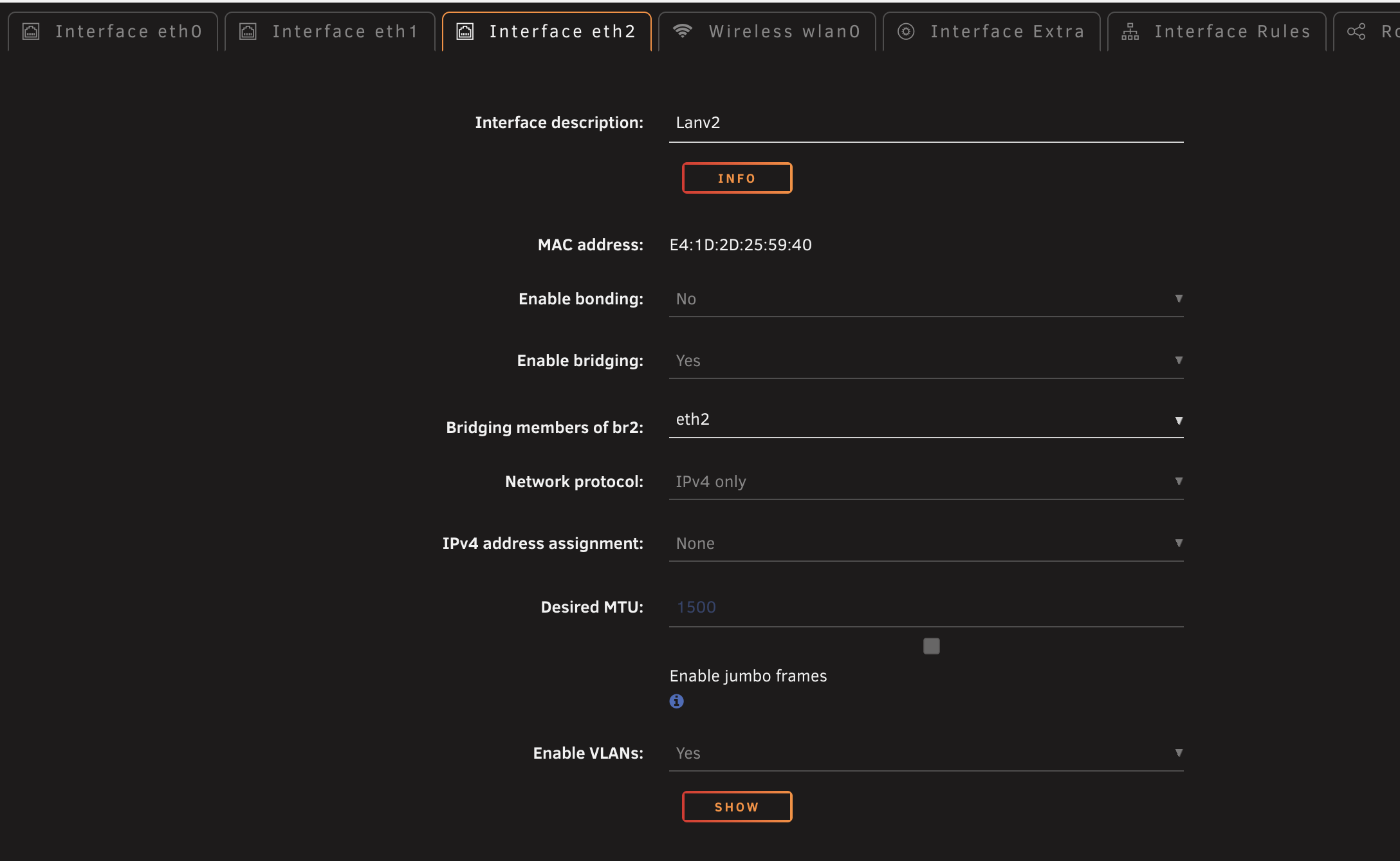

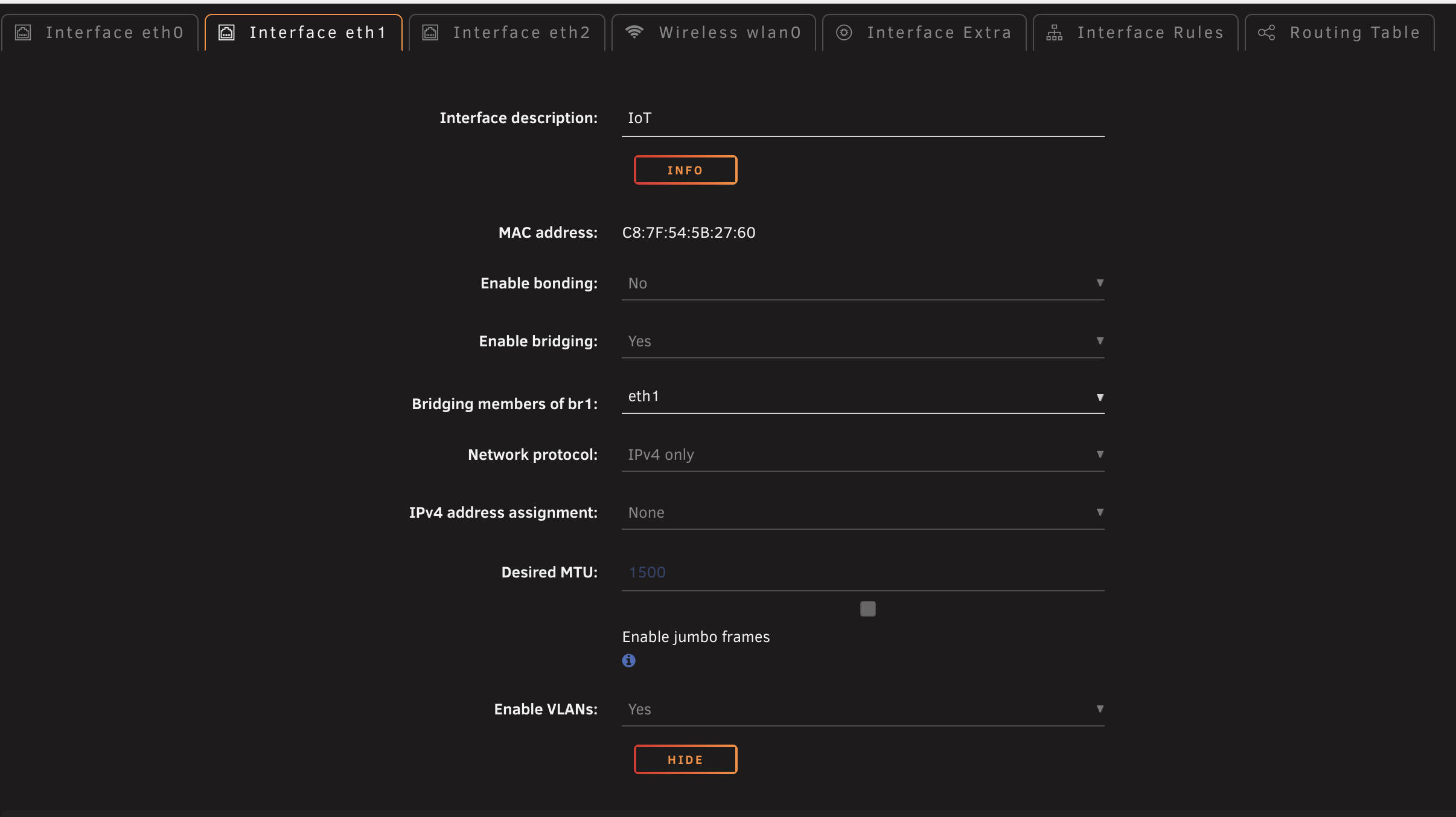

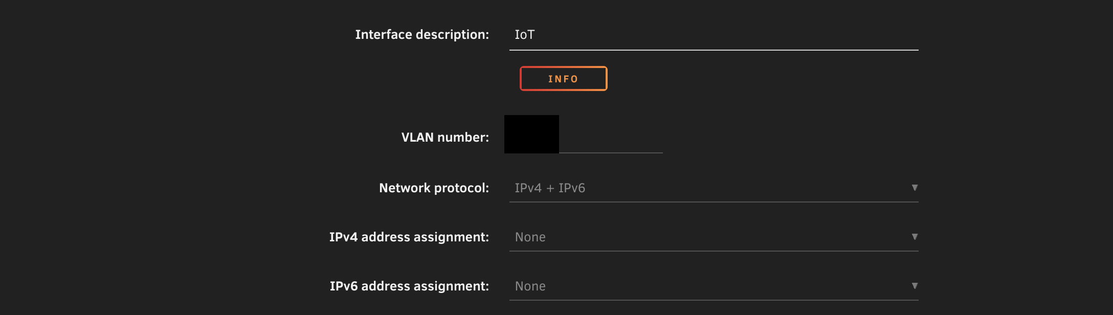

  3. @Veah thank you for your answer. Yes, eth0 is working fine. I have webgui access. The VM on eth1 uses the virtio Network Model and br1.4. It is reachable and show up on my DHCP-Server. Yes, I tried to assign IPs....the container starts but doesn't show up on my DHCP-Server and is not reachable. I attach my config for the NICs: ETH0 E ETH1: ETH2

  5. Hello Community, I want to achieve the following. My goal: NIC 1 / eth0 = WebGUI and system traffic, untagged NIC 2 / eth1 = VMs, tagged VLAN 4, subnet 192.168.4.1 NIC 3 / eth2 = Containers, tagged VLAN 8, subnet 192.168.8.1 Config: eth0: no bound, no bridge, no vlan, automatic IPv4 eth1: no bound, bridged, vlan 4, IP v4 and v6 allowed on the vlan, Assignment = None eth2: no bound, bridged, vlan 8, IP v4 allowed on the vlan, Assignment = None My VM uses br.1.4 for network, receives an IP and is reachable. I have a little struggle with docker. I tried multiple things: Scenario 1: using the br.2.8 on Docker settings using custom docker network with ipvlan and parent br.2.8 Containers doenst get a lease from my DHCP-Server and are not reachable Scenario 2: using the eth2.8 on Docker settings using custom docker network with ipvlan and parent eth2.8 Containers doenst get a lease from my DHCP-Server and are not reachable Scenario 3 RETURNING TO MY OLD CONFIG: originally my eth2.8 had an DHCP Lease via Network Settings (192.168.8.10) using the br2.8 on Docker Settings using custom docker network ("docker network create") Containers use the DHCP Leasee from above 192.168.8.10 and are reachable i can access the containers BUT my VM (HomeAssistant) can't integrate them despite being pingable the BIG problem with this configuration: unraid send their webgui response via eth2.8, some packets are blocked by OPNSense (state violation rule) and the WEbGUi is extremly slow and needs constant reloads. How do I do it right? Thank you :)
