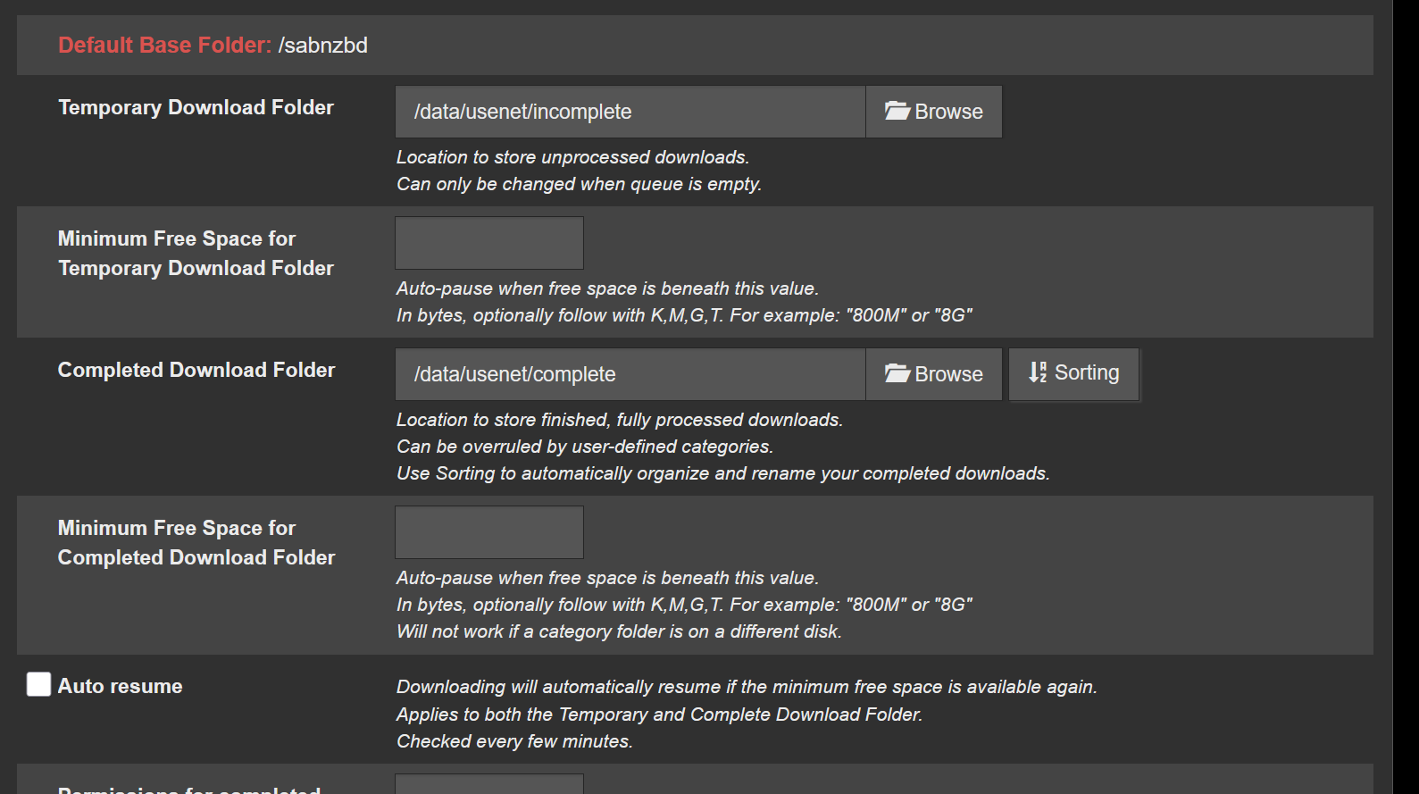

  1. So i just noticed its probably not a sabnzb issue, but an unraid issue related to the 7.2.0 update... not a single path that is passed through to any container is currently writeable inside the container... thanks for looking into it and trying to help out
  2. So i forced 99:100 on my path and even re-nuked the permissions to 777 but still get the same issues with the newest container
  3. So if i got this right ill create 2 path variables: - /mnt/user0/data/usenet/incomplete-> /mnt/incomplete - /mnt/user0/data/usenet/complete -> /mnt/downloads That might resolve my issue right? UPDATE: it did not. do i need to change ownership on the host?
  4. yes i set it up according to the trash guides.... which was working for months tho.. ill try checking the ownership of that path
  5. Hello and Grias di @ich777 , First of all thank you for your great work. I love your containers. However since upgrading to the latest 7.2.0 (and updating the containers) i ran into some weird problems with SABNZB... For some reason the container can no longer write to the dirs i have configured... before that it was working for months without issues... I even tried to nuke the permissions on that path (chmod 777) but i still cannot create files/dirs in that container... If i do that in Unraid it works without an issue... any idea what could be the culprit? When i start the container i get following error: 2025-11-01 18:13:15,901::INFO::[__init__:466] SSL version = OpenSSL 3.5.1 1 Jul 2025 2025-11-01 18:13:15,917::INFO::[notifier:166] Sending notification: Warning - /data/usenet/incomplete is not writable at all. This blocks downloads. To prevent all helpful warnings, disable Special setting 'helpful_warnings'. (type=warning, job_cat=None) 2025-11-01 18:13:15,917::WARNING::[misc:96] /data/usenet/incomplete is not writable at all. This blocks downloads. To prevent all helpful warnings, disable Special setting 'helpful_warnings'. 2025-11-01 18:13:15,927::WARNING::[misc:96] /data/usenet/complete is not writable at all. This blocks downloads.
