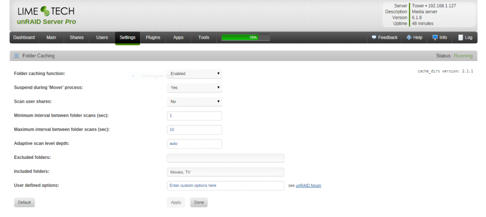

When I start my array and from what I recall from the original cache_dir plugin it would scan all my drives and it would appear to work and show reads in my Array Devices. With cache_dirs version: 2.1.1 when it runs it doesn't seem to update my Array Devices with reads and when I set it purposely to Include TV and Include Movies and I visit a Share TV it spins up 4 of my drives opposed to showing me cached folders in Windows Explorer. I'm going to enable user share scanning and see if it improves my caching. So Odd, when I open with windows and I do have thumbnails disabled it spins up drives, but when I scan with Kodi on my Mac it doesn't spin up any drives.
