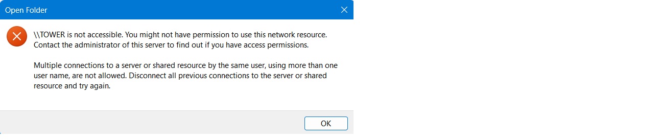

  14. Hi guys, I've been using unraid for quite some time now - I have set up a root user and password and also another user with another password. On mt desktop machine I can access the server from chrome using "http://tower" supplying my root+password, also I can access my shares when I click on the unraid root from windows explorer without being asked for my credentials. I have another computer on my local network, there I can log in from chrome just as before but trying to access my shares from windows explorer I received the message below regardless of which user/password pair I supply. What gives? Thank in advance for your help, best, tzotz
  15. Problem solved although I can't really say why. I changed permissions for "Everyone" and I could create a folder then changed it back to what it was and I could create a folder where I couldn't do it before. Why? I don't know - it works. Thanks.
